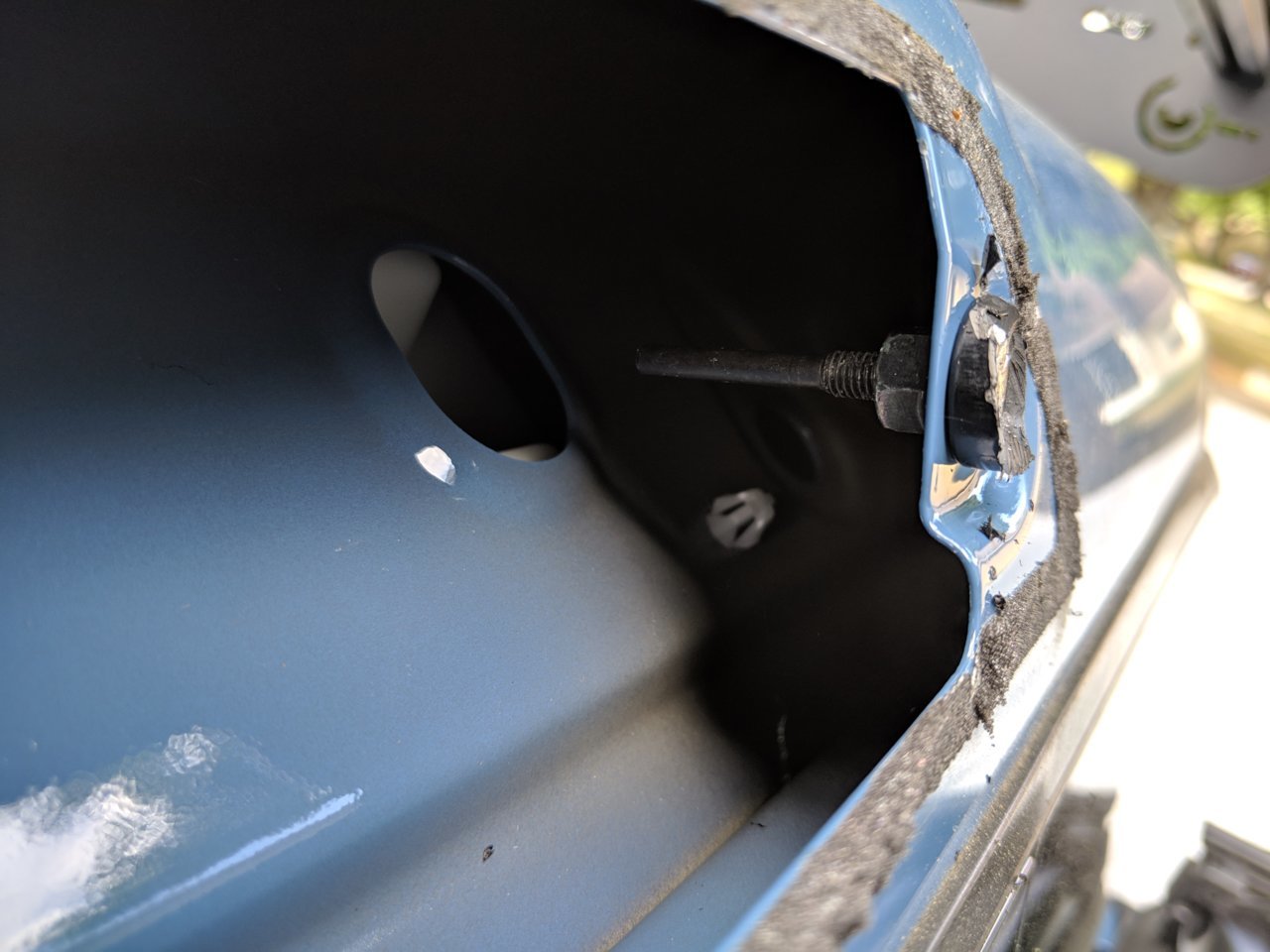

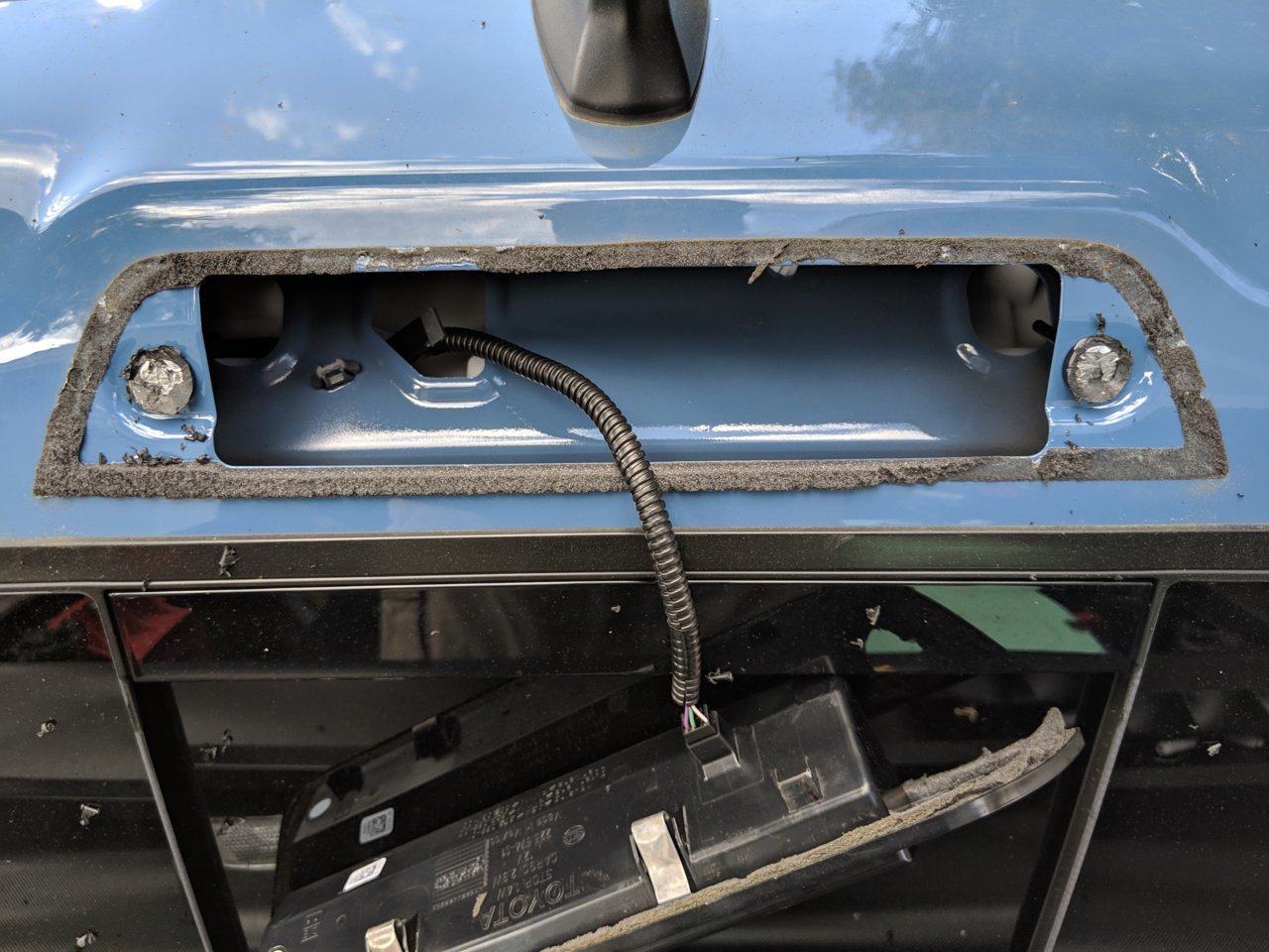

    What did you use to bolt the new housing in place (rivnut, clip-nut, etc).

    If he used what I include, it’s a threaded “fairing clip” that slips over the stock metal of the cab. It can be removed if you ever decide to go back to stock.(doubtful)

    That's what I was guna use too. Those sheet metal U-tab lookin things.

    Yup! I used the hardware you included (thank you!), and also purchased neoprene washers, additional 1/4 washers, lock washers and m6 nuts for the 3 inside lights.

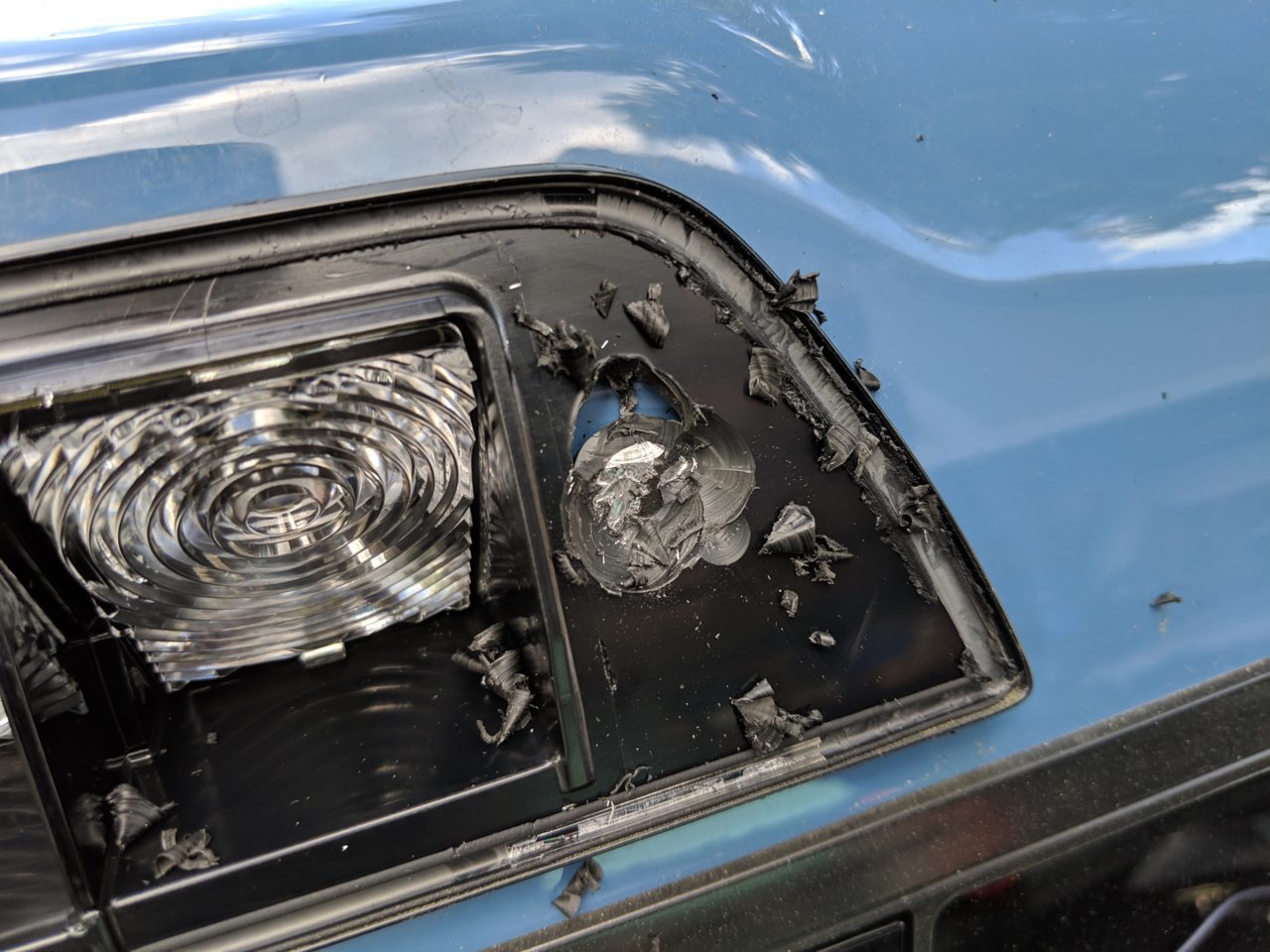

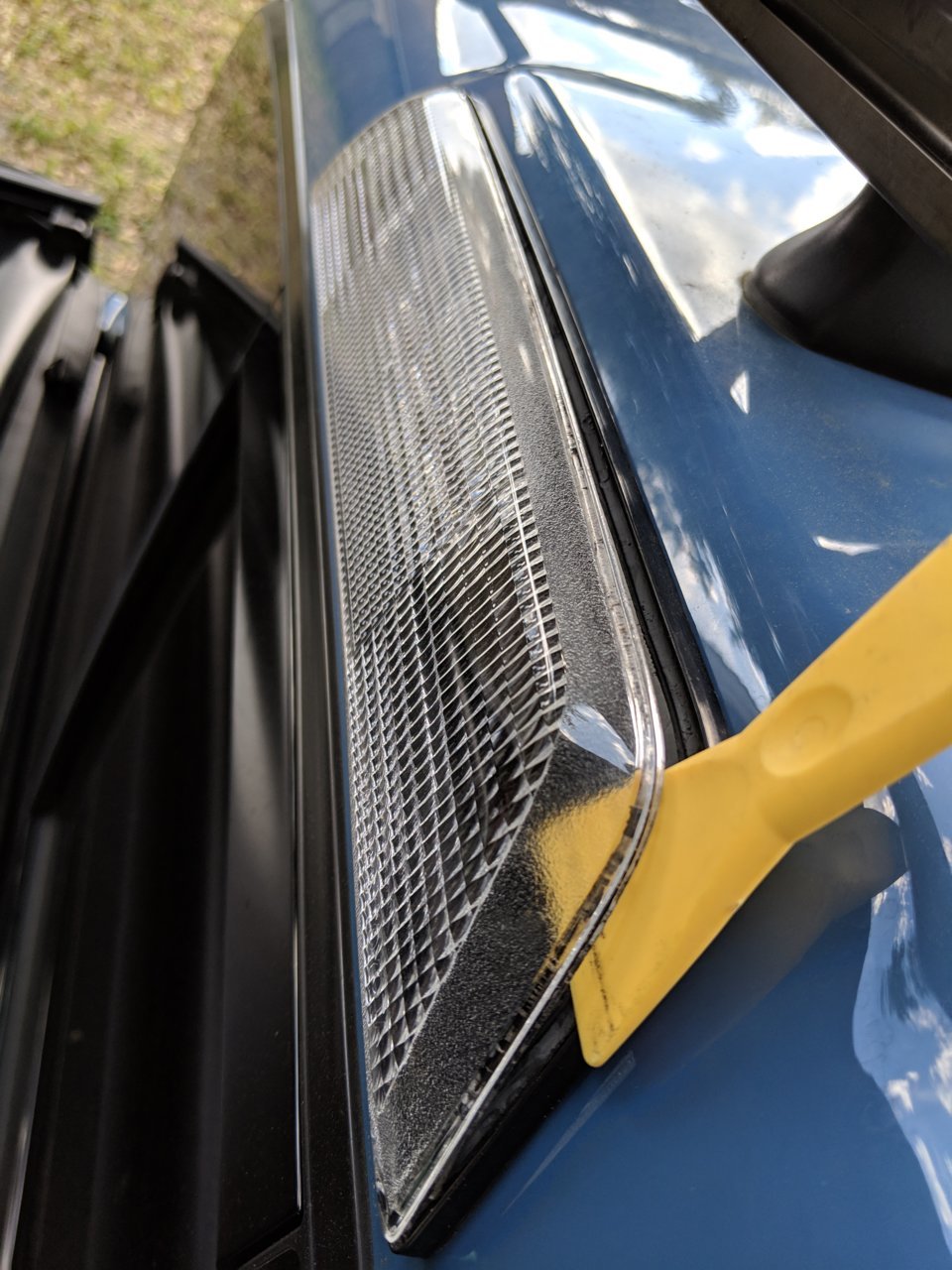

    What method did you use to remove the foam adhesive?

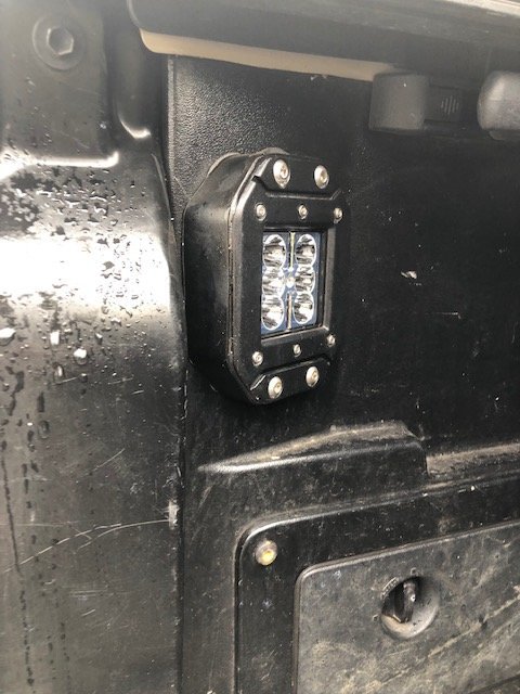

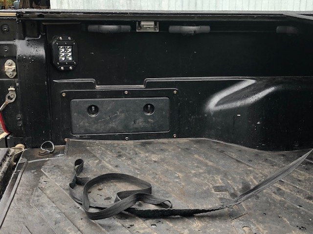

    I just finished these not to long ago.
    I just seen these and would look nice in place of the ones I have. When will these be available?

    I rubbed it up with my finger and then used GooGone to clean the residue. For me, I cleaned after with rubbing alcohol and followed up with car wash soap/water.

    Yeah pretty much the same. Scraped the foam off then took goo gone to it til it was gone.

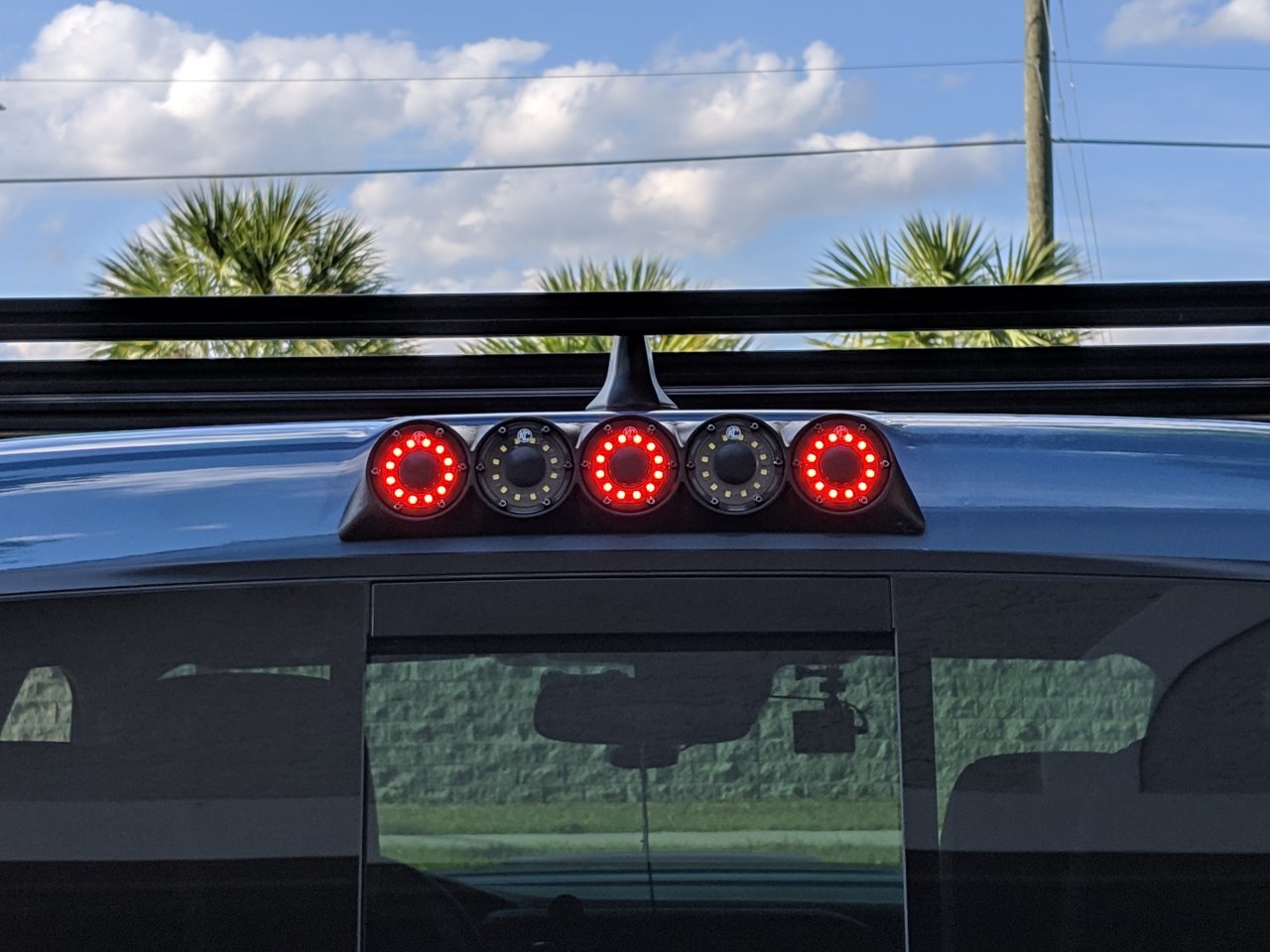

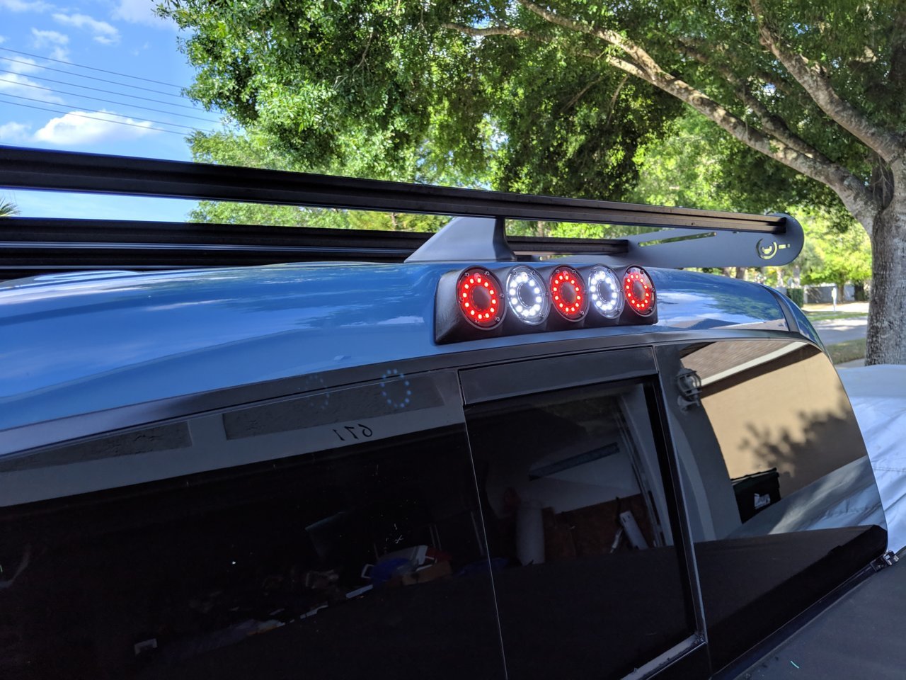

    Where did you get the center black cap covers?
  13. Mar 24, 2019 at 8:43 PM
    #1933
    06toyoboy
    06toyoboy Well-Known Member
    May 8, 2011
    #56323
    855
    Its not a cover. Its paint, i think

    Stew ships the KC housings with center caps for the cyclone lights.

    Ahh I see, thanks! That's cool Meso hooks it up and provides the center caps, it makes the lights look even more bad ass.
