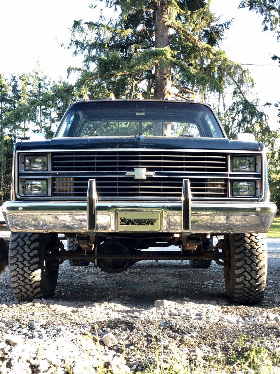

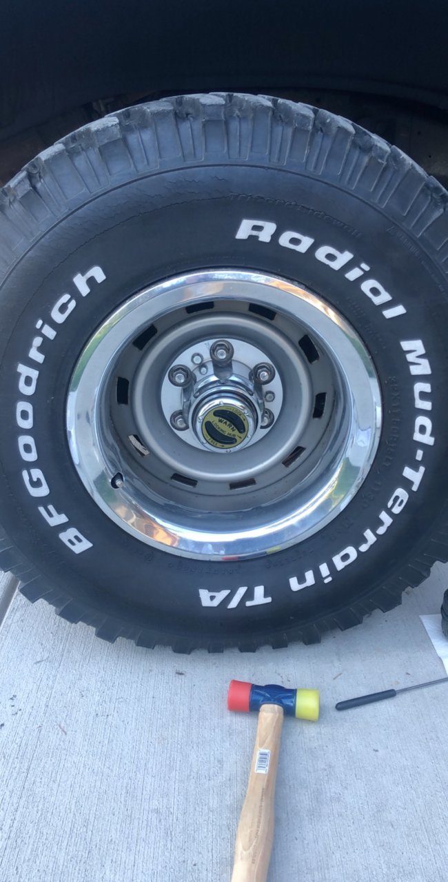

    New plates on the chev, wheel spacers in the back to widen the track width to match the front, and swapped my auto hubs for some Warn Premium manuals on my one day off this weekend.

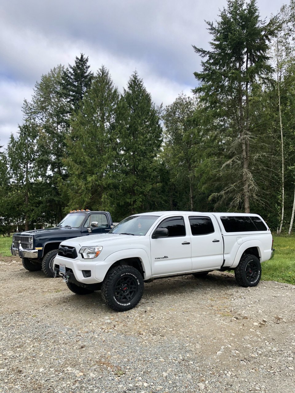

    Broke 100,000 miles coming back from camping this weekend over North Cascades Pass. Changed the oil And cleaned the air filter in it today to celebrate.
    Also got some new rubber on it a couple weeks back.

    How do those KO2's ride compared to the Falkens you had? Did you go with C or E rated?
    Looks sweet!

    I went c rated. The tires feel pretty good. They were really stiff at first but then I checked the psi and discount tire had them at 38 pounds. I lowered them to 31 and it rides like a dream. They are skinnier and taller then the falkens were in the same size.

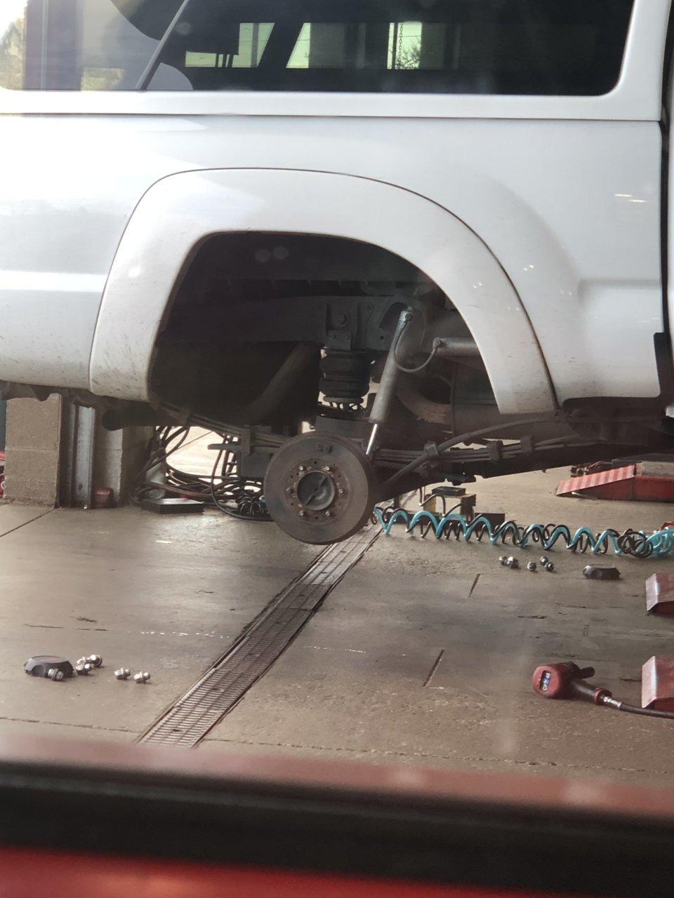

    Mileage: 111,131
    Rotated the tires
    Changed the front diff and transfer case fluid with valvoline 75w-90, rear diff with Lucas 85w-140, and drain and fill on the tranny with valvoline synthetic. Getting ready for hunting season. Also picked up a bed mat so no more broken knees crawling in and out of the canopy.
    Daystar Cradles doing their thing.
    also put a 265/70/17 duratrac spare tire up under the truck thanks to @Shadowhunter

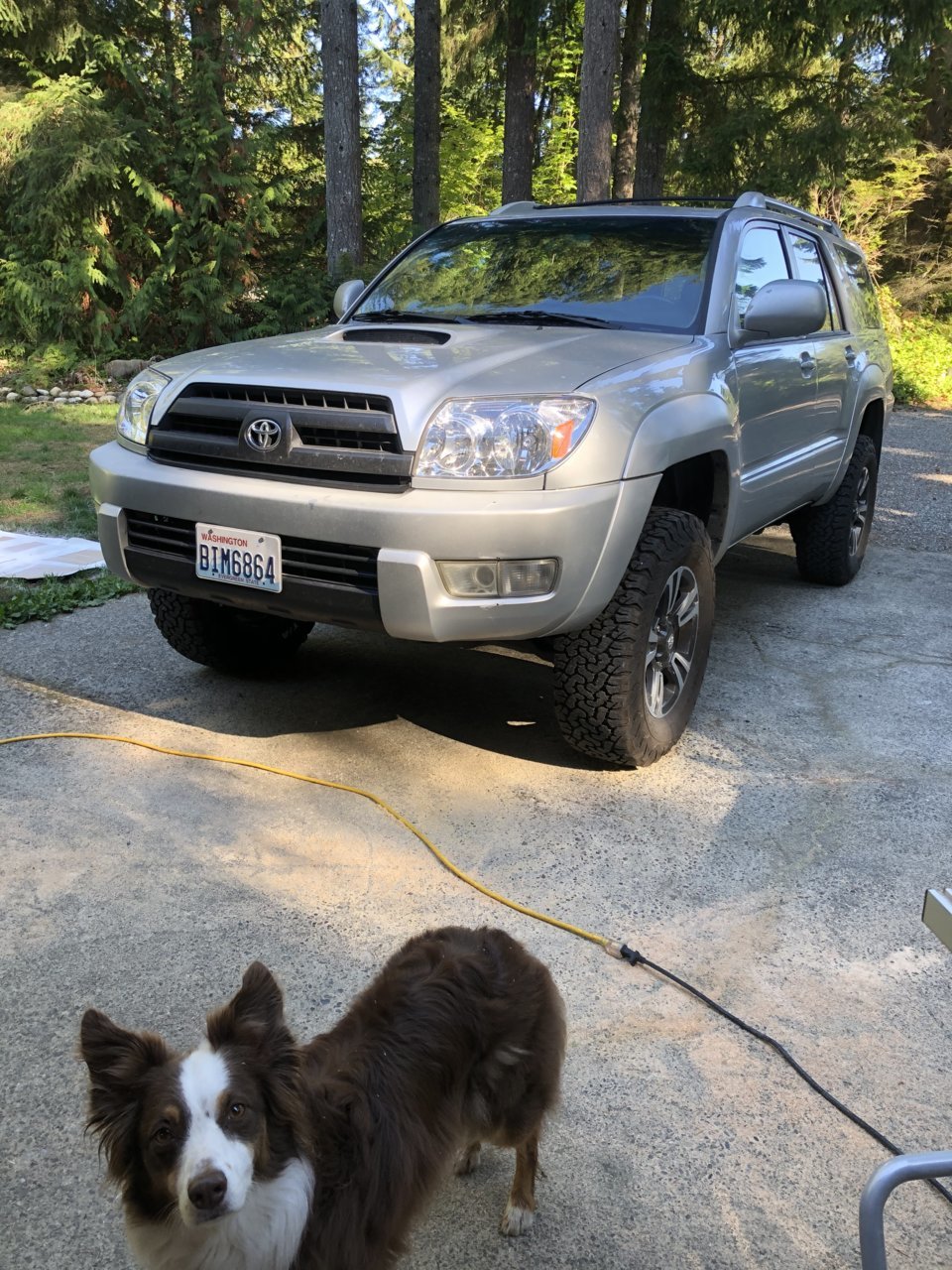

    Oil change on the wife’s rig
    186,138 with Kirkland synthetic 5w30 and a Napa gold filter. Also adjusted the headlights finally.

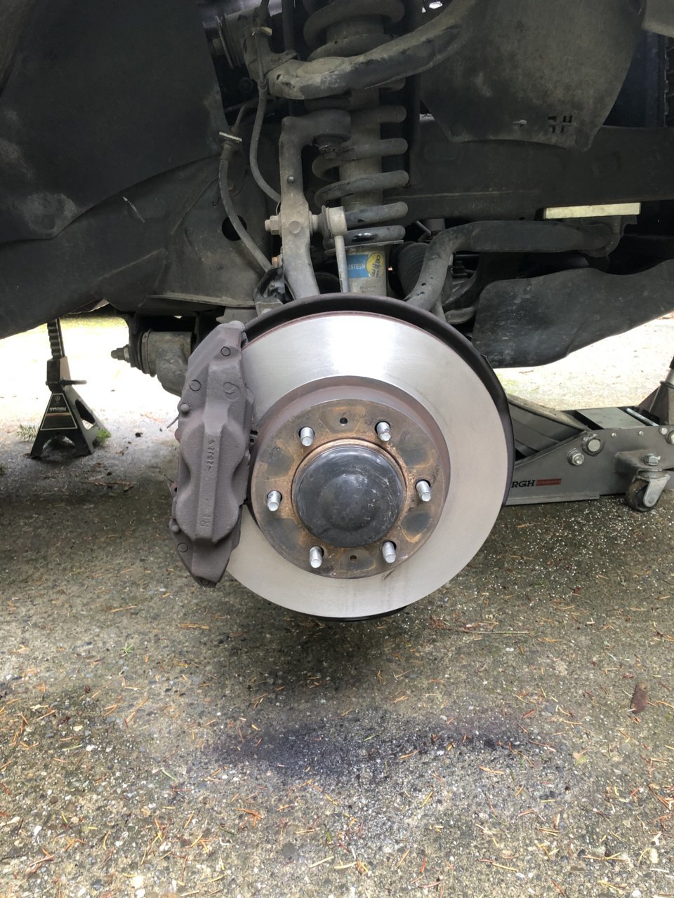

    Did a oil change and got the front rotors turned and put back on. Only got 30k out of oem rotors before they started warping. I don’t ride my brakes either. Going to grease the driveshaft also in anticipation for opening weekend!
    111,775

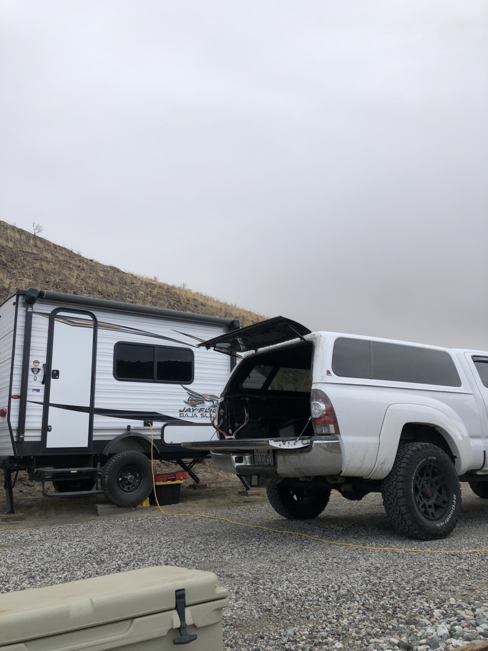

    Last camping trip of the season

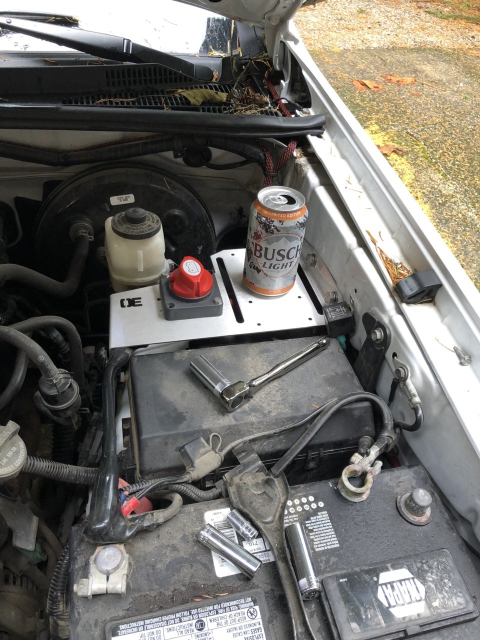

    Put in a Overland Equipped aux fuse panel plate yesterday so I could put my winch on a switch. Will be adding a aux fuse panel as well for when i start adding more accessories.
