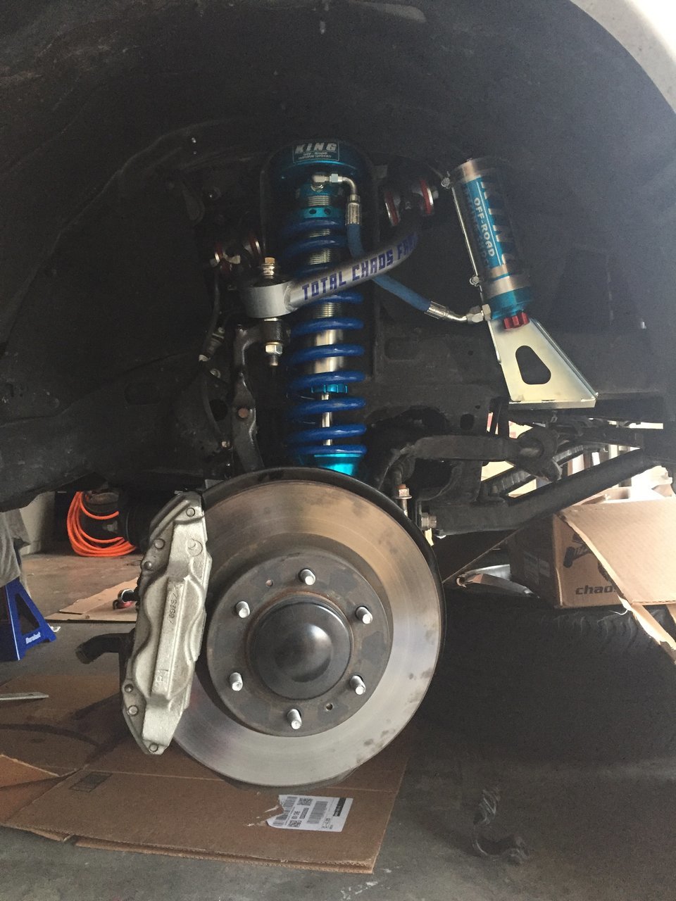

    It's possible, just keep bending that sheet metal little by little. There was a good 20 minute span while doing my passenger side UCA where I thought the bolt couldn't possibly come out without removing everything from the engine bay.

    Okay for for that get a good prybar and pull that long bolt out as far as you can and get the washer as close as you can to the metal, if you cock the washer sideways it’ll hold and put your pry bar too it and press that metal out, makes it much easier. On passenger side careful of the line and disconnect the wires and stuff or you’ll bump into it and fight those too, I have a pair of long plyrs I use to grab that long bolt and grab and use the metal that you bend to pry it’s way out. It’s not too easy and a bit of a fight but the more you pull that metal the easier it is.

    Make sure you lube those bushing and rubbers!! And GREASE THE FITTINGS before you tighten that long bolt down!!! Do not lube those while it’s tight or it F’s those bushing pretty quick. See it happen often and people don’t know why it happened.

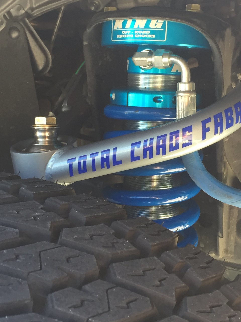

  6. Nov 15, 2017 at 3:11 PM
    #6066
    Wakecoach
    Wakecoach Kiwi in FL
    Jun 16, 2016
    #189760
    396
    Kurt
    2015 White TRD Sport 4x4 2001 Subaru Legacy Wagon Bilstein Touring Edition
    King ext, res/adj...3leaf Aal. ECGS bushing. Bullaculla relocate bracket. Pelfrey bilt skids. TC UCA. K+N, Weathertech Mats, TRD side steps, BROV Tacoma Attic, Prinsu Cabrac, TRD OR Tow Hook
    Not as far as I would have liked to have got today. But the pivot bolt on the passengers side is a total PITA ..
    Passengers side finished...
    Drivers side disassembled ready for ECGS bushing , UCA and coil over tomorrow.
    Thanks again for the advice team!!

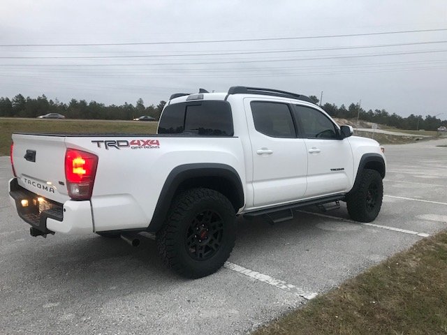

  10. Nov 18, 2017 at 7:29 AM
    #6070
    Wakecoach
    Jun 16, 2016
    #189760
    396
    Kurt

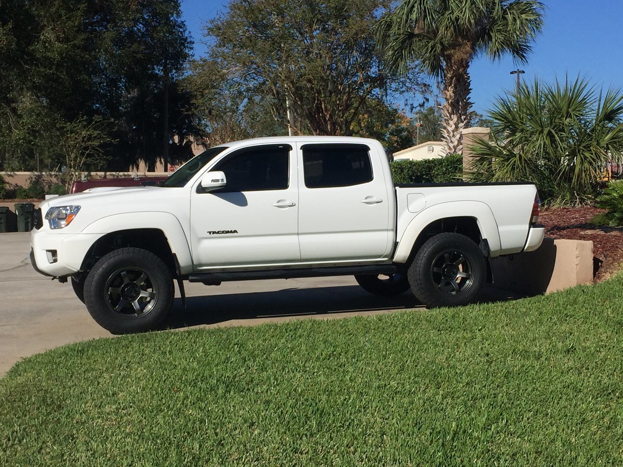

    IMG_5064.jpg Fun week with the truck.
    Coil overs and rear shocks
    3 leaf progressive AAL
    UCA
    ECGS bushing
    Bullaculla trailer plug relocation bracket
    Diff Breather mod
    Aluminum slid and Mid Skid (still to go on. Just waiting to make sure no leaks from ECGS swap)
    Diffs and tranfercase oil change.
    FN Wheels and Nittos
    Thanks for all The advice and write ups. You have helped me spend way more that I could Have thought haha.

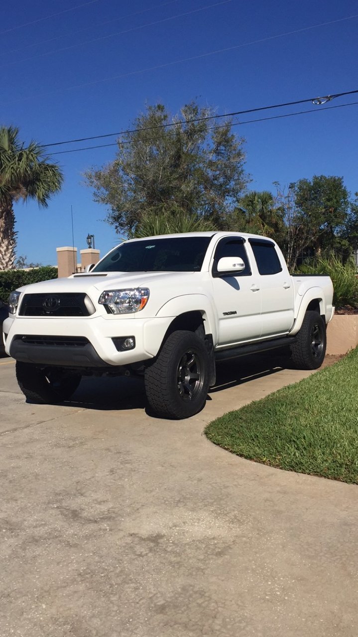

  17. Nov 18, 2017 at 7:09 PM
    #6077
    TegoTaco
    TegoTaco Well-Known Member
    Sep 29, 2016
    #198555
    7,264
    Ontario, Canada
    ‘13 SUPERCHARGED DCLB TRD SPORT
    And a before and after, just amazing to see how far it’s come along in just over a year.

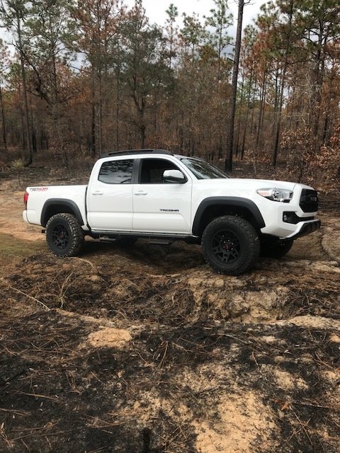

  18. Nov 18, 2017 at 8:11 PM
    #6078
    savetheclutch
    savetheclutch Member
    Nov 16, 2017
    #236134
    10
    Andres
    2013 White Tacoma TRD
    new here, my 2013 TRD today in the Pine Barrens NJ
