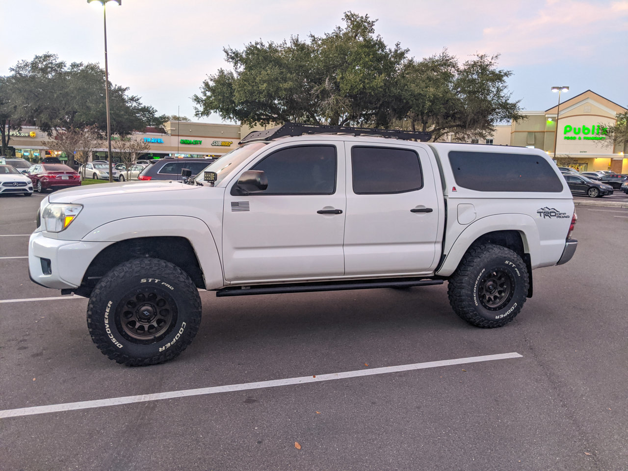

    Thanks! These are 16x8 285/75s
    Just had my CMC done about a month ago as well as some fender chopping and so far no rubbing that I've found yet. 315s will look really nice!

    Thanks man. They are SCS Ray 10's in 17x8.5 and the tires are 37x12.50 STT Pros.
    Tacoben[QUOTED] likes this.

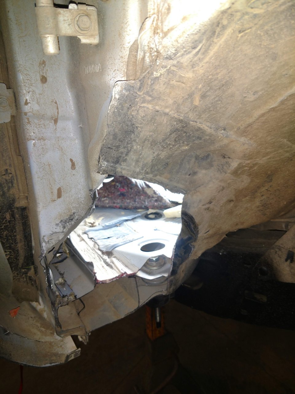

    It depends on how much work you are willing to do. I did a cab mount relocation, trimmed fenders and flares and had to tub the firewall and part of the inner fender. Also re geared to 4.88.

    The the front had to be tubbed, the rear clears everything with just the fenders trimmed. I'm not sure on how much lift I ended up with, but it's not more than 3".

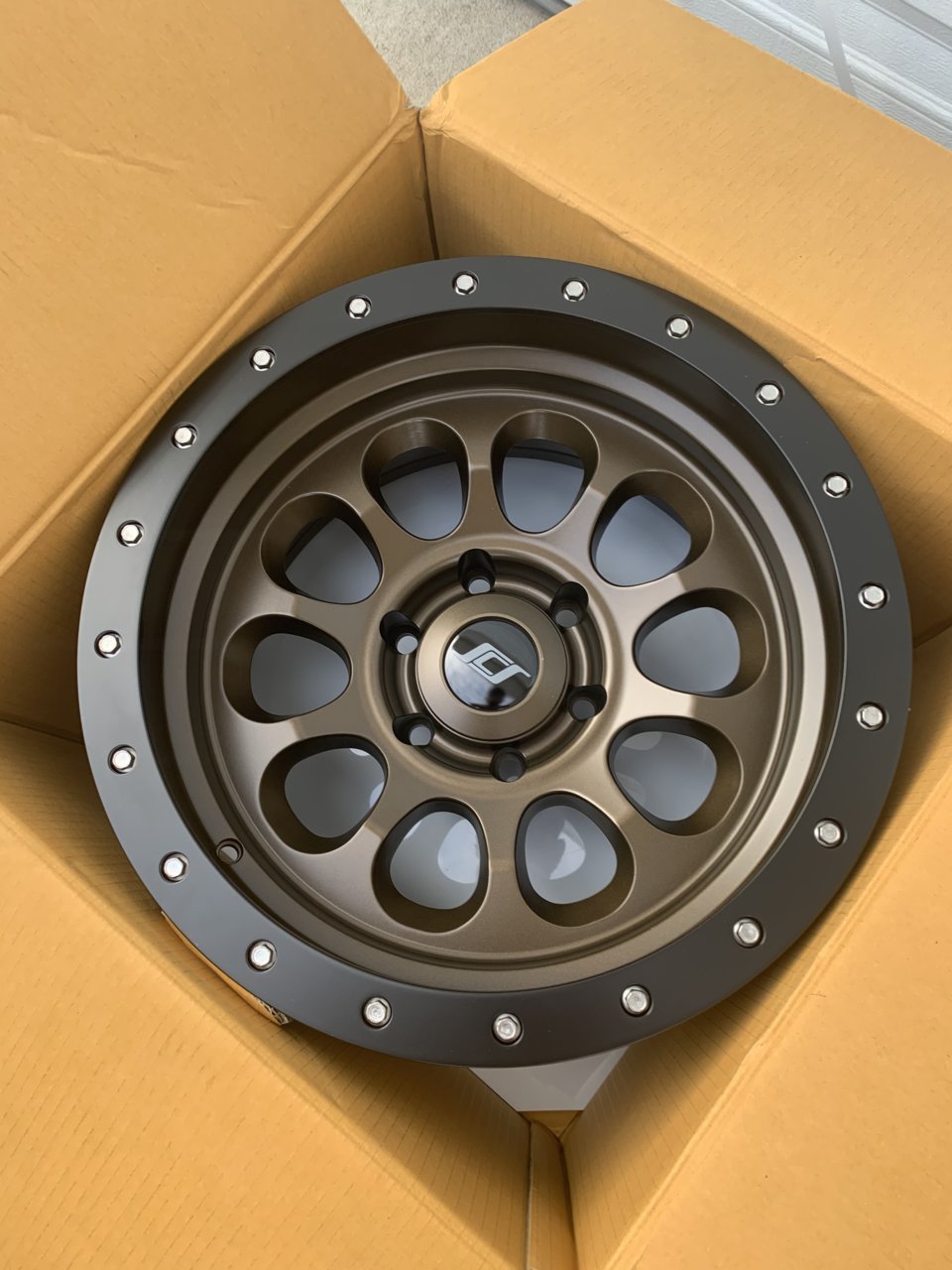

    Just got this bad boys from SCS Performance Ray 10 matte dark bronze 17x9 -38 offset UPS screwed up one of my rims but SCS got my back very very helpful and quick response
    cant ask for more :cheers::muscleflexing:
