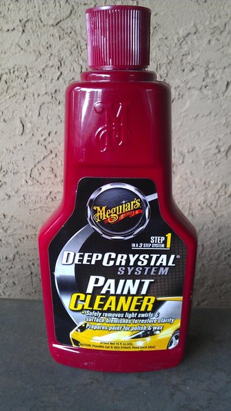

    I used this to remove the outlines from the lettering after I debadged. It won't harm your clear coat, but you will have to wax the area after using it.

    No clear coat on the Superwhite.

    There is clear coat.
    It just isn't a 2 stage paint job.

    That just simply isn't true. Its not even an urban myth and, as near as I can tell, its mostly a Tacomaworld myth. Its been many decades since I painted cars for a living but everything I read says that things have not changed. "Single stage" paint does not separate after spraying into separate layers, or strata, forming a clear top layer or coat. Single stage pwint simply contains additives that create gloss without having to spray an unpigmented topcoat to achieve a good finish. The gloss is integral within the entire finish coat. Back in the day we didn't call it single stage. It was just enamel or urethane (which were fairly new at the time) that didn't require a clear to achieve a high gloss.
