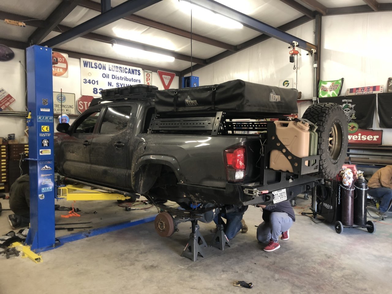

    Ambitious day yesterday. My list of parts to install is far to large and it was time to try and knock out a huge list. I shot for the moon knowing it was a massive list to get done but hey why not try. The list included front Kings ECGS bushing, Gusseted spindles/wheel bearings, stainles brake lines all around, Dakara AAL's, Archive garage shackle hangers and a rear 12" shock relocate. We attacked the list and did really well. We got the entire front done and most of the back. All thats left to finish is he extended brake lines and shock relocate, we'll get that done sometime in the next few weeks. I have to thank everyone that helped get so much accomplished yesterday. I didnt take many pics but heres a some(some are stolen from others that helped)

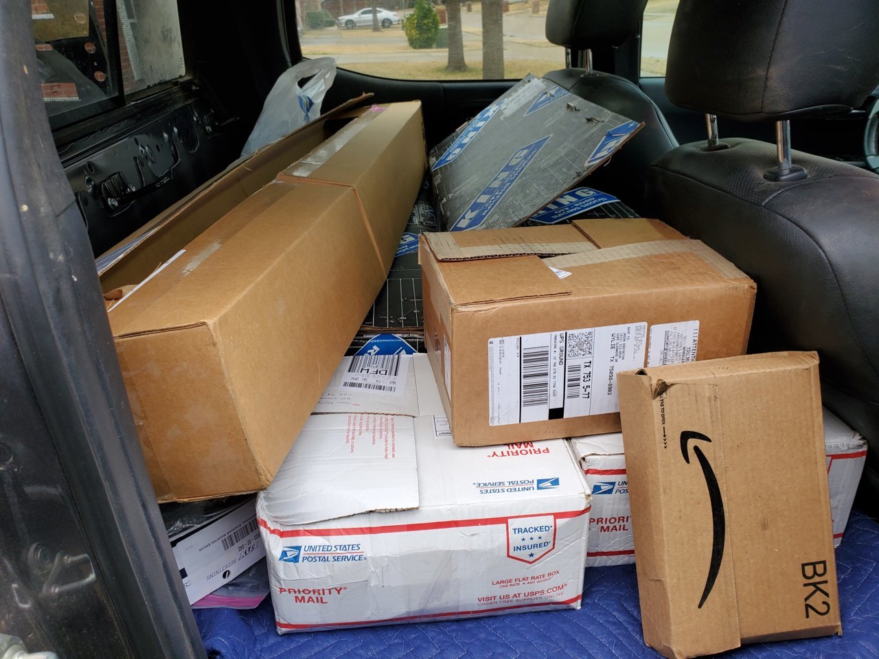

    Truck loaded up the night before ready to go!

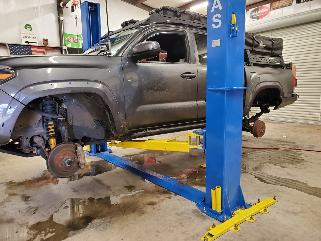

    Up on the lift ready for its shiny new parts
    Rear going back together with the new shackles and the AAL installed.
    We were lucky to have @Bigdaddy4760's generosity in opening his shop to us and feeding us some amazing BBQ! We all had full bellies and were likely fighting with a meat coma.
    Shackles and the AAL installed!
    Shiny new front Kings installed! I need to crank them some because my back gained more height than I was expecting. I'm guessing I'm going to need to add 1/2" or more preload because the backs sitting so high. The rear leafs had been really flat. Also threw in a new napa CV since my stock driver side one would make pop sounds every now and then, new to me gusseted spindles and new wheel bearings(I figured why not since I was going to have to swap them over and now I have 2 used spares with 65k on them) that I have no pictures of.
