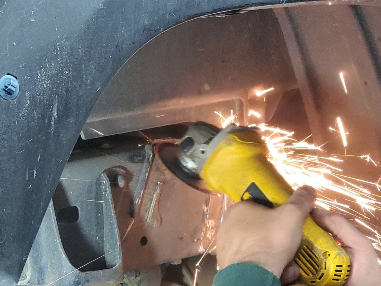

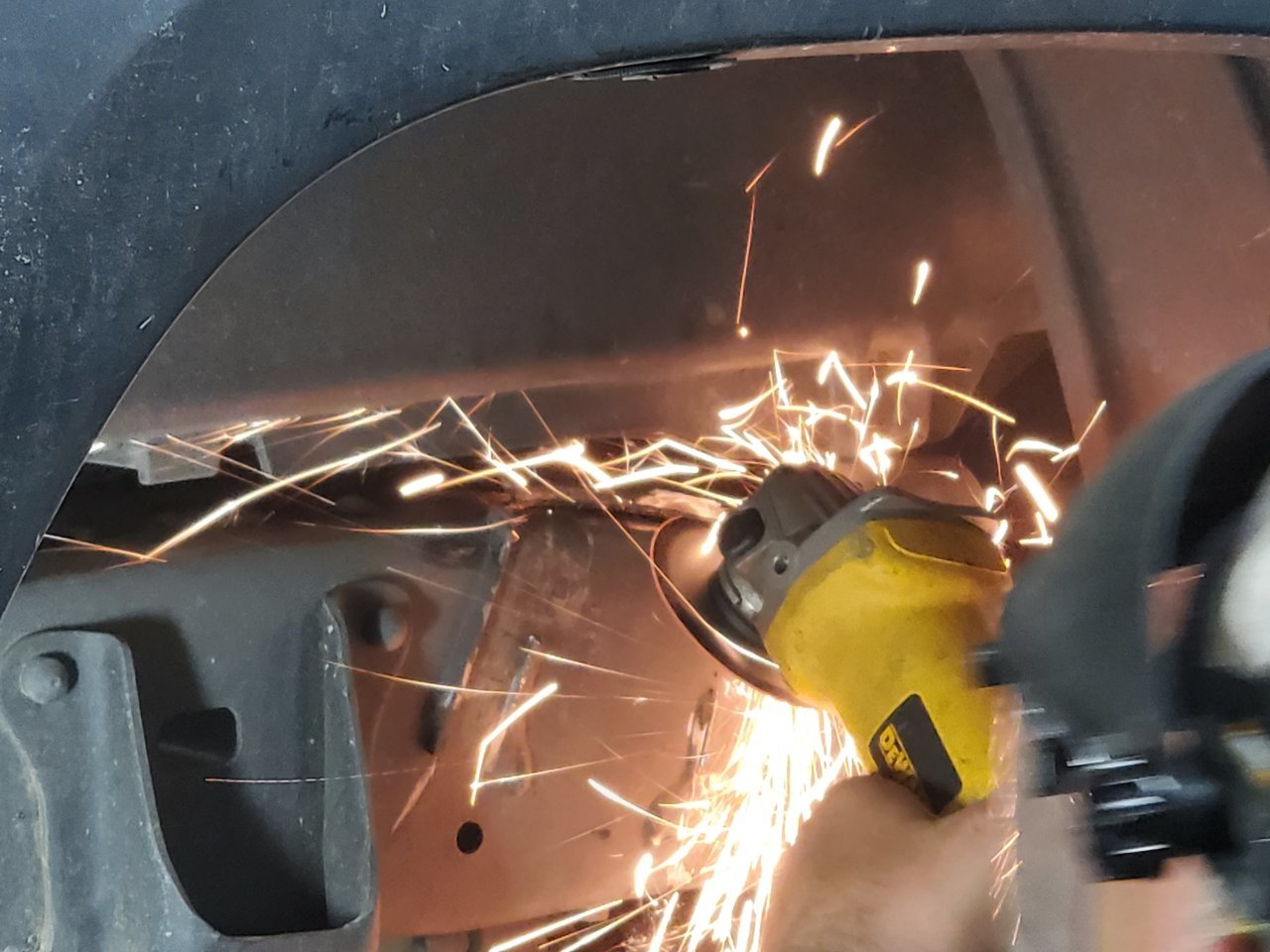

    Yes sir and going great. Top shock towers are tacked on and removed the lowers. Just polishing off old welds and will tack them on.

    Yup @Bigdaddy4760 is showing me how to remove metal, I'am apparently slow. I spend an hour working on cleaning it up and he spends 5 minutes and does twice as much and finishes it.:rofl::rofl::rofl: Hes finishing up the welding now, then paint and finish it up.

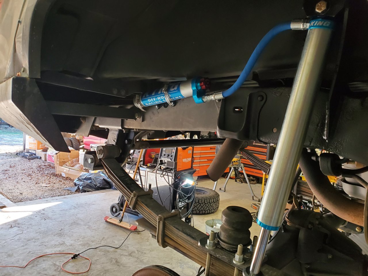

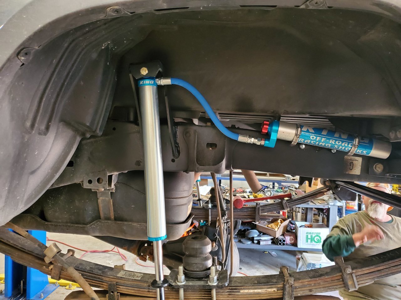

    After a great day out at @Bigdaddy4760's shop the rear shock relocate and Archive crossbar is installed and done! Still a few more things to finish up before the suspension rebuild is complete but its getting close. Ext stainless rear brake lines and front stainless brake lines need to get installed and I need to add a bunch of preload to the front shocks. I know the box said they were 700lb springs but the front end is pretty bouncy with it sitting lower than my old OME nitrochargers with 886's. Hopefully some preload to get my front height back with a little more will stiffen them up to what I was expecting with a heavier spring.
    Huge shout out and thanks to @Bigdaddy4760 for the help with getting it done. It was a great day!
