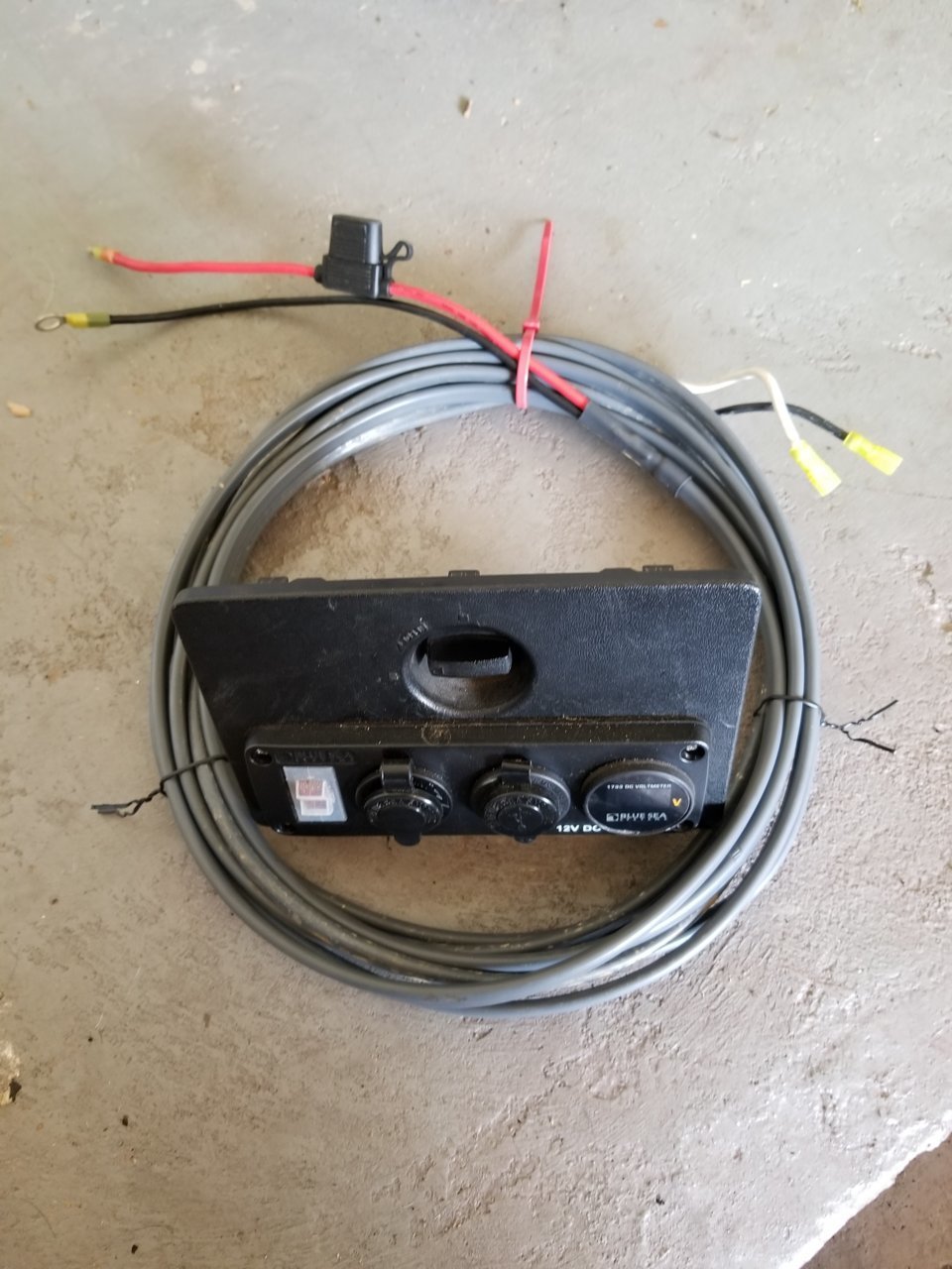

    Picked this up today. Aux bed power for the additional charging and when I eventually get a fridge for back there.

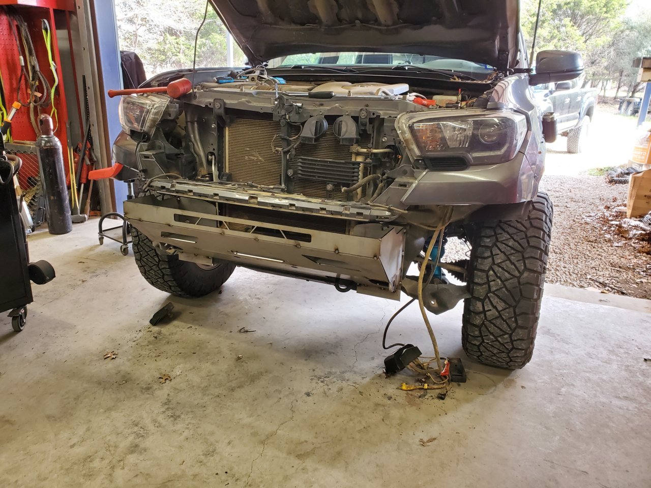

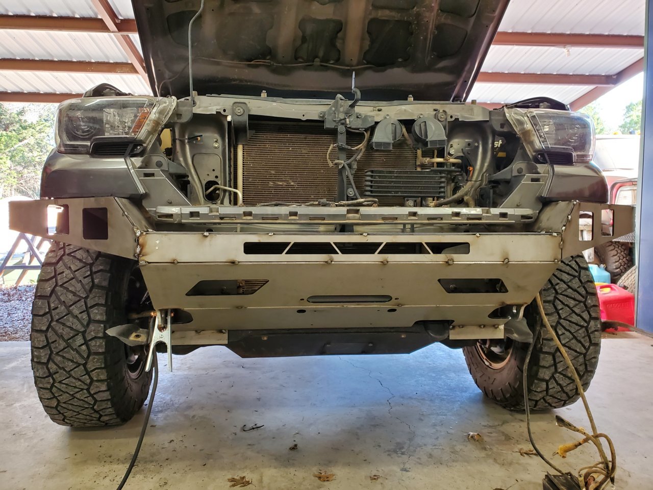

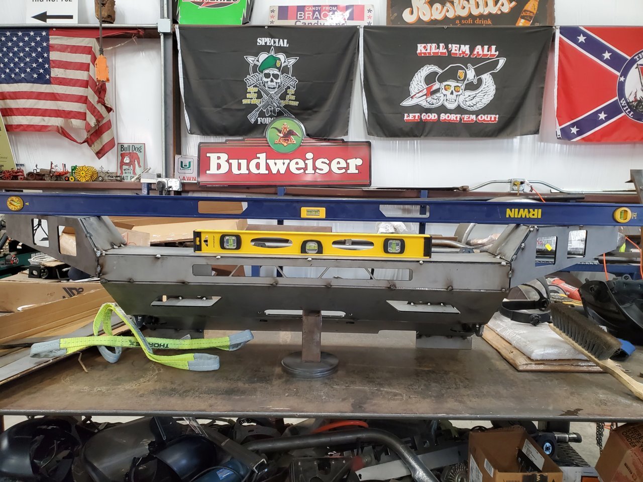

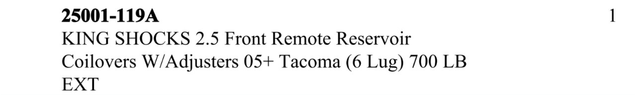

    Well truck got cut up some more as we started the new Coastal Offroad bumper build yesterday! Still have to finish tacking on the side wings and hoop. Then Fully weld it all up, clean up all the welding with the grinder and finishing discs and then take it for prep and powder coat. Already setup time to work on it Thurs, Fri and can also work on it some Sat, hopefully that will be enough time to finish it up! Lovin the look even with it only put partially together.:yay: Also huge thanks to Maner @Bigdaddy4760 for the help in putting this bumper together!
    Truck looks a little interesting until I get the new bumper installed.

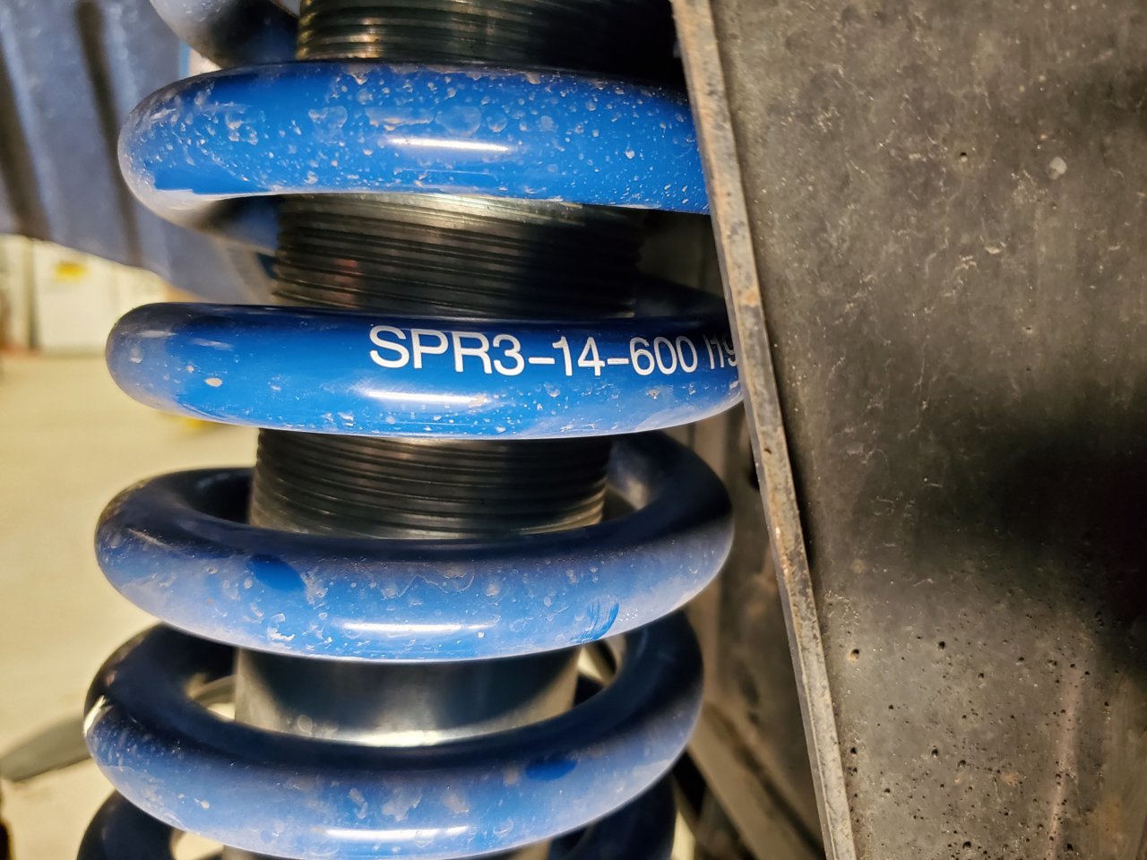

    Also finally found out why my new front kings are so bouncy... Been trying to figure out how the 700lb spring setup I ordered bounced more than my last OME 886's which were only ~650lb springs.
    Clip from my order sheet showing I did indeed order 700lb springs.
    Pic of the text on the springs installed.
    The tag attached on each coilover said 700lb but the springs dont say the 700 on them... Seems a mistake was made somewhere assuming that text on the spring means they are a 600lb spring rate. I never thought to check the actual spring during install since the tag was correct for my order. First time I looked at the springs on the truck I didnt see the info printed on them.:annoyed: Emailed the company that I ordered through today so we'll see what they say and will do about the labeling mistake.
