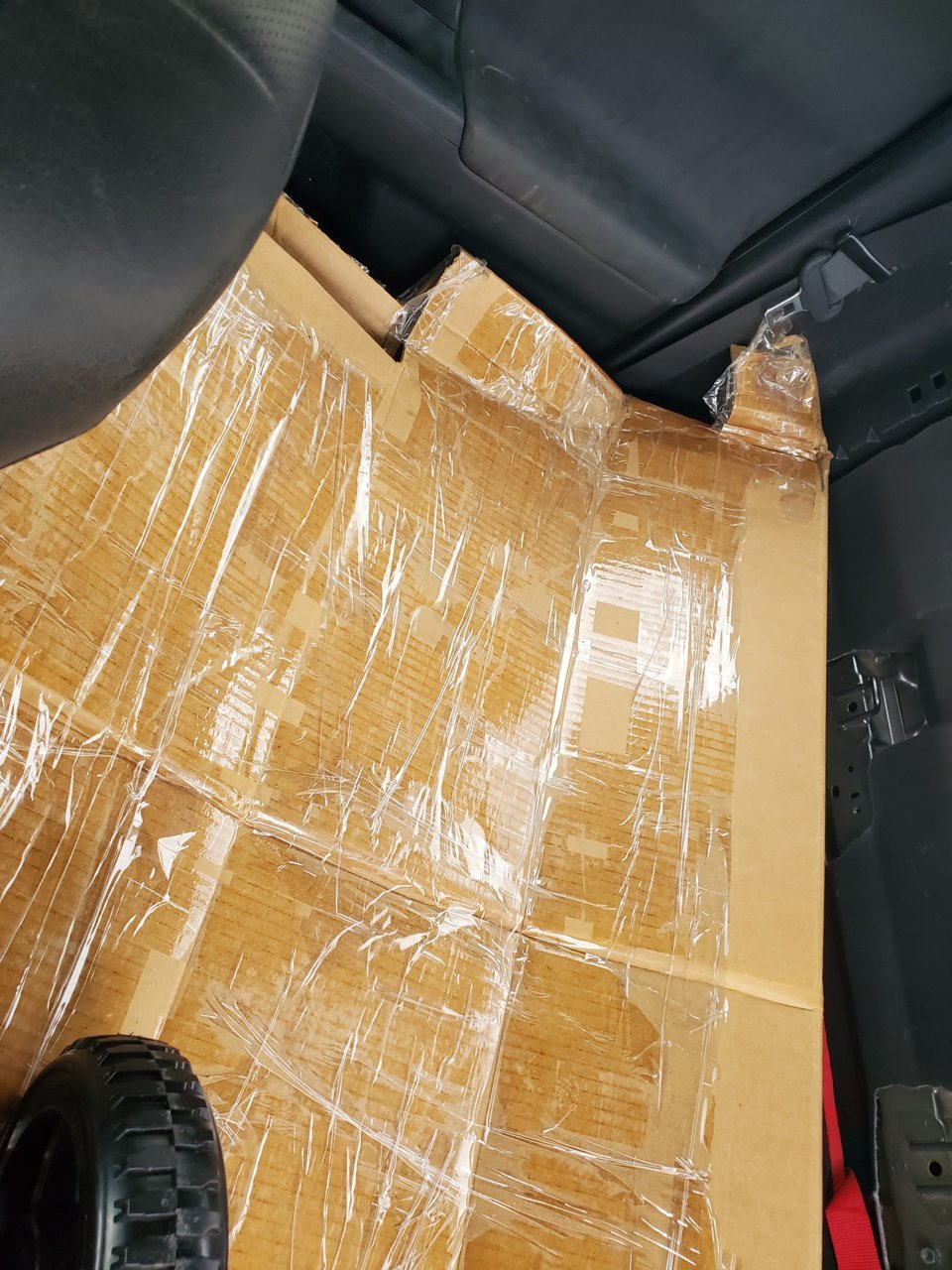

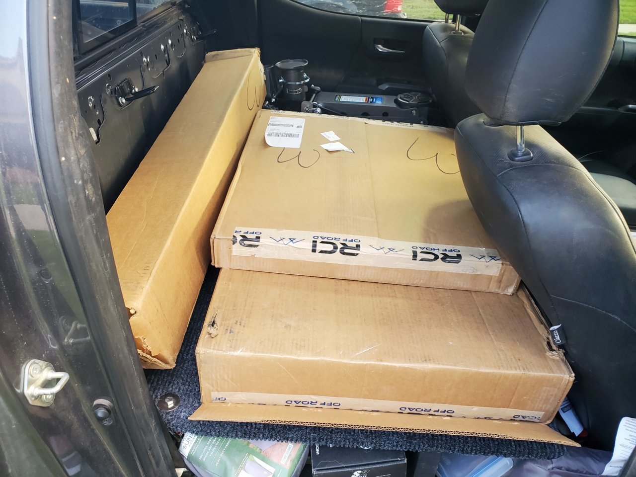

    Tired to get some work done on the bumper today. Ended up barely touching it and have no new picks of the progress. I did drop off some things that I have picked up for other members! My part is done and the owners will all have their parts soon enough.:D

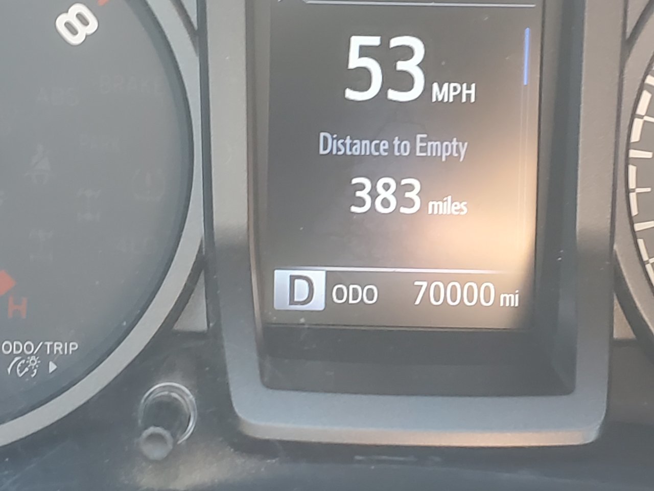

    I hit 70k on my truck today! Sometimes I think I drive too much, its not even 4 yrs old yet.
    Yesterday I finally installed the Hypertech Speedometer Calibrator that I picked up last year but never tested it or programmed it to my tire size. While I was on my way out to work on the bumper I noticed my speedometer was now showing faster than I was actually going by 8 or so mph. I took the time to program it while I was out and now have its only showing perfect or 1-2mph over what I'm actually doing.:woot: Pretty good but I may try and get it right on sometime. I left the USB plugged in and ran it near the center console area so I can plug in and make changes anytime I need.

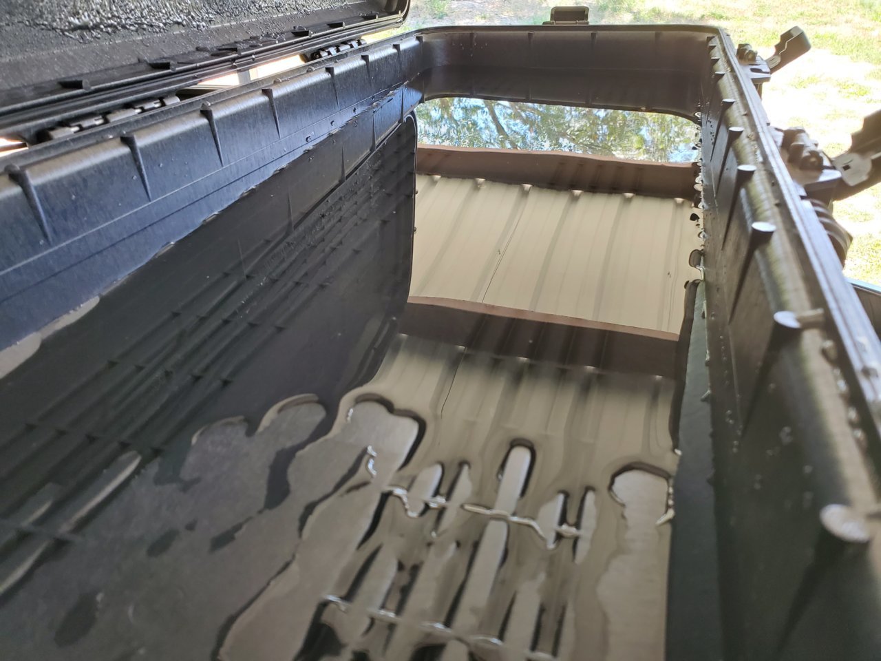

    So I hadnt driven my truck in a week or so and noticed every time I came to a stop water was going down my windshield. There was only one thing that could cause that to go on for so long so I checked my plano cases. Both of them had a few gallons of water inside.:eek: I dont even understand how, with my truck was parked for 1-2 weeks, that much water got into the cases. I've known they leaked but this is way more than a leak. They were both closed and latched properly so I'm stumped.
    Feeling like I need to find a better solution for storage on the roof rack. I do really like having the extra storage but I need something that will stay dry so my stuff doesnt get soaked or ruined. I wonder if dropping the money on pelican cases would solve my issue.:notsure: Maybe I can find something thats cheaper and work well.

    Did you skip your 69,420 pic?

    Yeah, I missed that one. Barely caught the 70k, mainly because I need an oil change.

    My cases leaked like hell, that’s why I ditched them for the decked system.

    One of mine leaked and I emailed Plano about it. About 6 months later they mailed me a new gasket and that did the trick.

    I've kinda wanted a decked since before they released for our trucks. I'm running into space issues unless I replace my bedrack. The racks too short for a cooler/fridge on top of the decked. I actually almost bought one last week but someone else beat me to the deal.
    Hmm, maybe I'll try that. 1 of the 2 has leaked since I got them.

    Just to add some clarity on our system so all expectations are clear. Our drawers are not 100% waterproof as they are not fully air tight. Any rain, snow, dirt, etc. coming from above should never get into your drawers, but it is not impervious to moisture and fine dust. There is a small gap between the underside of the DECKED and the drawers which allow for a smooth drawer but also have potential for fine dust or moisture to get in.
    That being said... you really should never have any 'leaking" issues that you have outlined above

    Thanks for the info. I never thought about how water/dust proof the system was. As I think about it everyone I know that has them installed has some sort of topper so water never gets to them. Dust isnt too big of a deal to me and it still looks like it would do better at keeping stuff dry than the cases on my roof currently are.

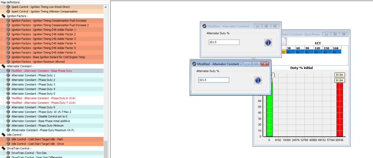

    Saving this info for later for the VF Tune alternator voltage increase for AGM batteries. I'll lose it in the VF tune thread.:rofl:
