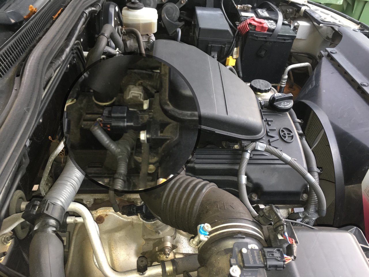

    What's this sensor, located back of resonator?

    It's the Vacuum Switching Valve (VSV), my bad

    Sooooo where should the VSV be placed, intake or output of SC?

    #16
    MrCrowntown
    MrCrowntown Well-Known Member
    Aug 7, 2016
    #193980
    2,350
    Alyn
    Ky
    06 Extended cab Prerunner 2.7
    Dirt King Mid travel with King 2.5 coilovers, Baja Kits chase SUA with 14in fox smoothies under custom hangars.
    If its a vacuum switch, you are going to want it on the vacuum side aka your intake for the charger.
    Torspd likes this.
