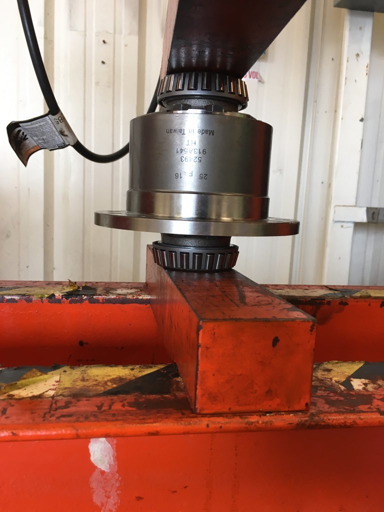

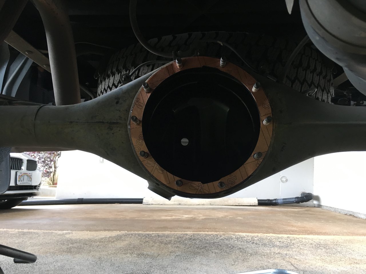

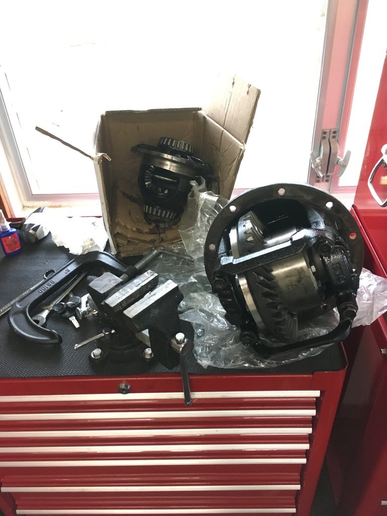

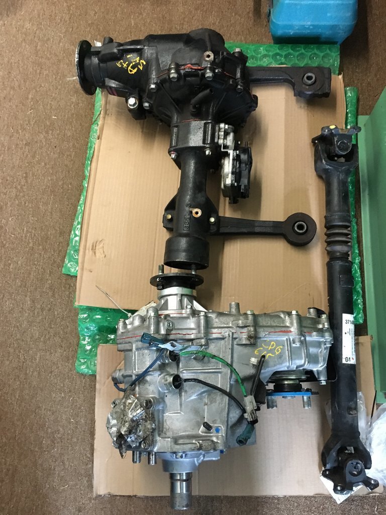

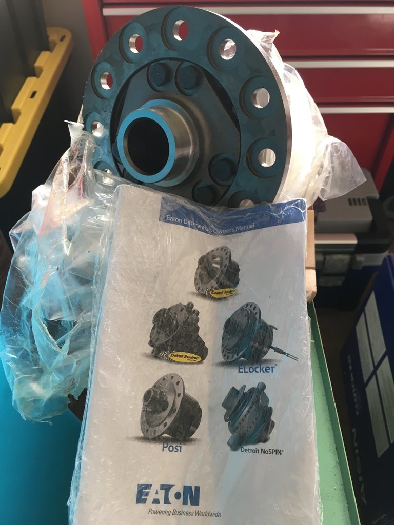

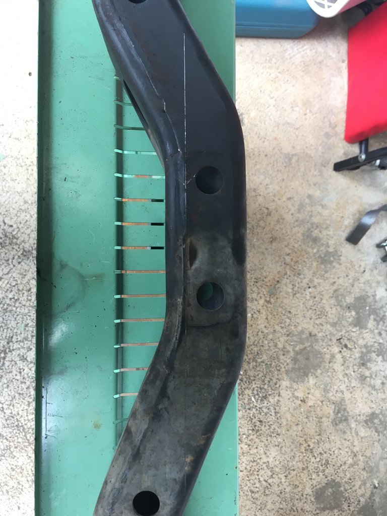

    I don't have a build thread yet, but so you know what I'm working with:

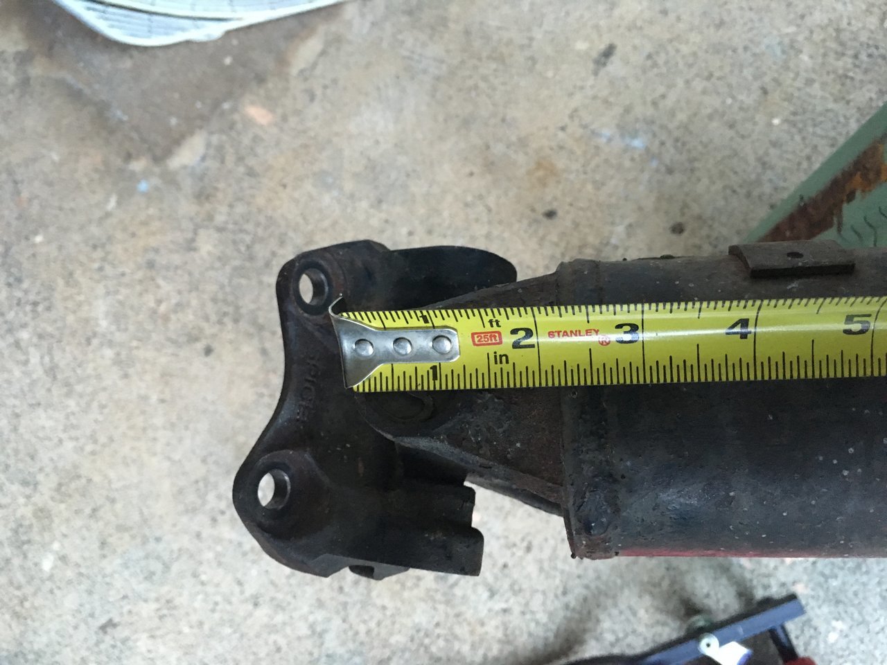

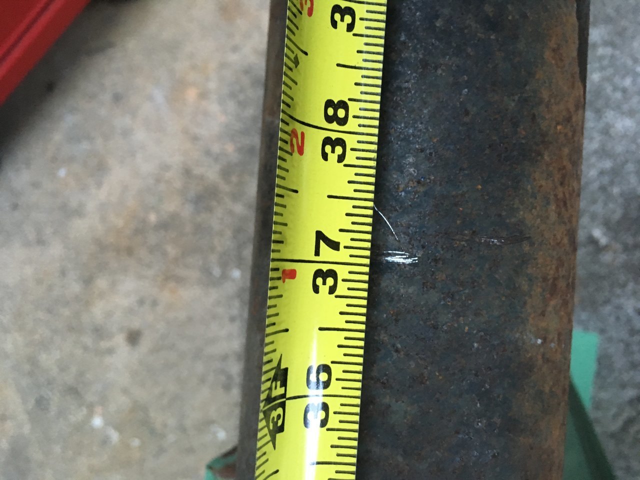

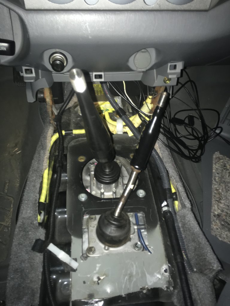

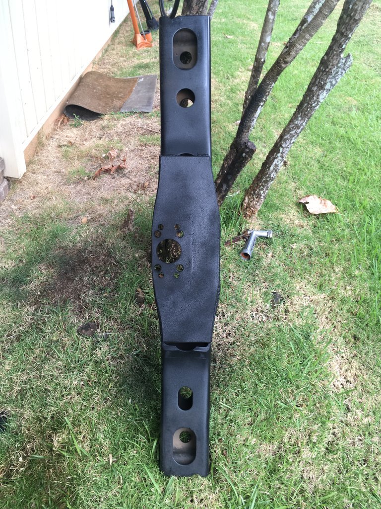

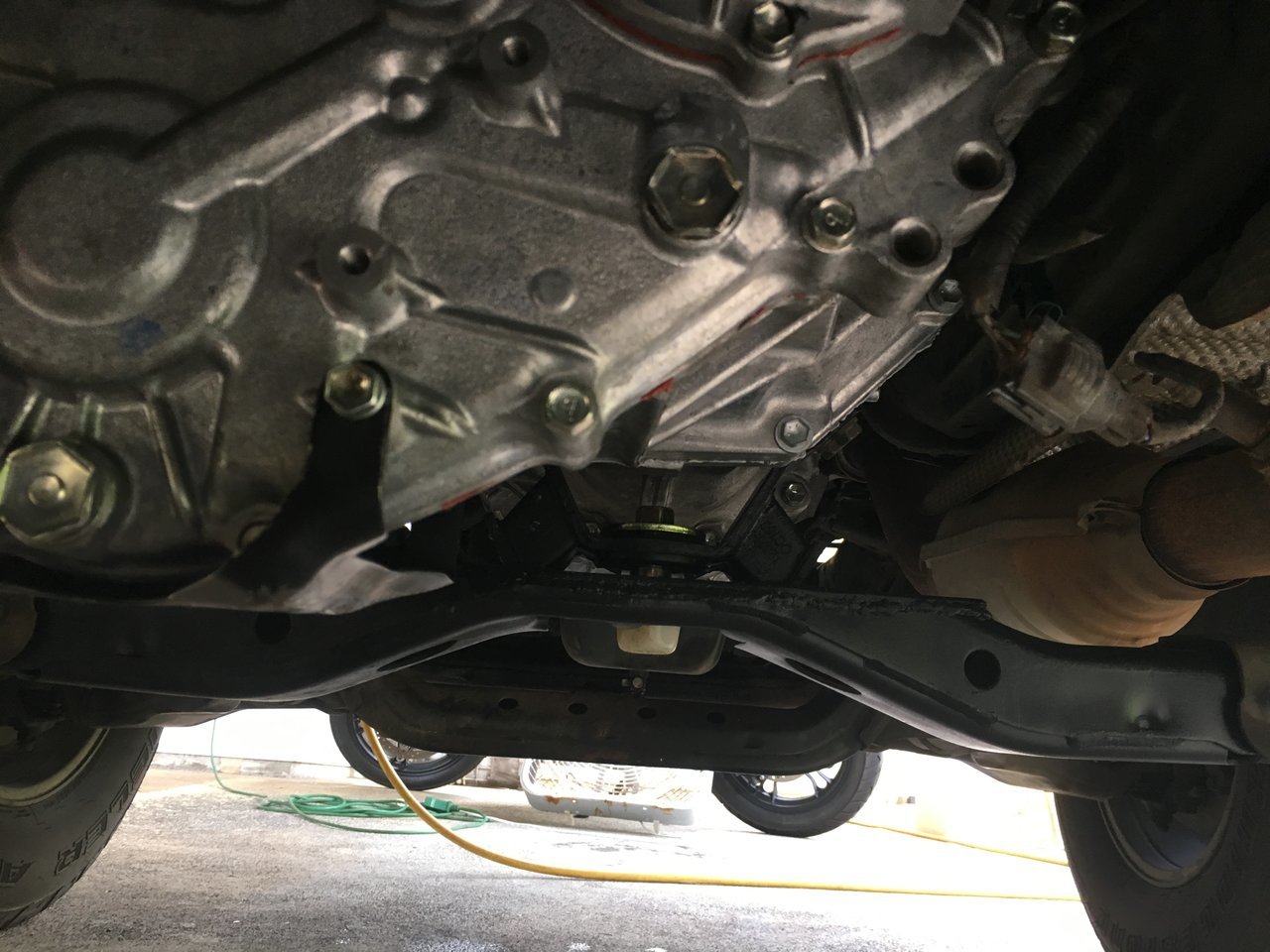

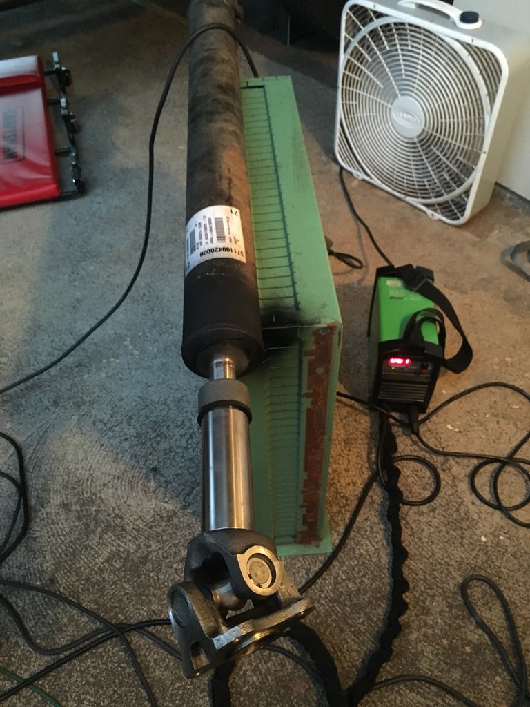

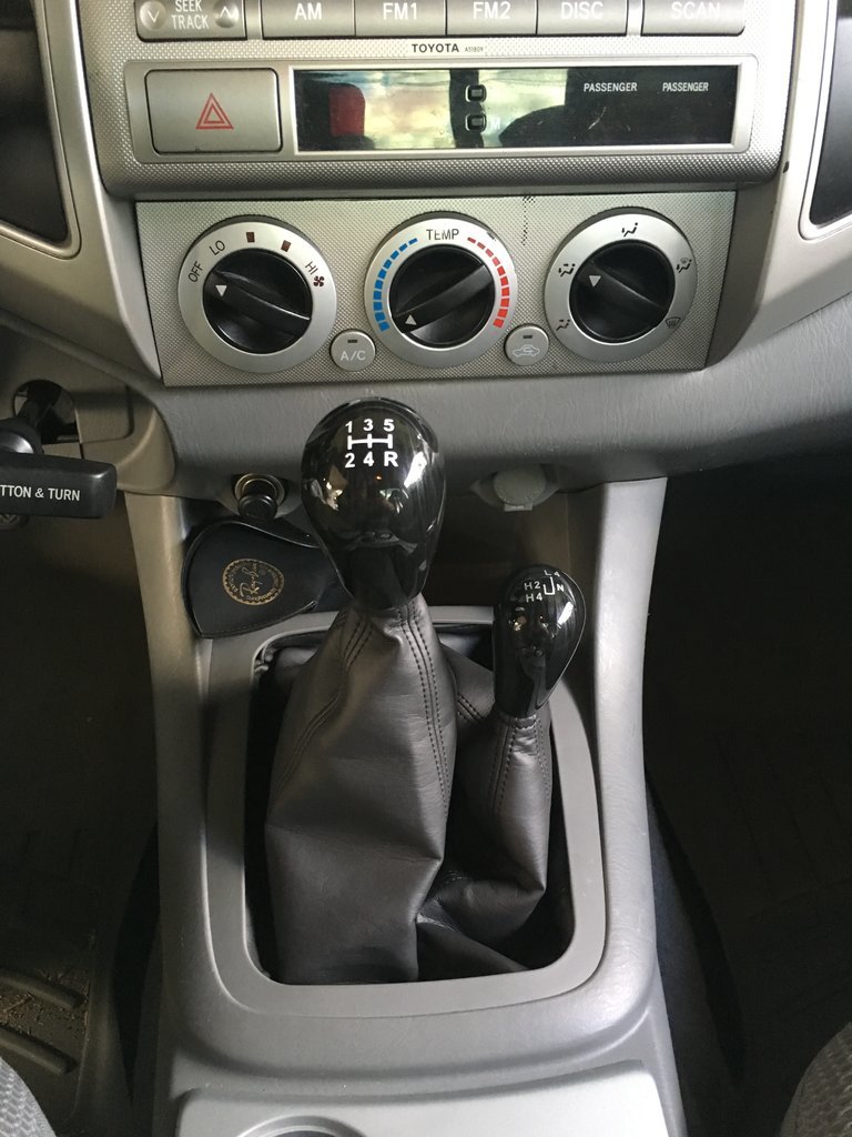

    Half done; transmission, t-case, refabbed the crossmember and driveshaft, and installed a TrueTrac. I have the front components but working on another project, so don't want to pull the parts and reinstall. It'll be complete by the end of August.
    So NO, still 2wd lol
