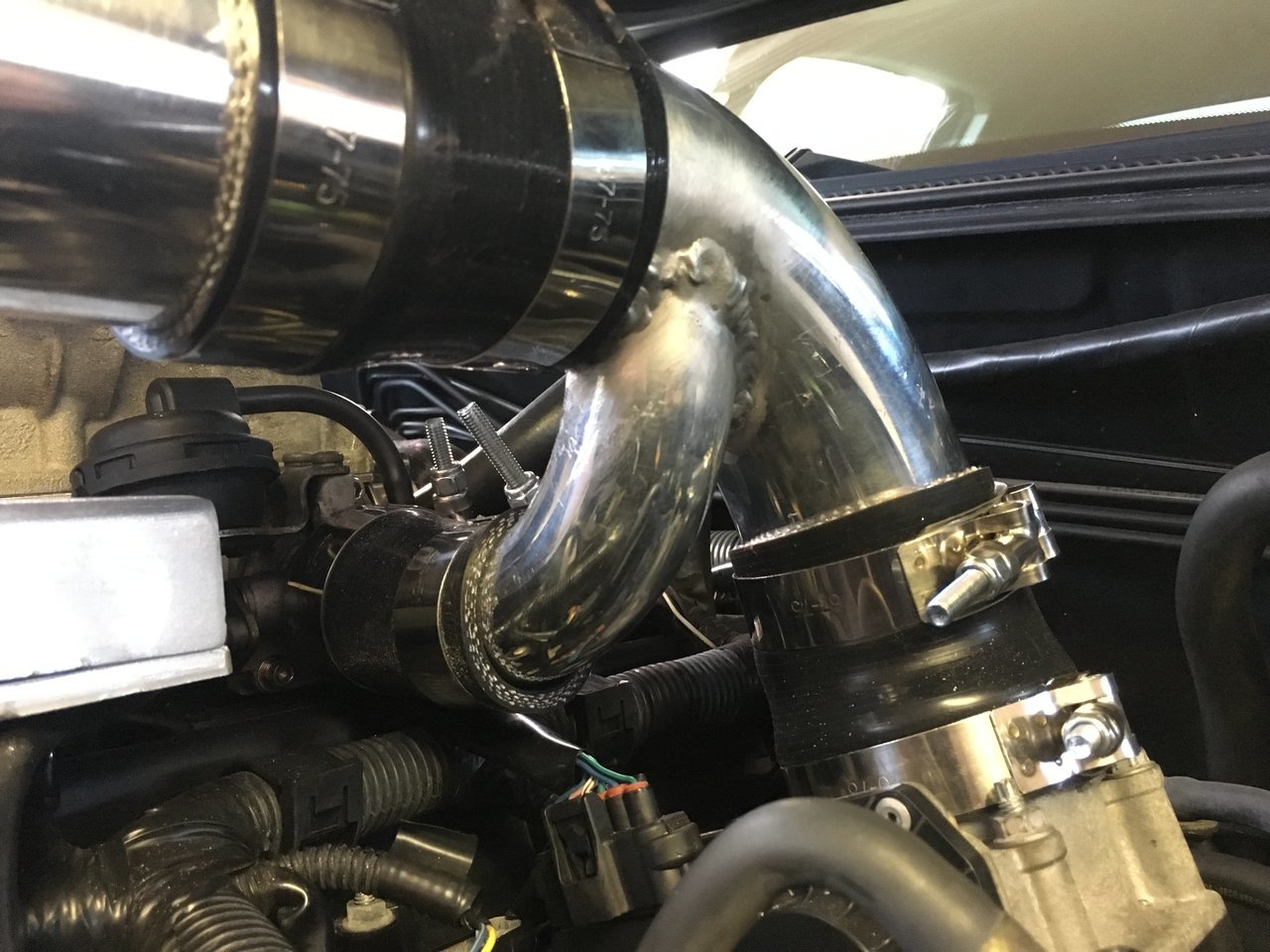

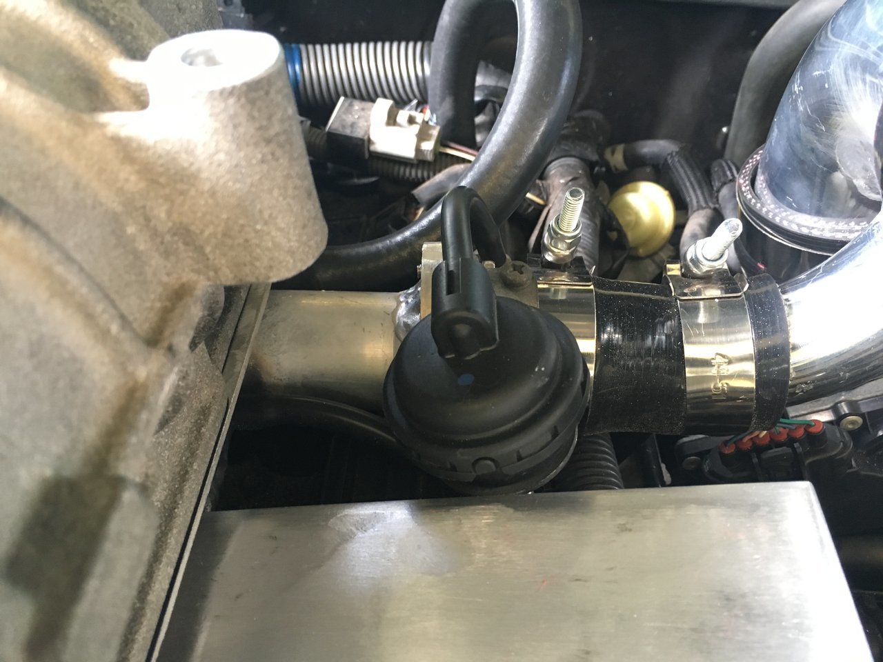

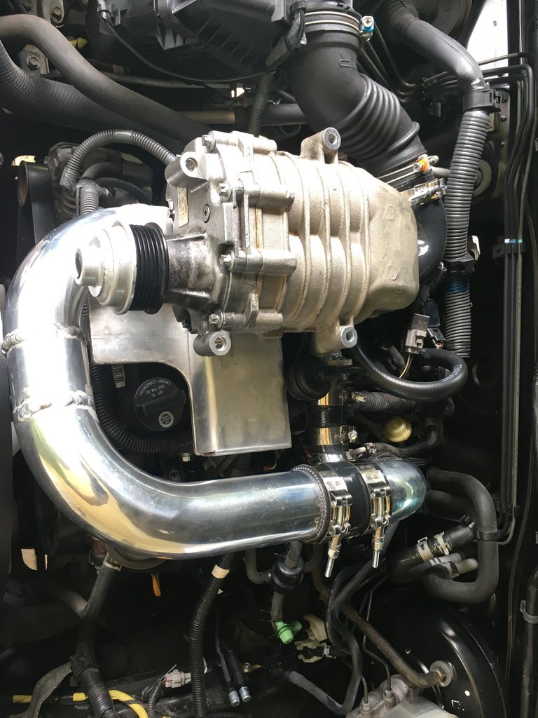

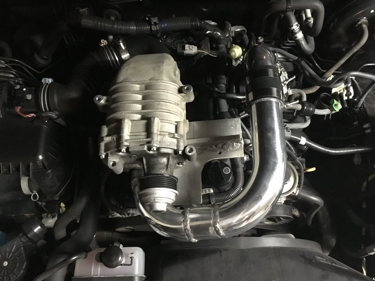

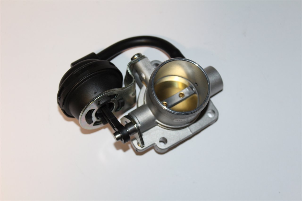

    The serpentine belt finally came in, got it all in and started it up... screaming banshee! I turned the set screw so the butterfly is open at idle, gets rid of the noise in the driveway.
    I think I might have got a bad bypass valve (used off eBay) or installed it backwards smh. I don’t want to buy a new one or cut and weld anything until I know the problem.
    While going down the road- give it lots of peddle, no noise; little peddle, noise. Push in the clutch, screams until RPM drops.
    Your thought?

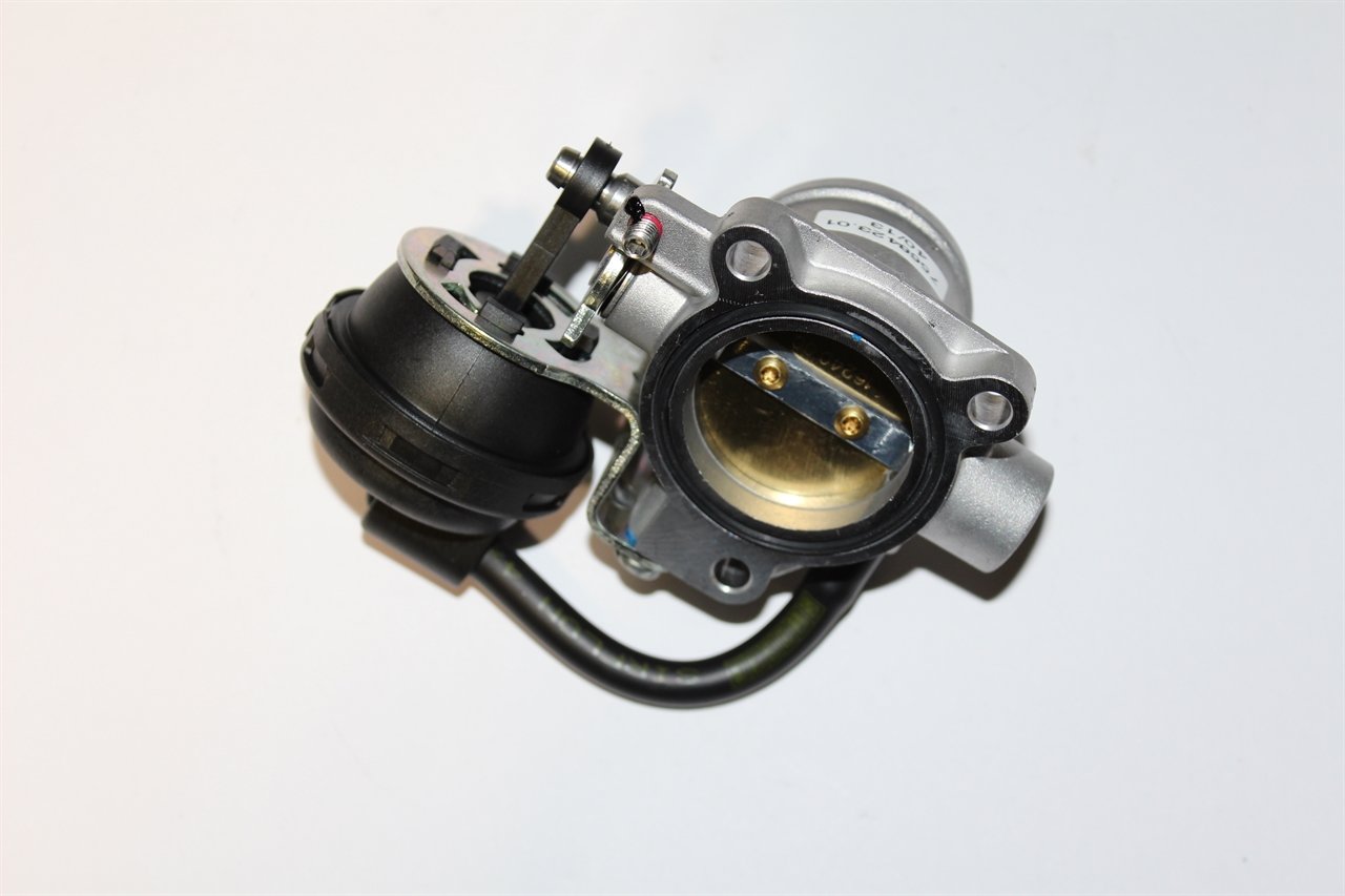

    You sir are a legend, when I first read "diy" super charger I chuckled because most don't have the patience for all the fab to diy this when they can shell out cash for a magnasun.. but damn this custom piece you're building is gonna be sweet!!! You should give it a little paint to add some flash under that hood. I'm sorry I have no idea on your bypass valve tho maybe show a picture of the whole valve? Maybe one of the guys have tried a similar one. Post a video of that thing when you get a second
    #54

    Where did you run the vacuum signal for the bypass valve? It should be post throttle body referenced.
    If so, I would question the valve at that point.

    The mounted side is on the intake of the supercharger, as seen in the pics. The vacuum is from a small hole on the other side. That means it’s getting it’s vacuum from just before the throttle body, the elbow in the pics

    Vacuum post TB. It must.

    It’s all plastic :confused:
