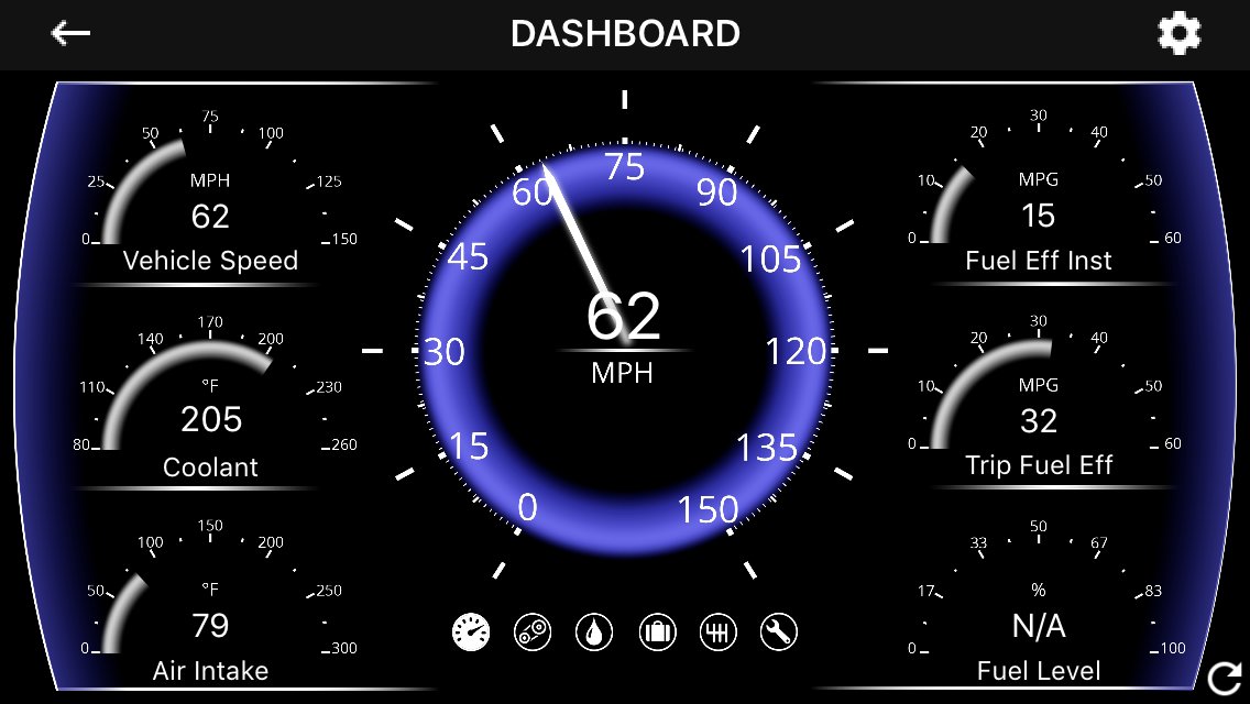

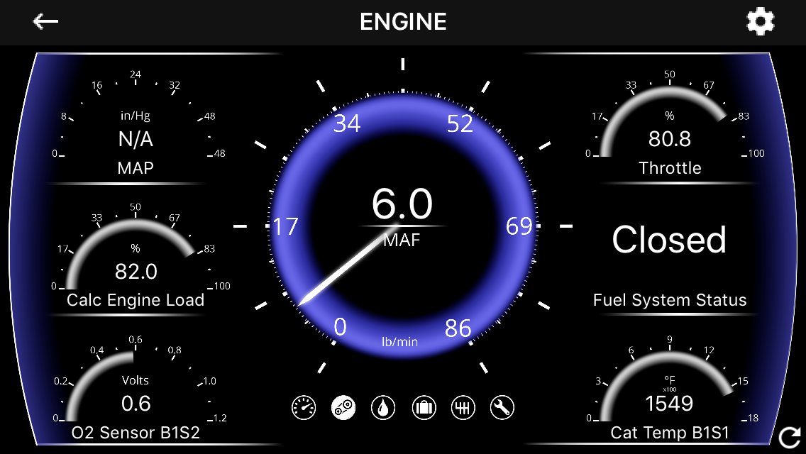

    A few screen shots while going up the big climb on H3

    Time to get a lower temp T-stat, and some other heat abatement efficieny mods.
    Really liking that gauge display. :thumbsup:

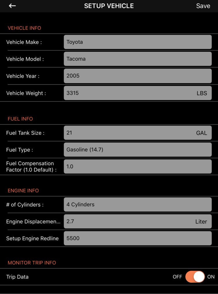

    I need to contact PLX, those numbers are wrong. My truck was definitely not getting 15 & 32 MPG. Numbers were more like 9 and 22.

    Sounds like a setup parameter.

    Here's my setup, there's not many options.

    You're vehicle weight is off by about 500 pounds.
    I wish our trucks were 3300 lbs lol

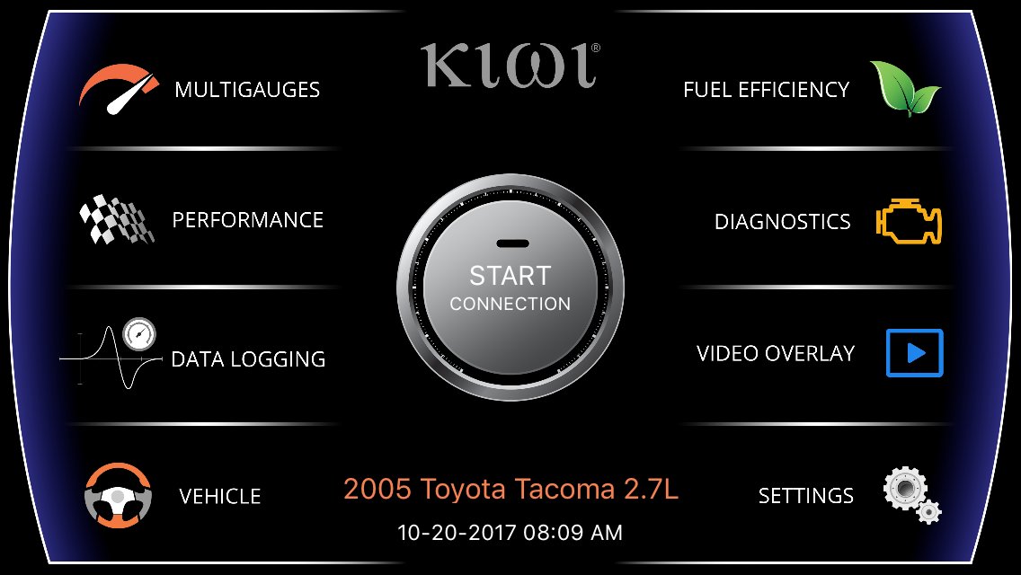

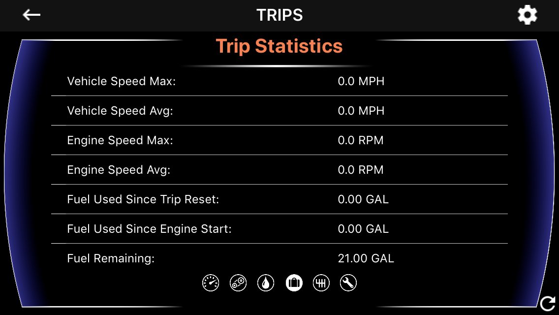

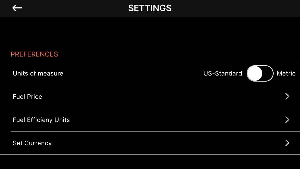

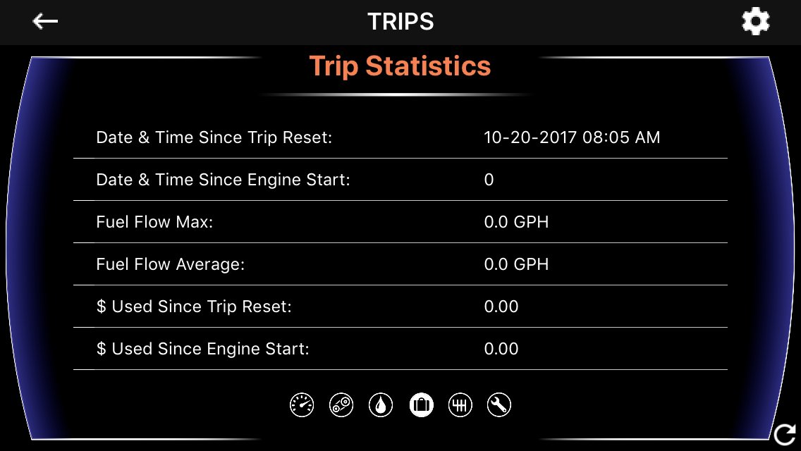

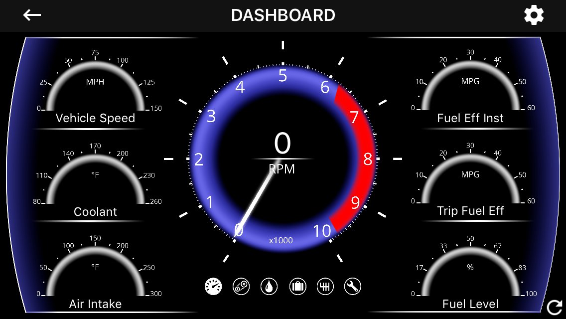

    Kiwi OBD
    You connect from here, not Setttings>Bluetooth (iPhone)
    >PERFORMANCE and >DATA LOGGING are "COMING SOON"

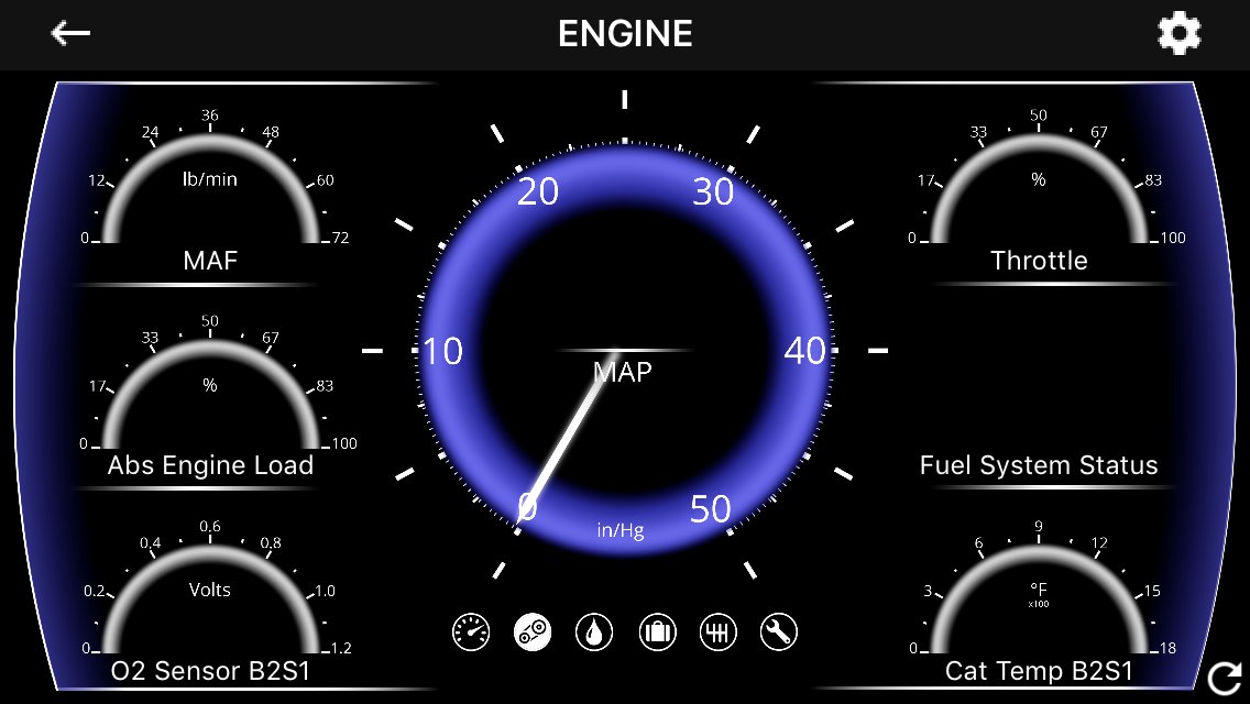

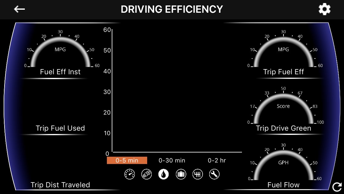

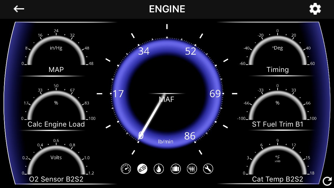

    >MULTIGAUGES
    Each gauge will change to another option, I tried to capture each option
    HOWEVER, the arrangement is not customizable

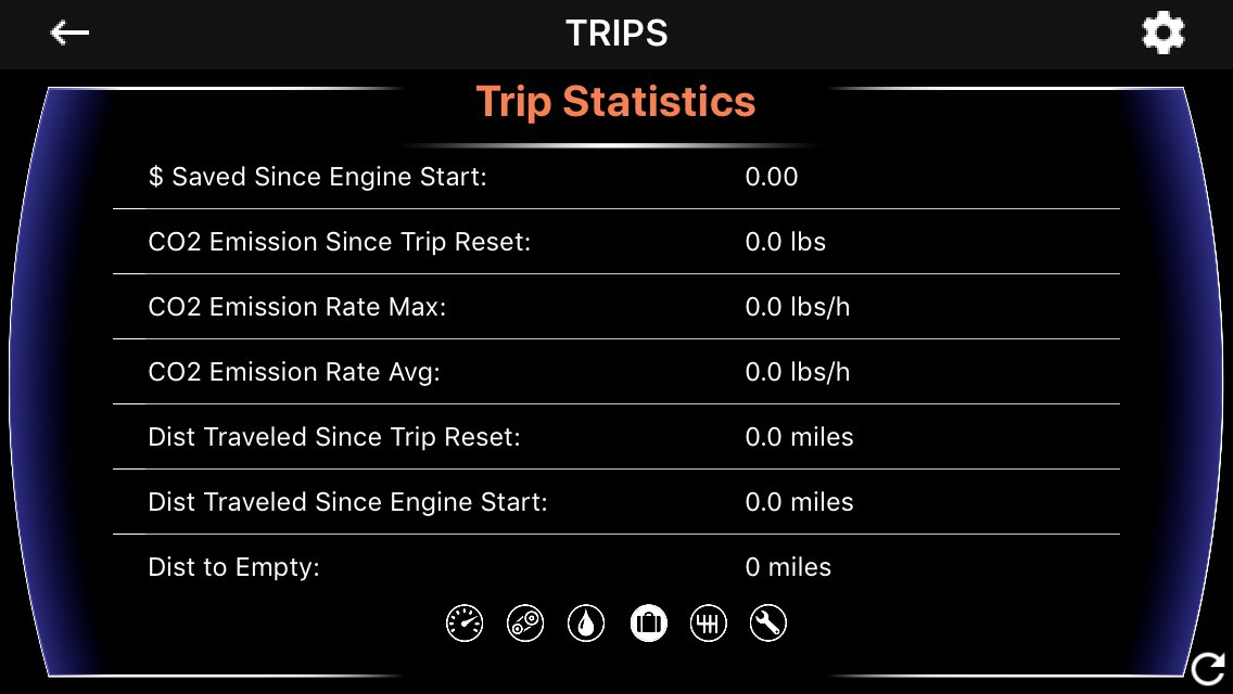

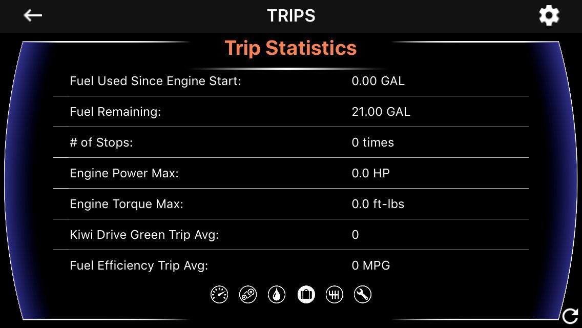

    You can reset the trips by pressing the arrowed circle at the bottom right

    My regular cab 4x4 is :thumbsup:
