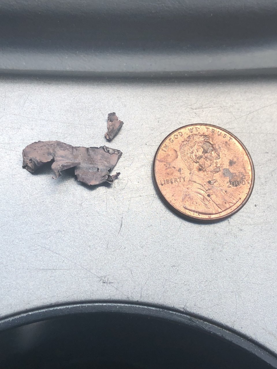

    Hmmm
    Brand new Afe headers cats ypipe
    They probably have 2k miles on them.
    Would explain the one piece of pinkish hued metal i found sitting on the lip of the tail pipe. Which scared me into changing my oil.
    So
    Cat maybe failed and is constricting now flow ?
    Better than some gasket leak causing low compression. 8CFAED3B-D38C-490C-A69F-8F926D5DACCE.jpg

    Could also be a muffler baffle, which may be more likely since the cats are almost new. I certainly don't think that came from the engine, It shouldn't have been able to get through the cats matrix.
    I suppose new cats can fail too, could the supercharging and tuning be causing them to overheat though?

    Those afe headers with cats are knows to come apart. About 99% sure it’s that. Plugging ur exhaust and making it have no power. U do a search for afe cats and Ull Find stuff I bet

    The hissing is the restriction in the catalytic converter. All your symptoms point to that as the culprit.
    If you can't get it out, you aren't getting enough air/fuel into the cylinders.
