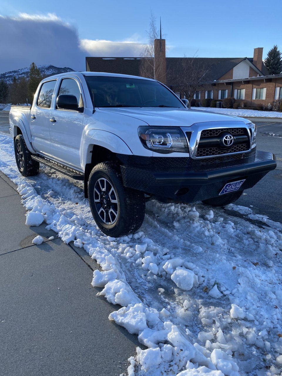

    Howdy everyone. New to TW membership and wasn’t able to find anything that addressed this specific scenario, so here goes.
    I purchased the my ‘11 DCSB with the supercharged 4.0 in December. I’m the second owner, the title is clean, and the truck has just under 113k.
    The long short is that I removed the cone and replaced the coupler, did the SC oil change with GM oil, resealed the cone and installed a new SC belt all at the same time I replaced spark plugs. Plugs showed normal wear and the SC oil was fine but dirty (sorry, no pics). I’ve noticed since that low end power is up a little-probably plugs-and it idles a bit more smoothly. However, after all of this was done I found that the truck sounded like I left marbles on top of the intake and they’re now rattling around when I’m idling. The noise goes away, as others have indicated in other threads, above idle and when I’m into the boost.
    I’ve read elsewhere that the marble-like noise is “normal”, but I can’t get on board with such a marked difference in engine noise/note at idle. Walk with me, if you will through the possibilities:
    1. Coupler installed improperly? New style (no spring) coupler isn’t directional and fit snuggly.
    2. SC oil was overdue (112k) and change in viscosity caused enough variance internally so as to start making noise. This is just how the blown Tacoma’s sound.
    3. SC tolerances, for some reason, are out of spec and the SC’s internals need rebuilt.
    4. Oil, belt, coupler and plugs functioning as designed make obvious a previously existing condition with the engine (possible piston or wrist pin).
    The question: has anyone experienced this scenario or something close to it and resolved the issue? Any other potential issues that you’ve experienced I’ve not thought or or read about elsewhere?
    I have not pulled the SC belt or unplugged coil packs for individual cylinders or “put ear’s on” pulleys to listen for a bad idler or pulley for the SC. Thanks in advance!F4716347-F87E-4823-A888-21CA7D29D701.jpg
