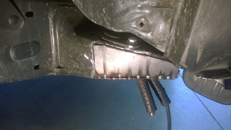

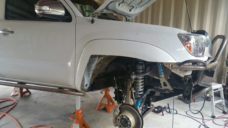

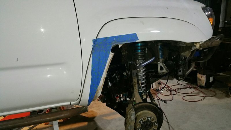

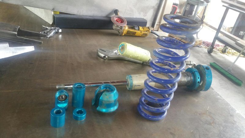

    IMG_20160301_210526_01.jpg IMG_20160616_011804_01.jpg IMG_20160616_011937_01.jpg IMG_20160616_011951_01.jpg IMG_20160616_012039_01.jpg

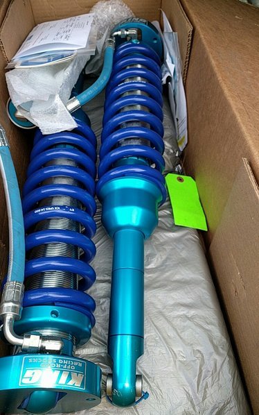

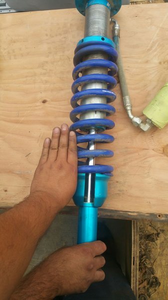

    Photo one original stock length shock, was originally going to put the block spacer above the coilovers back in from the rough country kit to keep the height. I have up on it because I couldn't get the spindel to meet the uca ( I learned now I prob could have done it if I lifted harder on the LCA) either way I told them I had a drop brackets and block spacer and what I was trying to do and they told me "no that won't work, you can't use the spacer/block" so
    They tell me send them back and pay $400 and we will make them the right length. I received pic 2.
    Ok photo 2 had me pissed. Not only did I get the wrong length to start, I paid $400 additional and they send me this spacer bullshit. I was expecting and longer springs and more stroke. I argued with them and explained that this is not what I wanted. They refused to admit they thought I was a mall crawler and would not rebuild them the way I wanted for free so I said fuck Kings.

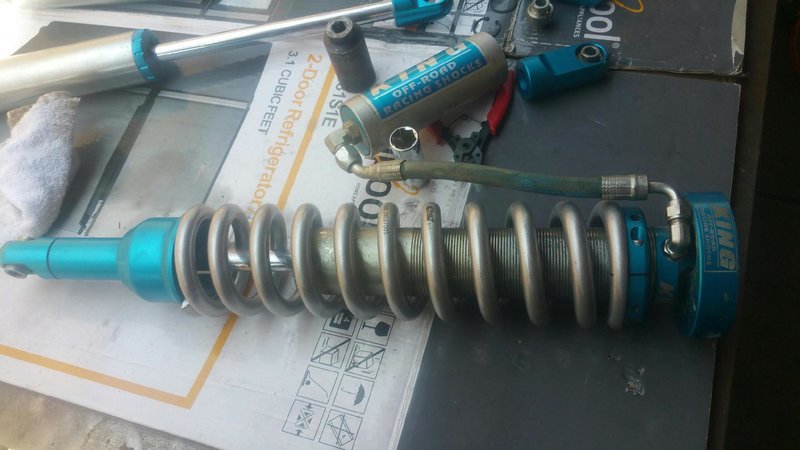

    Pics 3 is my friend taking them apart and cutting the spacer down and removing some shims I think.
    Pic 4 is them rebuilt with the same short spring but more stroke now because the spacer is cut down.

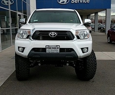

    Pic 5 Is the new 16" eiboc spring installed.
    Now they are just amazing. Fuck Kings! Poor service.
    They flex and move now very well.

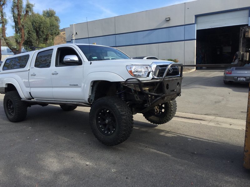

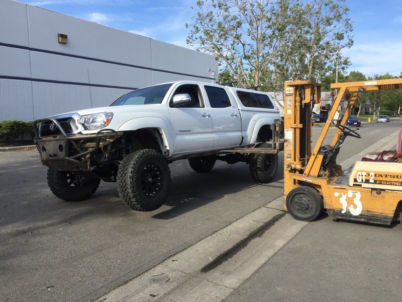

    Nice build, I like that armor tech rear, the way it sits closer to flush than the stock bumper appeals to me, as our DCLBs are long enough, lol... the pics with the forklift lifting the front end from the center hoop are a real testament to the build quality I gotta say!
