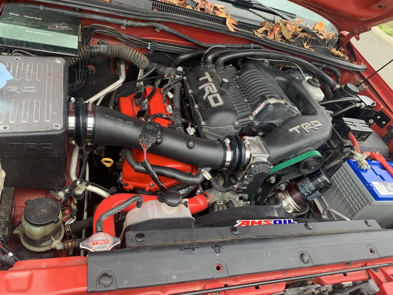

    Not supercharged, but used to be. Have my sPod electronics mounted on top of the fuse box cover
    herecomesace likes this.

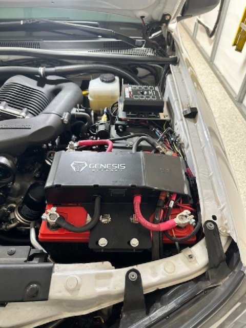

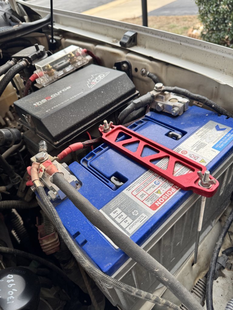

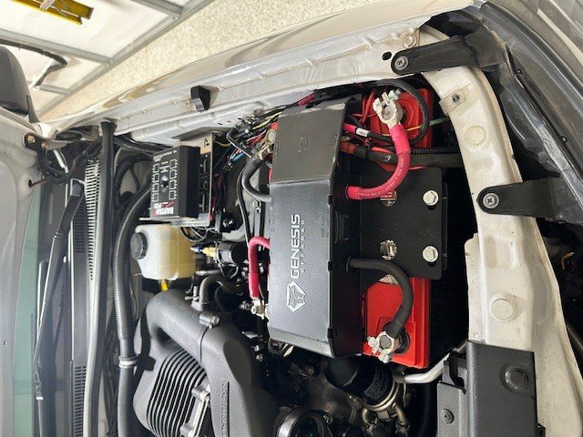

    here is mine, you can see the Spod on the passenger side. have a fuse block sitting on top of the truck fuse box.
    fatfurious2 likes this.

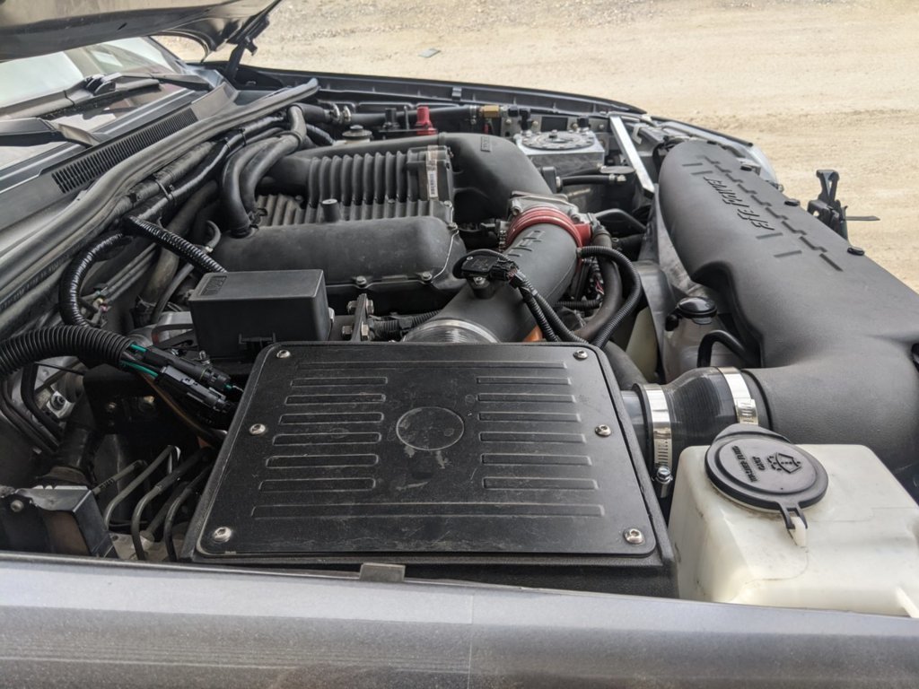

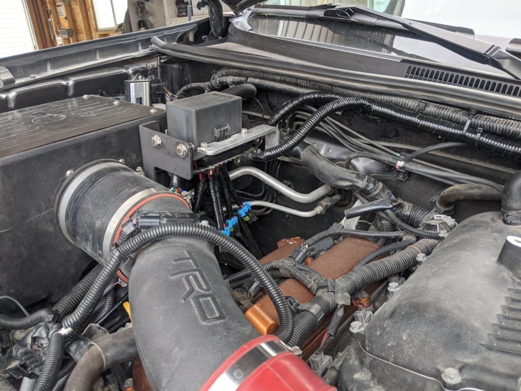

    I fabricated a bracket for a Bussman RTMR that mounted on the AFE air filter box and the firewall. Has stayed solid thus far though I don't off road.
