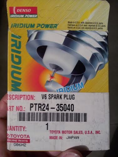

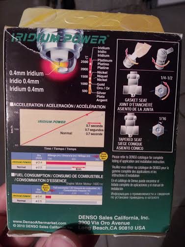

    I have the 3.4 w/ supercharger and was told by previous owner and Toyota to run Denso PTR24-35040. These are not cheap, but have worked great. 717f701c-f3a3-4c32-b98e-37ed83c61905.jpg 5577ae99-db15-4981-8685-7163fccba231.jpg
    eon_blue[OP] likes this.

    I went with the Denso Iridiums 53040 (not 35040 like whats printed on the box above, not sure if that was a typo made on the label or what). Been running them for a couple months now and they've been great. They are single electrode as well. Maybe the dual electrode is recommended for the stock copper plugs that Toyota uses?
