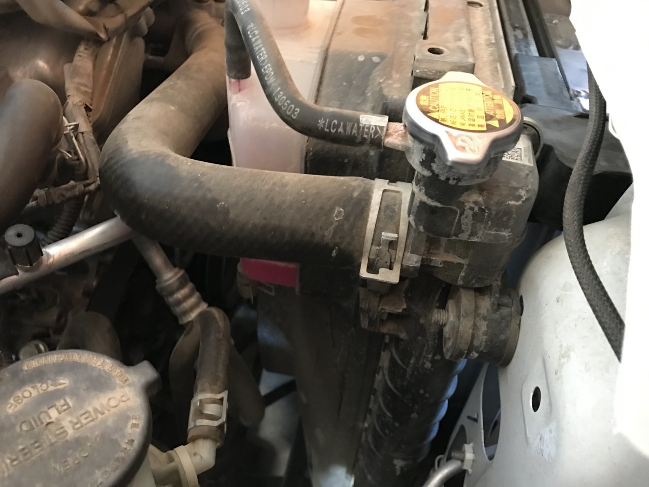

    Hey all,
    So first off let me state that around where I live I haven't had an issue, my coolant has been staying around 178-194 around ttown driving. My problem has been occuring on my last two trips. One to Arizona/nevada. Some mild offroading and then driving through town my engine and trans were getting pretty warm. Engine hit 210 F and tranny got to Like 232. When stopped at red lights my ac would blow warm humid air. Now fast foward to this last Monday. I went out to Las Vegas and after some freeway driving on the offramp the truck started to warm up again. Stopped at a red light ac started blowing warm again. This time engine temps were around 205-210, trans only got up to 215-220ish.
    I have done some searching on here and it is leading me to believe this is not normal. One thread the guy had some mud in his radiator and that seemed to solve his issue, though his temps were much higher than mine.
    Also would like to mention I never had this issue before the supercharger. Truck purchased at 47,500 miles, supercharger installed at 50,147 miles. When I had the supercharger installed I did a full coolant flush and also a full trans fluid flush.
    Yesterday I had the ac system looked at, it says they recovered 1.34 Lbs and put in 1.39, that's only .05 lbs difference. I don't think that is the cause of my hot temps and air not working.
    So I checked the fan clutch today, from what I have read on how to check it, it doesn't lead me to believe anything is wrong with it. It has a lot of resistance when I try to spin the fan, and not much side to side play.
    I am currently trying to "clean" out my radiators, not too sure the best way to do it and actually I am trying to figure out how to remove the fan and shroud so I can really get in there and clean things up.
    Any suggestions would be greatly appreciated, would like to solve this before it ruins my head gasket. Not sure those temps would cause that big of an issue but in my mind it certainly can't be good for it.
    Also could it be a bad radiator cap? Just thought of this right now, noticed some residue under my cap, not sure if it is normal or what. Here is a pic of itIMG_7733.jpg
    Edit:
    Truck is currently at 57,093 miles.
    It has the trd reflash done
    Nothing is currently leading me to believe the truck is running overly lean while driving.
    Also the waterpump was replaced at 50,147 miles when the supercharger was installed.

    Coolant is full. How do you suggest I check the fan? Put news paper behind it when the engine is up to temp?
    there is a lot of resistance when I try to spin the fan with the engine off, from what I've read it leads me to believe the fan clutch is doing its job.:notsure:

    I would yank the fan and shroud, and spray the crap out of the fins from the backside. Use degreaser too as there may be road grime stuck in the fins.
    Be sure to do a very thorough inspection to verify there are no more coolant marks like you see on the side of the radiator anywhere else on the engine.
    Last, replace that radiator cap. It's easy, cheap, and probably the most important piece to the cooling puzzle.
    If these things do not work, maybe it's time for a full service. Water pump, thermostat, etc

    I'll say this, if coolant is full, and rad isn't plugged up with crap in fins, you likely have a thermostat starting to go.
