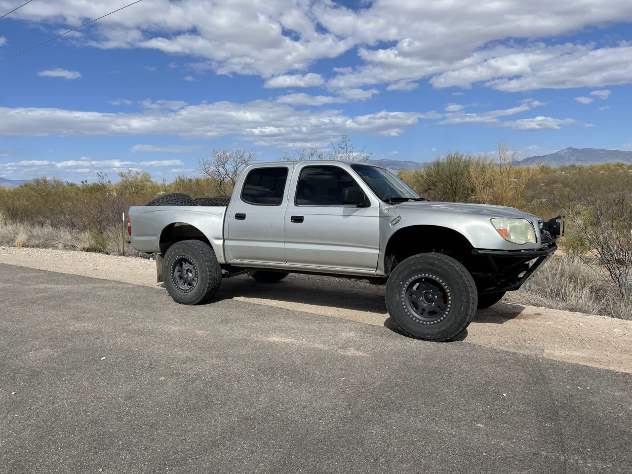

    Hey guys, I picked up a supercharged first Gen with 102,000 miles and I have a few questions.
    First and foremost, the previous owner has never installed any fuel upgrades, like the 7th injector kit or even a upgraded fuel pump. I’m not seeing any issue with RPM ping, but would I increase my power by upgrading the fuel system? URD quotes 30-40 HP, but idk if that including the SC as well.
    Question #2:
    This truck has a cone, oiled style air filter installed. What’s the best filter to run with the SC?
    Any insights you guys can provide will be awesome!
