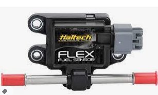

    You have a much better option, the flex fuel sensor you put in the fuel return line and the Haltech sees the percent and adapts the tune on the fly. With my piggy switch method I'd need to run 91 octane to empty, then fill E85, switch- then run that to empty , fill 91 and switch. With the senor you can just filll whatever and it would see 85%, or 60%, or 40 etc and adjust fuel/spark accordingly.
