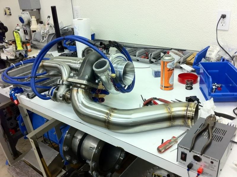

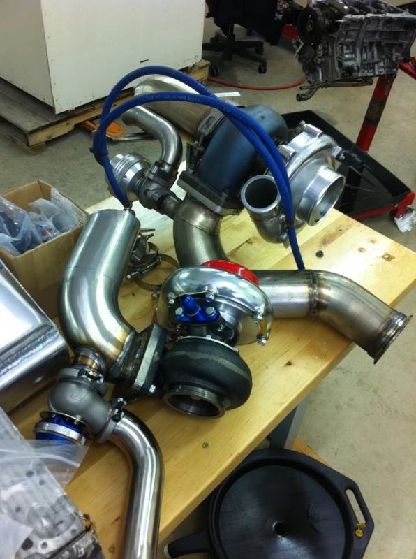

    Yes. A few people have. Both were rear mount turbos setups. One was an STS rearmount kit, and the other was a custom rear mount kit, by Allan Phillips Racing.

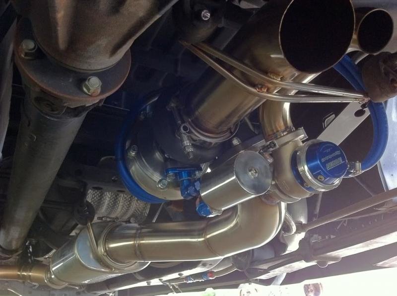

    Here is the rear mount portion of the same kit used on the twin charged XR. The twin charged XR was an old member's by the name of Balboa. Never finished his truck though. Only did a few pulls, before they decided to pull the engine and beef it up more. That is where their project stopped.

    Is that turbo sitting after the muffler?

    Yes sir it is. With a packing media style muffler, if it were after that rear mount it would burn out packing in a short time.

    2014 MGM DCSB
    Ah ok. It looked like a chambered muffler and I was wondering how slow the exhaust gasses would be coming out of that muffler.

    Gotcha. No. The two of these kits used straight through mufflers.
