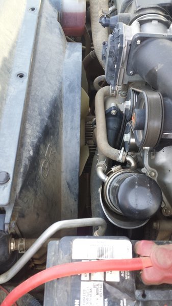

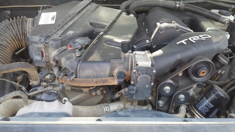

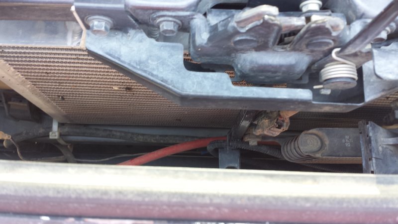

    photos have arrived..
  5. Jun 22, 2016 at 11:54 AM
    #65
    digitaLbraVo
    digitaLbraVo Derka Derka
    Sep 6, 2012
    #86398
    7,514
    Covered in stickers and chrome stick-ons for extra horse torques and foot powers. Icon sticker gets me tons of travel, dozens of milimeters.
    That doesn't look like it should be so bad... I'd agree with @chyknees check for an airpocket?
    Also: that's a dirty motor? :rofl:

    well.... I see some stuff on here and people get flamed alive for it... idk I feel like half the guys on here run a motor looking like it came off the assembly-line.. :notsure:
