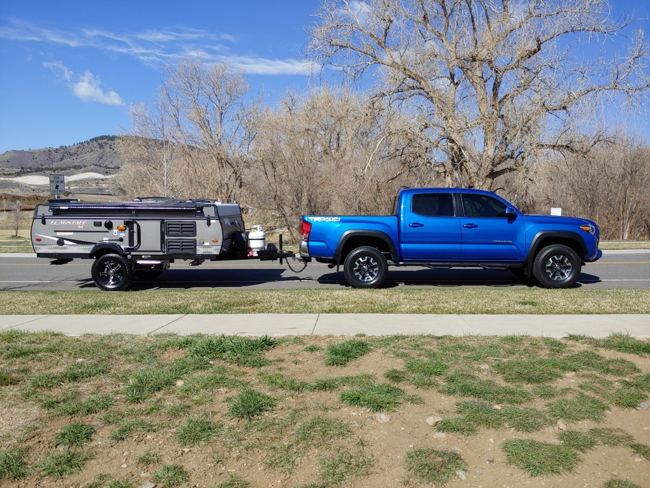

    20210408_095233.jpg (2016 TRDOR V6 SBDC AT, 4.88, stock tires, 6112/5160, Magnuson SC)
    Just came back from a 800 mile round-trip camping trip from base 6200 ft over mountain passes of 10,000 ft plus. Towed a camper (2250 dry weight) and a few hundred pounds of stuff. Maintaining speed limit was no problem. Truck ran cooler (transmission pan and converter, and radiator) than same trip last year when truck was NA we had a lighter camper (1700 lb dry weight). Used S mode and locked it down to 4th on long grades up Eisenhower and Vail (both directions out and back). About 3500 rpm - plenty of power as that is middle of boost (probably 8 psi). 60 to 65 mph with no issue, and able to pass without downshift. Magnuson SC made it run way better - totally different machine - no engine struggling noise (valves or other). Could not run it in s mode allowing 5th on grades - it does the oem monkey shift - so just locked it out when that began to happen. Something Magnuson will eventually fix with tune revisions. Averaged 18mpg while towing - trips btwn Palisade and Montrose/Delta not towing we averaged 23 mpg at 65 mph (pretty sure they are on Summer blend gas now which is way better for power and mpg than the Winter blend shit still being served here in Denver proper). Hands down much better than the NA engine setup.
