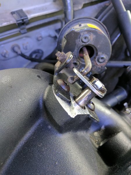

    Checked the bypass valve before I left work. The stupid actuator arm had slipped down in the bracket hole and was catching against one of the mounting bolts for the valve.
    I pried it back in place and everything works perfect. Thank you all for your quick support and suggestions. Jason, I'm so happy it wasn't the cat!

    Me too! I only assumed because you said it was fresh back from a rebuild.
