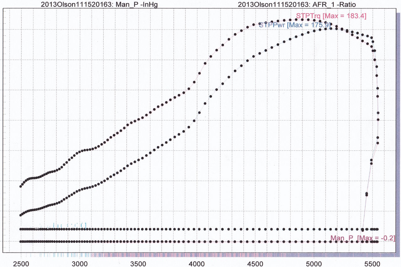

    Dyno pre-SC

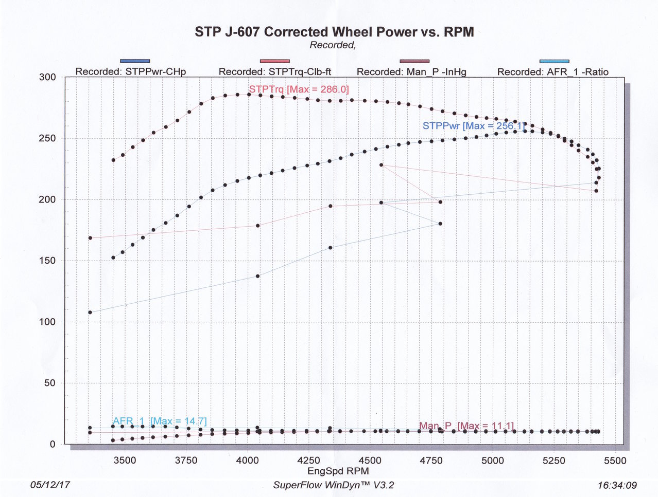

    Dyno with SC, & headers, stock pulley

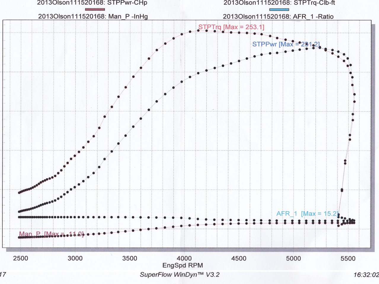

    Dyno post CAT deletion, stealth pulley

    There has been another member or two to have the AFe cats blow out. Nothing the installation shop can do other than install new high flow cats.
    Is your dyno taken at 6000' elevation?
    The WOT AFR is good at 11:1.
    Install an O2 simulator for your CEL problem.

    Dyno was done at 6500' elevation.
    I see the CEL as a symptom. What I want to do is figure out why it's burning out my CATs & getting such crappy MPG - seems like it's running too rich, even though the dyno says it's fine.

    The CELs listed only read the cats. The ones installed might not have catalyzed well enough from the beginning. Then blew out.
    A CEL for running too rich would be more symptomatic.
    If you have an AFR gauge, you can visually monitor how rich it is actually running. Some even have the capability to datalog. Then you could have the data aquisition to prove it is running in a manner that needs an update for the tune.
    Or get a UCON.
