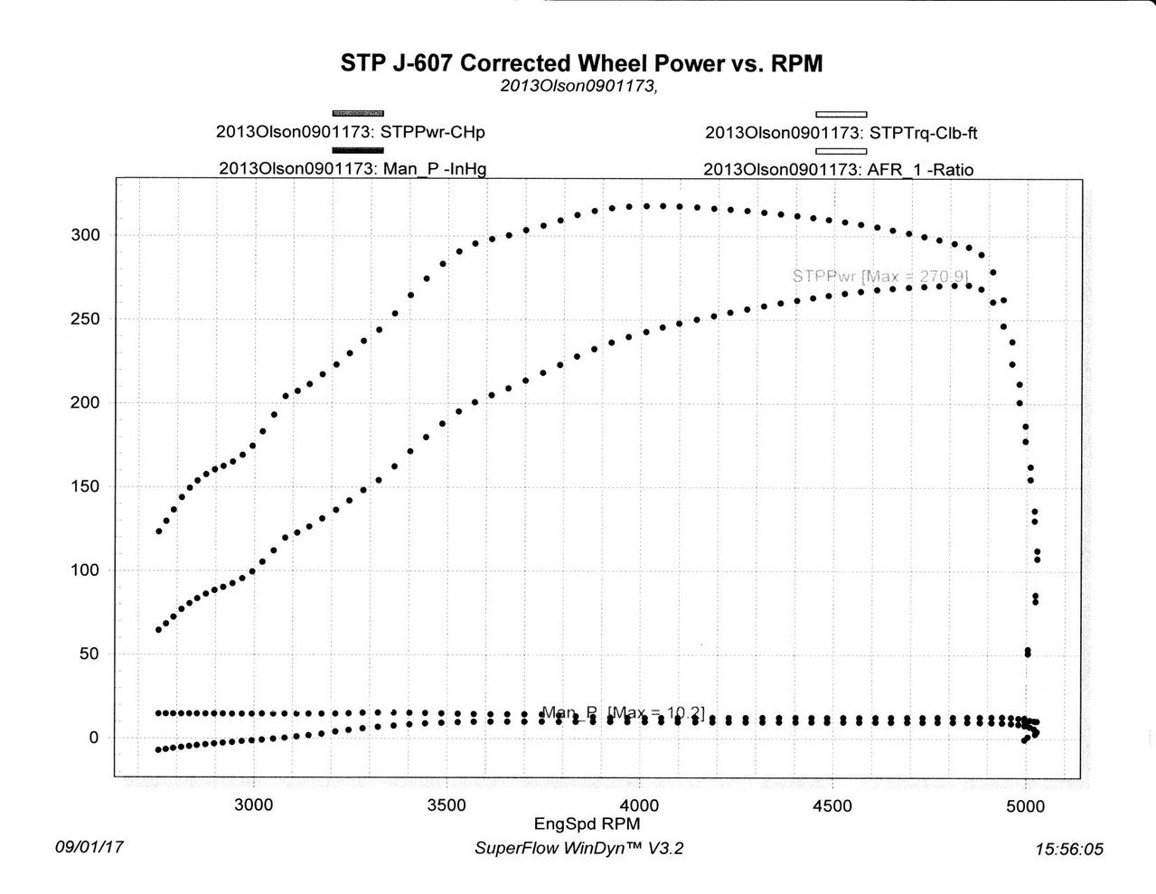

    Update: New headers & front CAT's have been installed. Expansion chambers installed to help quiet the exhaust. AFR gauge has been installed. Dyno run completed - see next post for details.
    So now it's running too lean. :angrygirl:
    Bully Dog is sending a tech to my local shop to get it tuned correctly -- that's the good news. :amen:
    Question: They welded the bungs & installed the O2 sensors BEHIND my CATS. How will this affect my AFR readings? Is it worth making the shop move them to the correct location in front of the CAT's?

    Taco Dyno Replaced Headers New Tune.jpg Here's the new Dyno run.

    Data print out for new Dyno run.
