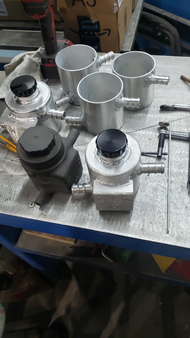

    Making progress.

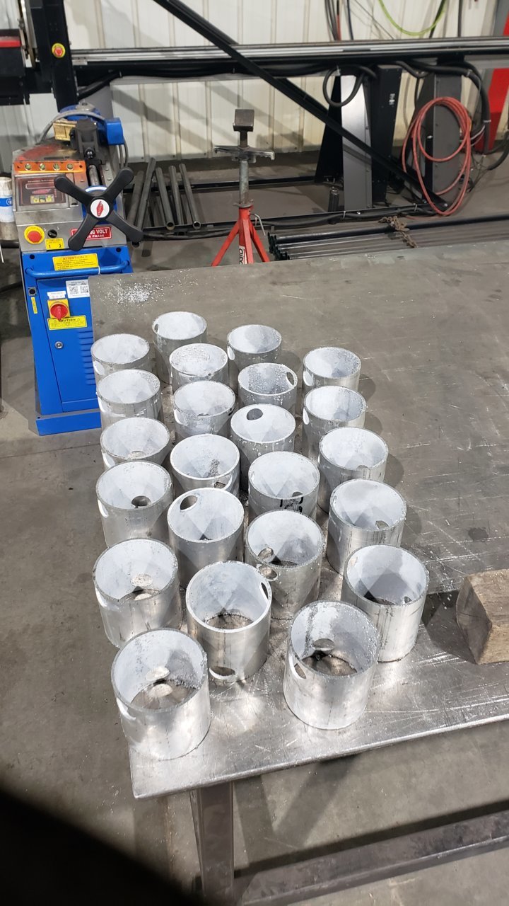

    Got this job heading out the shop a bit early so had time to load the pipe into the bend tech and all cut up.
    Another step done.

    I'll clean these up and try to plasma the top and bottoms out as well as the mounting plate by the end of the week. Bend a couple 90s on each plate then all that is left is to sit down with the tig and hammer some out.

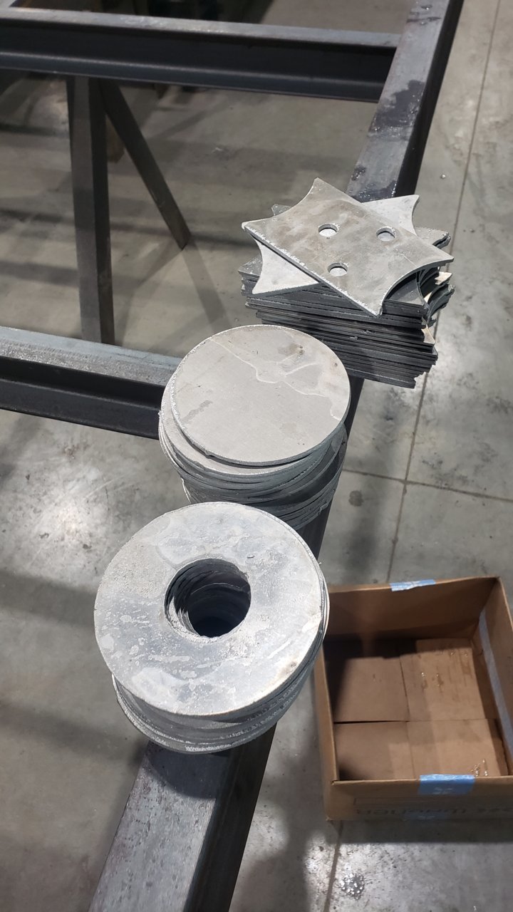

    All tops, bottoms and sides cut up today.

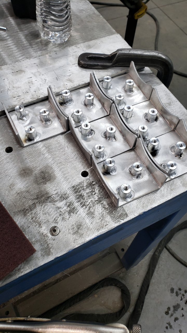

    2 tanks down. More tacked together. I'll try to have these 2 cleaned up more and pressure tested by the end of the day. For not welding aluminum in months I'm happy with the results

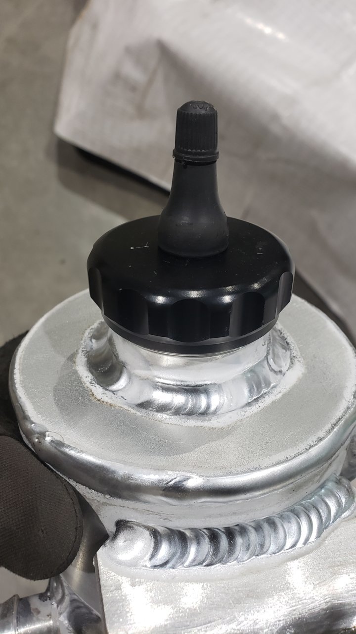

    Both tanks passed. No leaks. Took a spare cap n put a valve stem in it to pressure test each tank.
    If there no objections to this idea- I'd like to send @JasonLee and @dcoursler the 1st two tanks as they have been waiting on cam gears for a while now too. After that it'll go in the order listed on page one.

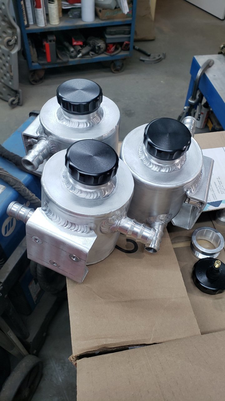

    3 more done and pressure tested. These will be in the mail Wednesday.

    I wish thess were the option on the first go around! These are much better than the standard radiator cap versions.
