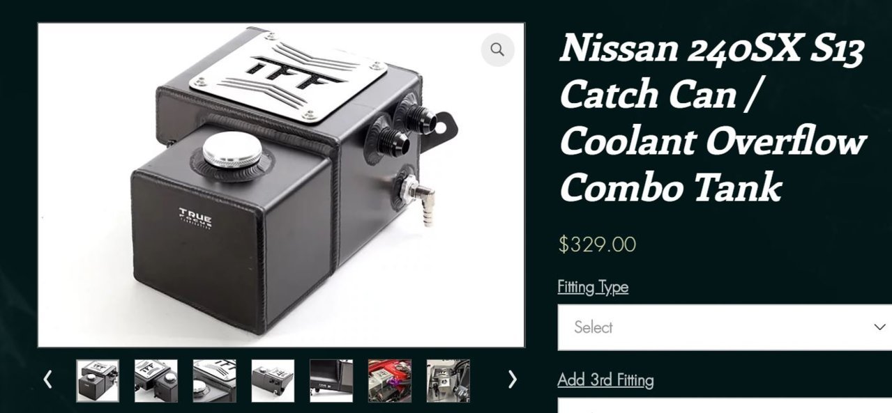

    or this....

    I couldn't do this at a similar price. A dual tank like pictured would essentially double the cost.

    fuel pump mounts were the ones i looked at. duel purpose perhaps.

    Totally understand. Would def be more, but it would eliminate the crappy reservoir tank, with an added oil/air separator. Knock out 2 birds with 1 stone.

    looks nice but space is a premium. im sure @mightytacoman has a plan.

    Yea, definitely lack of space under the hood. Would be a great option tho.

    That makes sense. Don't worry about all our suggestions, which are just that - suggestions. Stay on the simple path you started.
