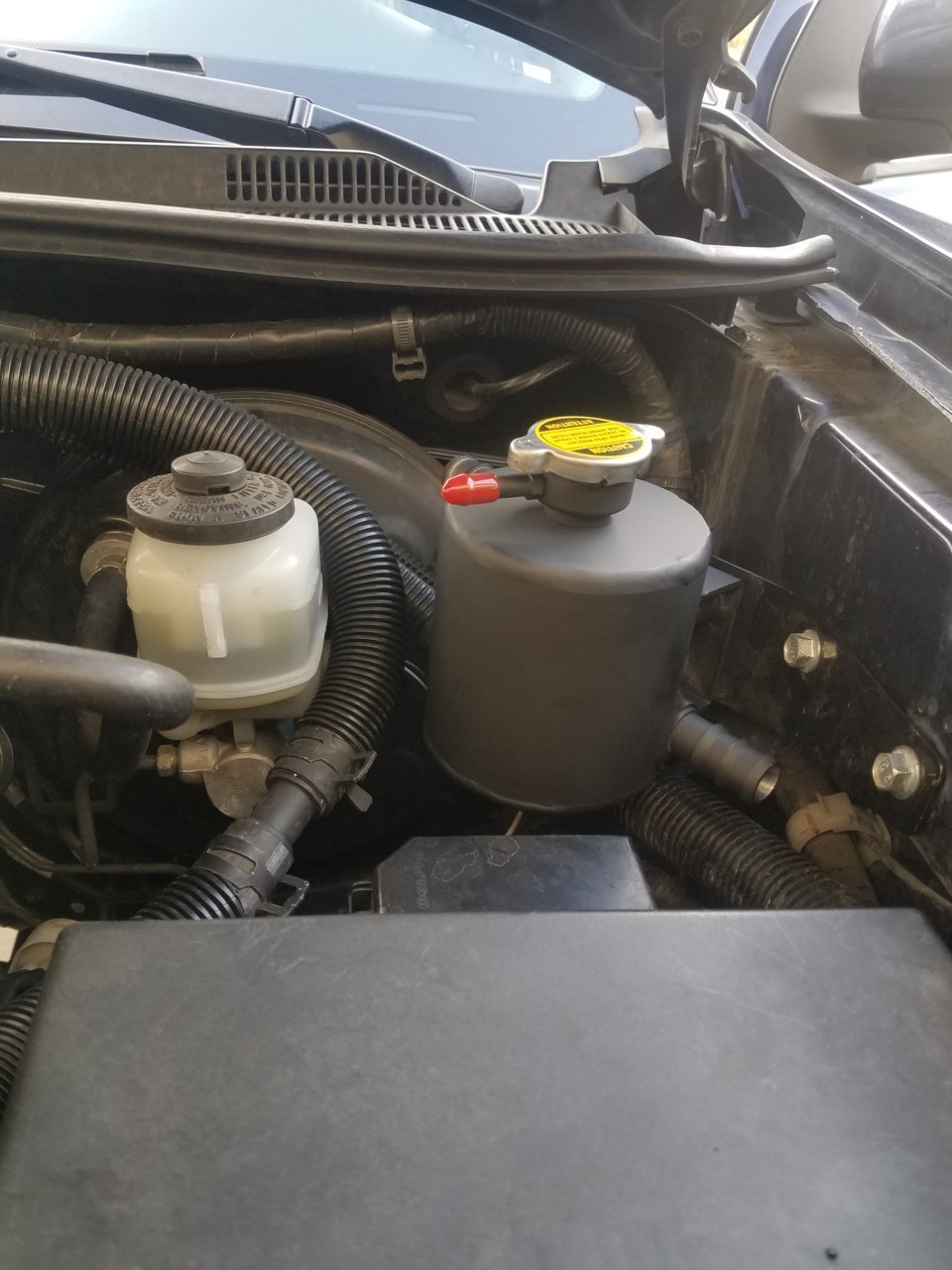

  13. May 13, 2020 at 3:25 PM
    #153
    12TRDTacoma
    12TRDTacoma Powered by Ford, GM, VW, and Mercedes
    Aug 20, 2012
    #85133
    16,671
    Rob
    Concordia
    12 TRD Sport DCLB 4x4 Supercharged
    Boosted
    I just received it today and it is currently curing from paint. Just waiting for it to cool down and then I install tomorrow. :)
    Thanks again @mightytacoman you are a lifesaver!

  15. May 13, 2020 at 5:01 PM
    #155
    Norton
    Norton Senior Member
    Mar 10, 2011
    #52729
    4,660
    Steve
    Colorado Springs, CO
    2013 Access Cab 4x4 V6 6MT, TRD OR & Tow Packages
    Magnuson S/C w/12TRDTacoma's Qwikchange Hub & 2.5" RIP-Modded Pulley, Roostfactor's Pulley Wrap Mod; FPR Mod; JustDSM Tune via HPT MPVI2; mightytacoman Intercooler Tank; aFe POWER Magnum FLOW Pro DRY S Air Filter; OME Suspension Lift (885 Coils, Dakar Leafs, NitroCharger Sports); TRD Quickshifter w/TRD 6-Spd Knob; TRD Exhaust; NSB-AGM27F Battery w/HKB Adjustable Voltage Booster & Coupe's TRD Battery Hold Down; Goodridge SS Brake Lines; Trident904's MT ADM; BFG All-Terrain T/A KO2s on FJ SE Anthracite Rims; N-Fab 6-Step Nerf Bars; BPF TRD Skid, Tow Hook, & Cooling Panel; jsi's Locker Anytime, Up2NoGood's 2Lo Module; ramonortiz55's Always on Power Outlet Relay, ND4's Fog Light Anytime, & Crom's Speed Bleeder Mods; crashnburn80's Ultimate Headlight & Fog Light Upgrades; ThreatLevelMidnight's Wireless Charger; 4Runner 4X4 & FJ Fog Light Switches; redtaco2007-inspired LED License Plate Lights; AudioControl LC2i LOC, JL Audio XD200/2v2 Amp, Focal PS165V1 Spkrs, Sound Ordnance B-8PTD Sub, Hushmat & Noico Sound Insulation; loginfailed-inspired Speedhut Boost & AFR Gauges in a Lotek Pillar Pod; Ltd Auto-Dim/Compass/Temp/Backup Camera/Homelink mirror on ImMrYo's Mirror Lift Bracket; TacomaBeast Glove Box & Console Organizers; Husky Floor Liners; UltraGauge EM; mesojdm's Ultimate LED Dome & Map Lights & GASSHOLE; Redline Tuning QuickLIFT Elite; Mobtown Offroad Locking Bed Storage Doors; Toyota Bed Mat; Cali Raised Led Bed Stiffeners; Pop & Lock Power Tailgate Lock w/TacomaTruckParts Support Bracket; ARE Z-Series Cap, SolarGard Tint; BlendMounted & MirrorTapped Uniden R3; CravenSpeed Stubby Antenna; Amsoil Lubricants; Adam's Detailing Supplies
    +1. Damn it, @12TRDTacoma! Thanks for making me want to pull mine for powder coat even more... :rolleyes:

  17. May 13, 2020 at 5:19 PM
    #157

    My main man, it is not powder coat. It is Rustoleum flat black primer/ main color coat. I just simply scuffed it up using some 150 grit, painted it, and then baked it. ;)

    Is that the position your tank mounts in? Looks like you have plenty of space, post a pic of it after you have it all hooked up if you would please
    12TRDTacoma[QUOTED] likes this.

    That actually is the way it does mount in! Remember mine is a Sport model without hydroboost so it mounts in differently. I am going to finish hooking it up either later today or tomorrow morning and when I do I'll snap a finishing photo of it.

    Done. I think all in all the system took about 1.5 quarts. Is that about right @mightytacoman ??
