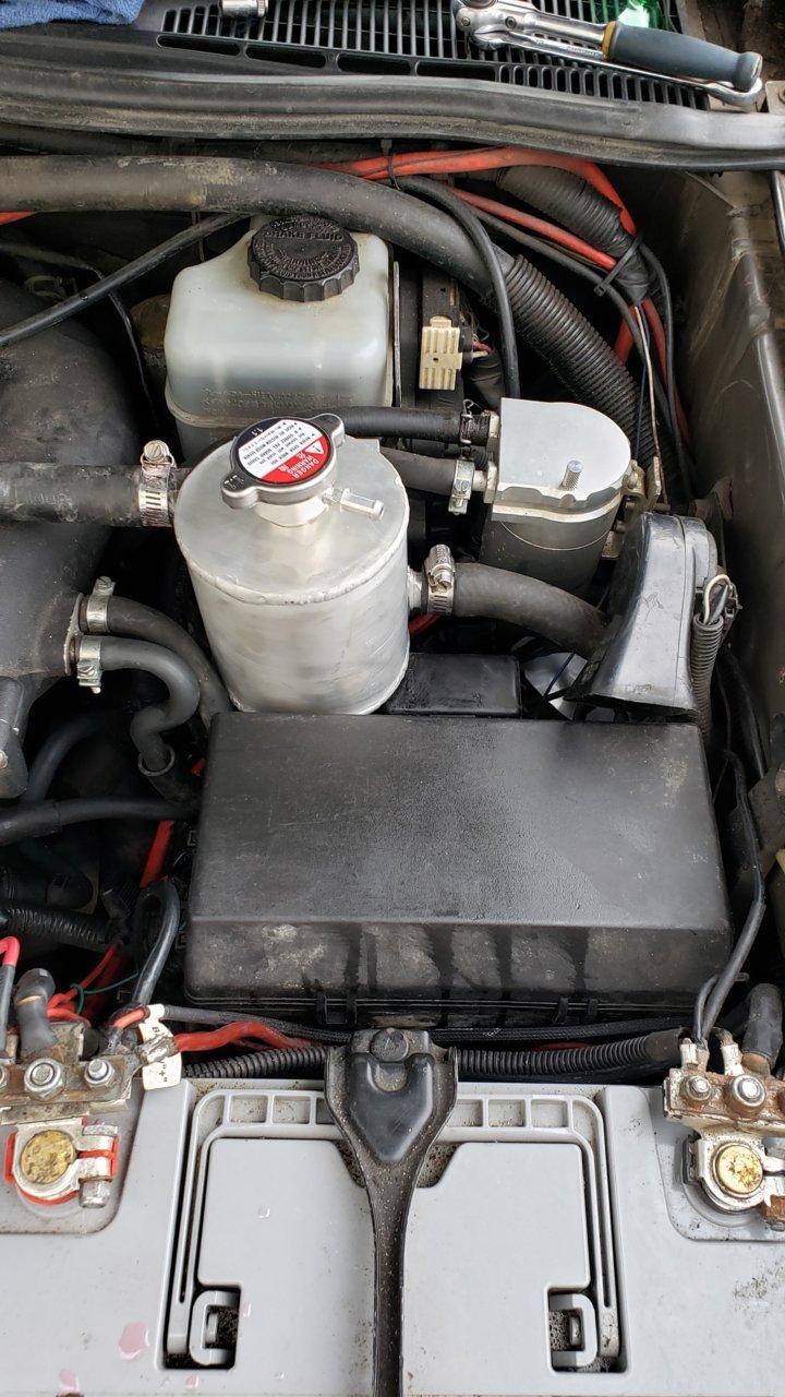

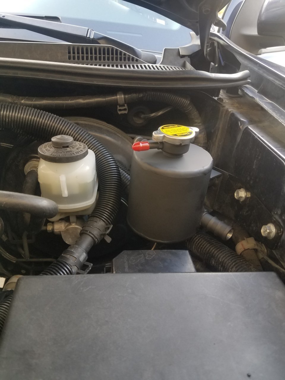

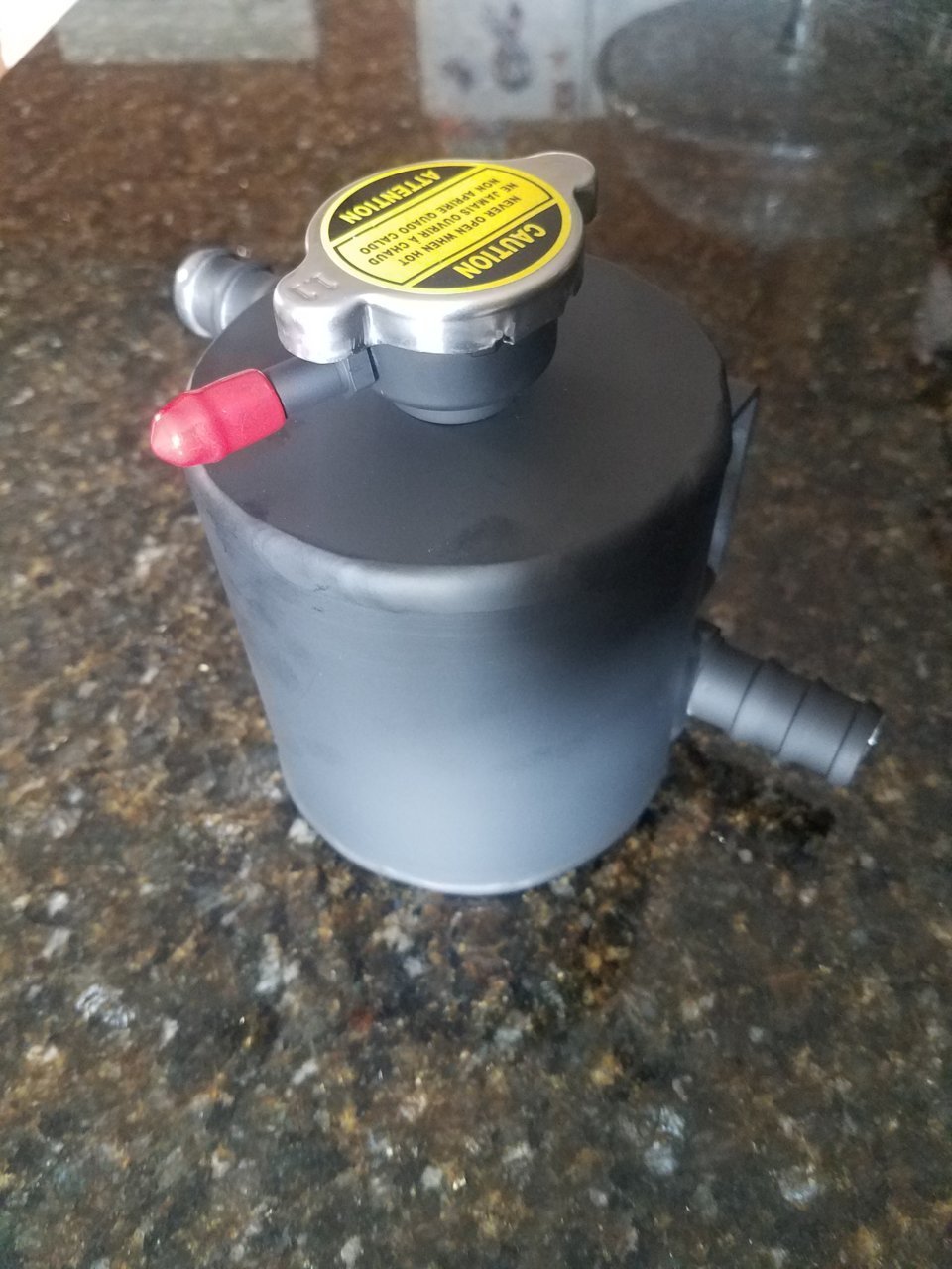

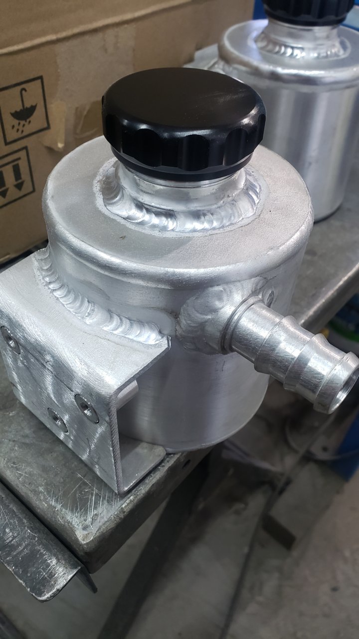

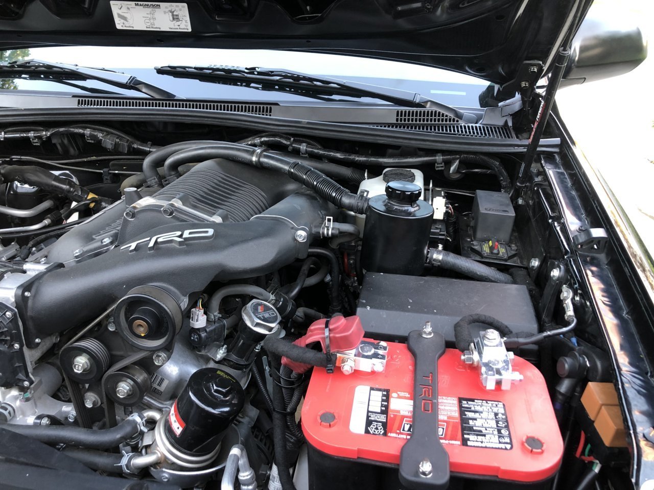

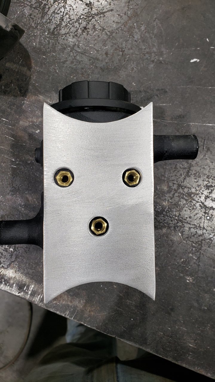

    New design
    Hey y'all - with the popularity of the Figs aluminum resi and the general dislike for the cheap Trd/Magnusson ones that constantly leak all over the place- there seems to be an interest/need for something in between.
    I'm 99% sure I'll able to do these for round 2 at $275 (round 1 was $265) cost is up with material cost
    • Factory location
    • Increased capacity (approximately 32% increase)
    • Reuse factory hardware and bracket
    • Comes with overflo barb (easily capped) run 2 won't have
    • 1.1 bar radiator cap included (15psi) run 2- 2" metal oil cap like the Figgs unit
    • Made from 6061 aluminum which acts as an additional heat sink to cool the fluid (tank sits in a cooler part of the engine bay)
    Each tank is individually pressure tested to 20 psi to ensure they are leak free when you get them. Tank comes unpainted

    Radiator cap, overflo option either 4" or 5" body.

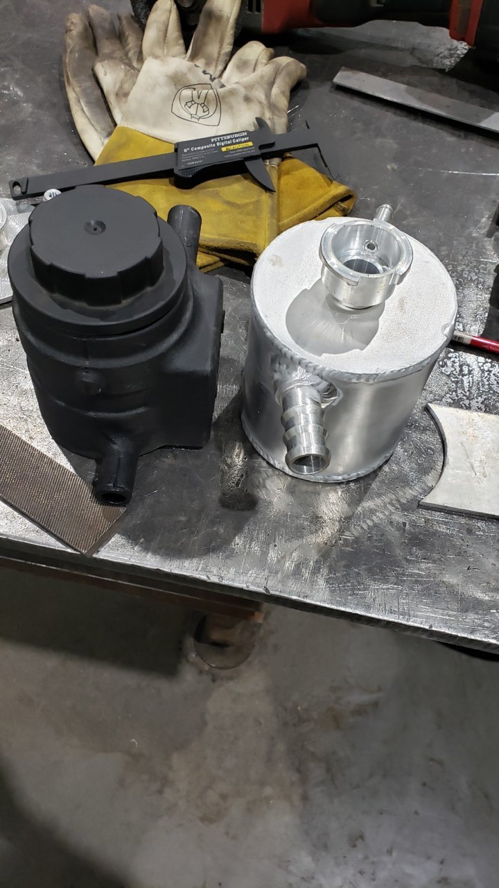

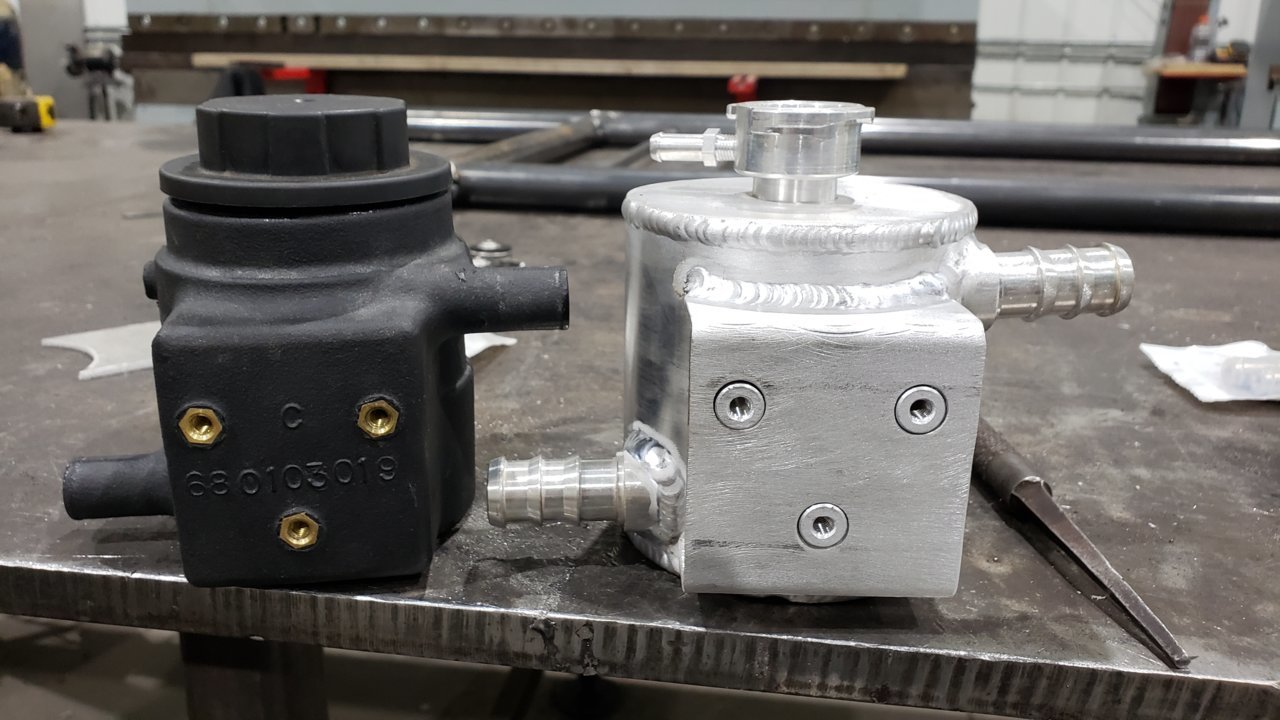

    Well I'm back from vacation and putting some work into this.
    Looks like factory supercharger uses 3/4" hoses and the 3 bolts that mount it are m6.
    So 3/4" weld in barbed hose fittings X2 (inlet/outlet)
    M6 x either 1.00 pitch or 1.25 pitch. Need to check still or might just include 3 matching bolts
    A weld in radiator filler neck + cap. Found a nice one with a 1.1 bar(15psi) cap and includes an option for a overflow tank or it could be capped.
    Factory plastic tank measures (not counting the cap) 4" - 4 1/8" tall and 3.5" wide or ~40"³ of coolant capacity
    Height and width has room to be stretched some so lets say 4 1/4" tall (plus cap) and 4" wide or ~53"³ capacity A 32.5% INCREASE in size
    I realize that isn't actual capacity as material thickness isn't taken into account but its approximate with approximate increase in capacity.
    Any feedback on this from those interested is appreciated. Currently working on the CAD parts to mate them all together.
