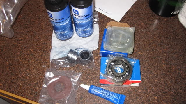

    Got my nose drive rebuild kit and rear support bearings. Hopefully done on Monday so I can get this bad boy back together!
