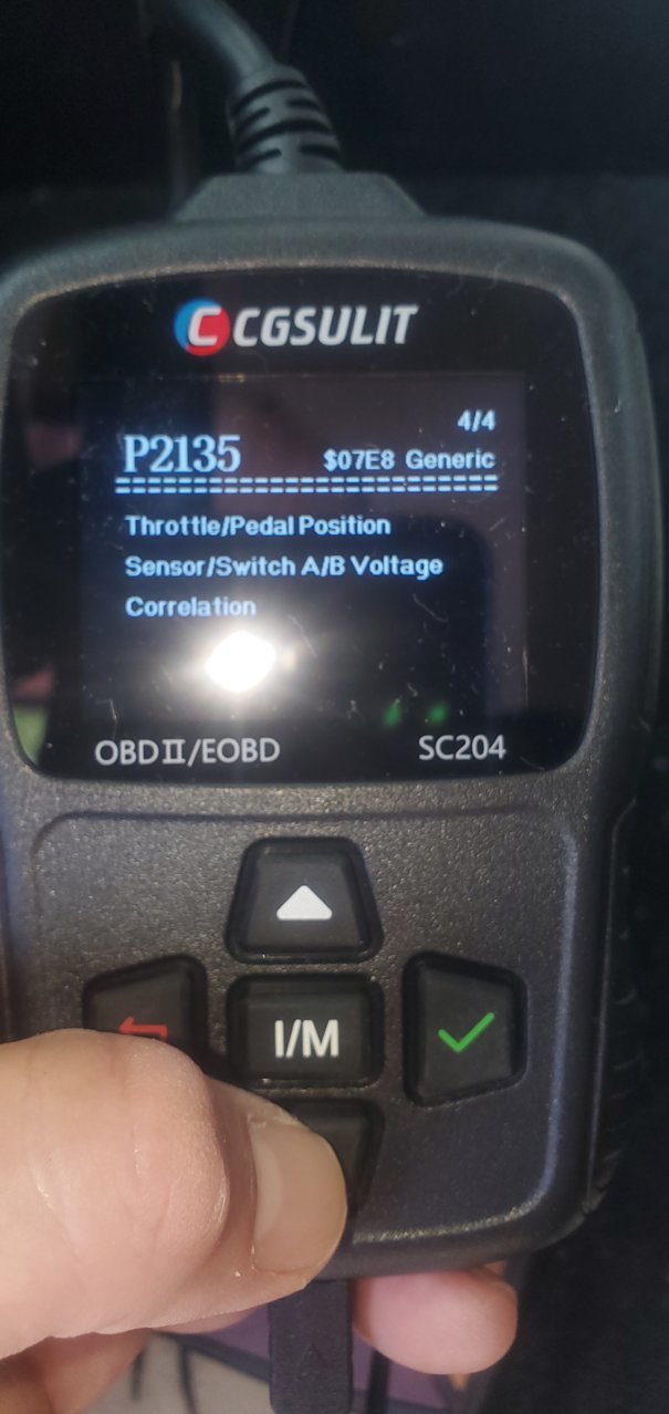

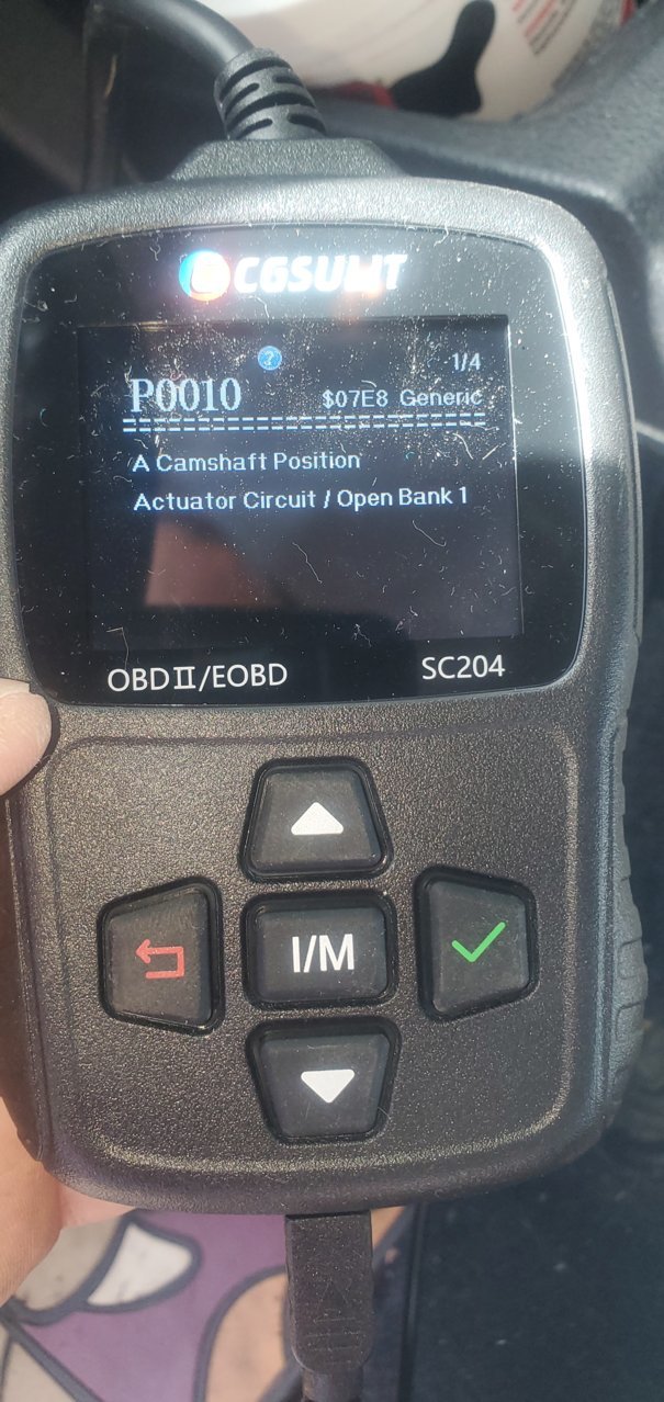

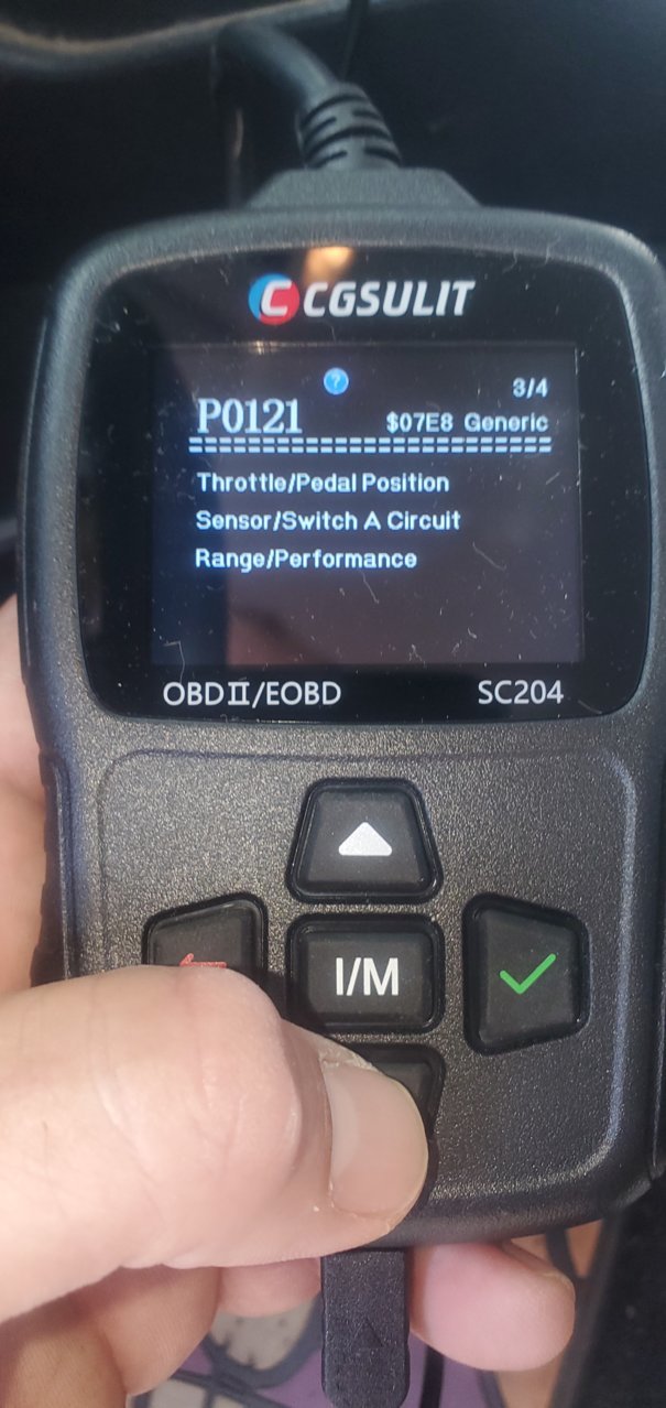

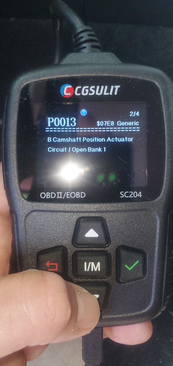

    What are the updates with any potential check engine light codes?

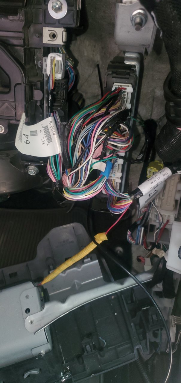

    Somethings unplugged or you cut a wire somewhere.
    I would check every electric connection on bank 1 side (I believe passenger side).
    Also make sure all your grounds are still connected.

    Im gonna go out at say sounds like some wire was touching somewhere it wasn't or got too close to a heat source and cooked it. Thats since you only put a short amount of miles on it since install and it was working shortly. Would make the most sense to me.

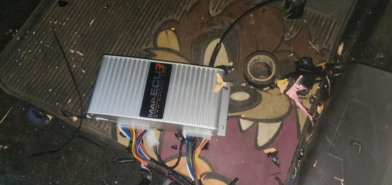

    Can we get some photos of this control box? This sounds like URD is using a piggy back ECU to get the Toyota computer to play nice and it's pissing it off. Piggy back ECU's are known to be problems back in the day before flashing was a thing. Lot of Honda guys struggled with them trying to get them to play nice. You either have something wired funky/bad connection or that control box you're talking about is messed up. Most FI guys on here flash with VF Tuner which allows full control and adjustment of these trucks. It's the only way I would use to tune FI on these vehicles.

    Ok
    Heres a pic. Manufacturer said codes were telling. And i should wire it back to normal. No tuning and it would run rich. Same behavior, sounds like a model t attempting to start (but doesnt) with the same codes. Ive found severall smaller sensor fixes for crankshaft codes, but im afraid the reality of the situation is bad. Help.

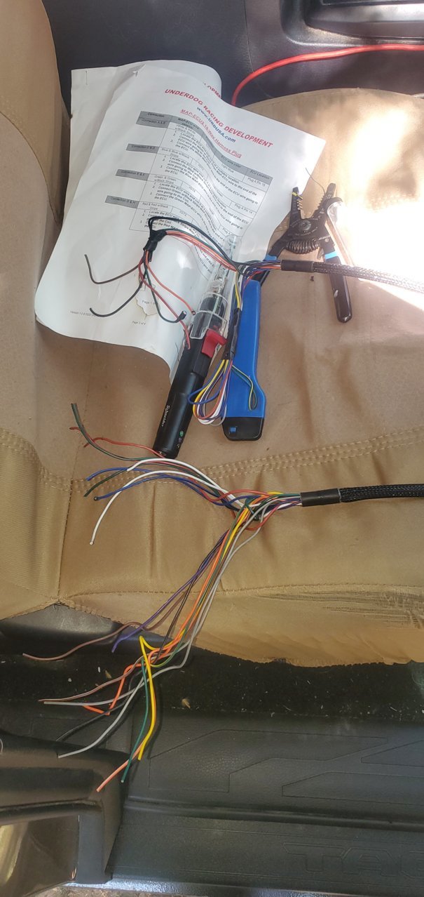

    There is a 16, 18 pin harness in that new ecu
    And ive seated /reseated 1/2 a dozen times. And its still giving me the same codes and startup fail.

    1/2 those wires arent used.
