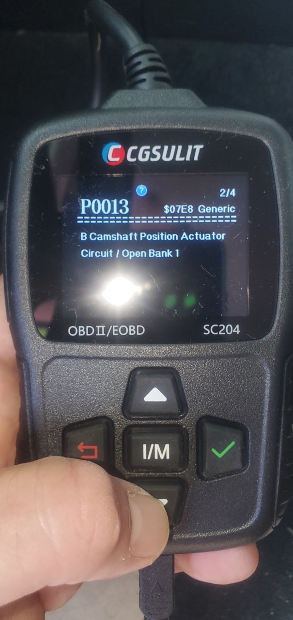

    Well with the error codes a crankshaft control valve is listed and a throttle position switch is also. Its like 80 dollars worth of parts. I just wonder where i could have gone wrong wiring it.

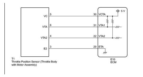

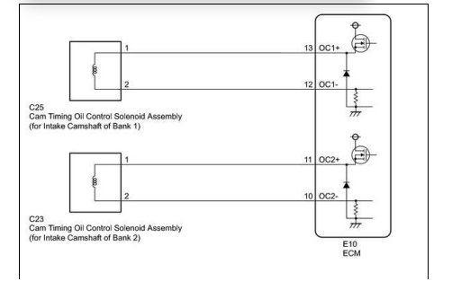

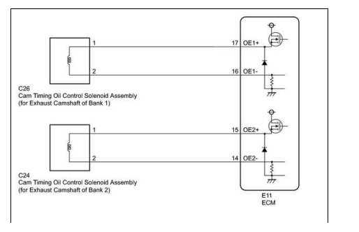

    start checking ECU wiring on these pins.
    Throttle codes:
    pins 31, 22
    Camshaft:
    pins 10,11,12,13,14,15,16,17
