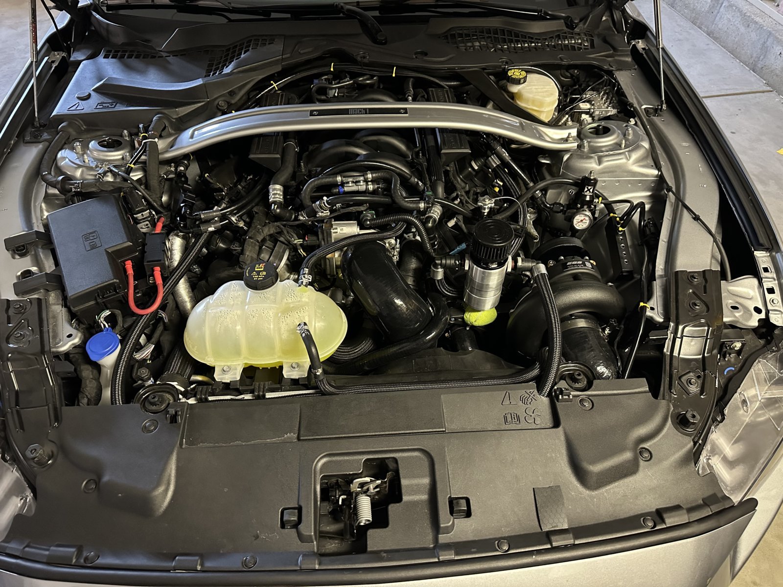

    Supercharged Mustangs FTW.

    I see that that little centrifugal doohickey there.
