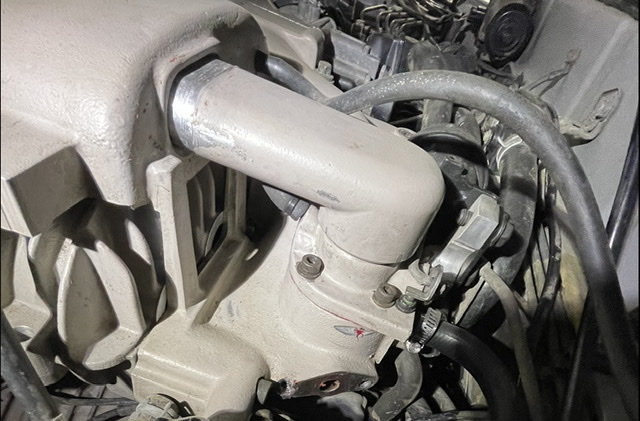

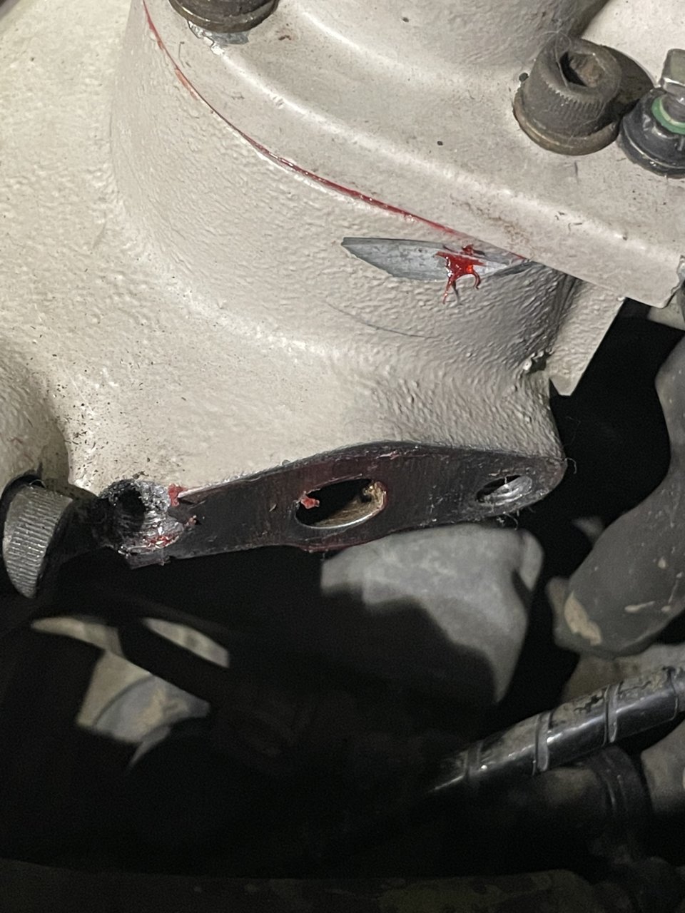

    Hey guys, looking for some insight here. I have a gen1 grey Supercharger. I was just prepping to install the 7th injector kit and removed the EGR blankingplate that was installed. I cracked the left 13mm bolt and noticed a hairline crack opening up… now with it out, the piece has broken off and fallen (not in the charger)
    Does Anybody know if there are replacement parts for this? I ran a piece of haywire in, and this hole continues into the body of the SC. That bolt won’t even thread in now cause of what is missing. At a standstill with a dead taco in the garage… :annoyed:

    Damn, that looks like a big piece its on as well. Sucks man, sorry. Hopefully it can be repaired.

    Yeah, I actually had a buddy msg me that Jon Bond Performance has the whole manifold piece for 299… that might be my only option me thinks.

    cheaper than the other option i could think of.. which is weld it back together and redrill and tap.

    I gotta agree with buying the manifold piece if indeed it can be bought yet.
    That sure looks like a casting it might be just the picture.
    Casting flaw the just decided to break now .
    Your sure those are M13 bolts for a EGR block off plate and not M8
    Will the EGR ever be installed again?? Quick fix braze a stud in the broken hole bolt the block off plate on.
    If you can`t braze epoxies have vastly improved in the last 20 years if you need up and running.
    Good luck !!

    They seem to be the correct size & thread. I’m able to run the new ones in no issue. Well, I’ll never have the blanking plate installed again unless I really don’t want to keep the 7th injector kit.
    I hope to have it here by the weekend coming up.. I’ve started to review the 200+ pages on the 3.4l sc thread trying to figure out exactly how to get this back manifold swapped out.. so much reading lol

    M13 bolts are just slightly bigger then 1/2" Those must handle lots of stress to need to be that large.
    It must be the picture that makes them look smaller.
    Good luck

    I’ve actually found a bolt about 10mm longer, same pitch and thread. Got it in there now, and hit it with some jb weld like some have suggested.
    Seems to be holding now. I may just cancel my order of that housing .
