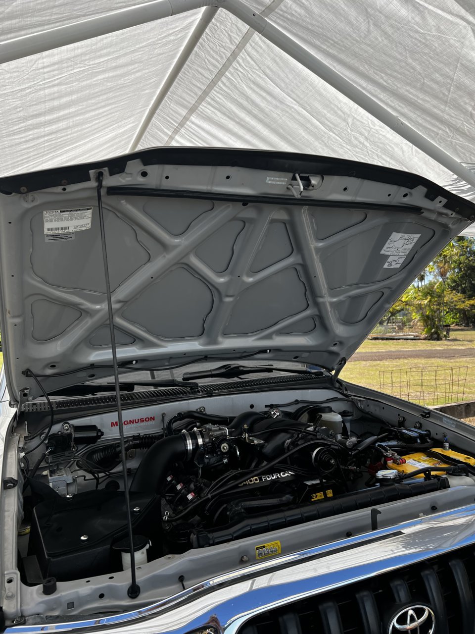

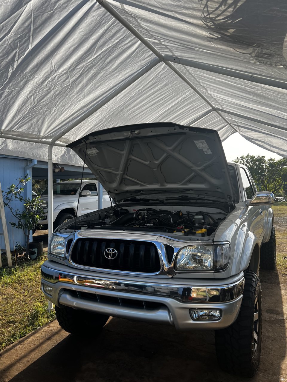

    4DA33463-7BD3-47B8-B0E8-B0516AC50428.jpg F117741D-B40E-4DBF-A1B7-33CFC0D6762A.jpg Fresh Magnuson Supercharger installed along with 170 degree thermostat for now
    Will be doing URD 7th injector kit as well as Wideband and Boost gauges next week. i will try to provide pictures regarding installation
    Meth/Water injection will be achieved in the future.
    Install was fairly easy as the instructions provided by URD was very detailed and lots of pictures.

    Awesome! If I found a deal for a SC er, I'd be doing the same .

    That is one squeaky clean engine bay!

    So as someone who has never driven a supercharged 3.4L before, how does it feel to you? Much faster, more powerful?

    Are you going to do any fuel mods? Like fuel pump and injectors?

    Getting power out of the 3.4 is expensive and the basic supercharger is just the beginning adding 40-60 hp depending on your elevation and pulley.
    Stock rear wheel is probably 150-160,
    depending on pulley size and elevation and mods you can max that number
    to 300 rear wheel and the transmission, clutch and other parts are still happy.
    With a turbo you can go further 350hp but the clutch with be the 1st part that will not be happy and your limited to boost because the crankshaft is not forged
    So there is a huge difference or a nice difference in power depending how far down the rabbit hole you go.
    The haltech will start your power off at 2000rpms while the stock ECU your power comes on at 3500rpms. For me the haltech alone gave me an additional 62lbs of torque and 35hp more in the midrange over stock ECU.
    Every setup will be different depending on what your mods are and elevation which effects your boost number
