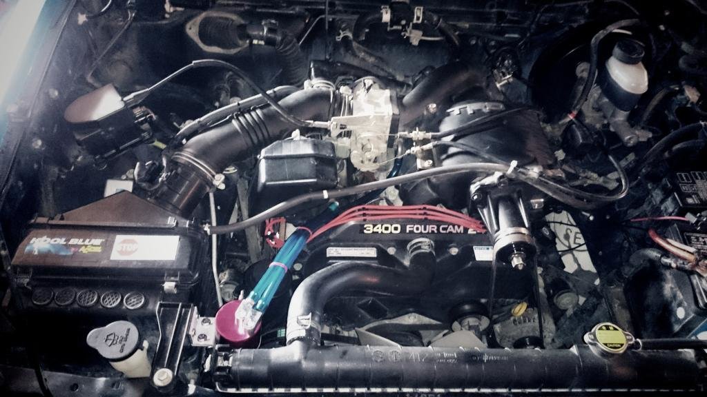

    Well last nite i put in my Supercharger, Easy peasy!
    I bought a universal a piller pod holder and put my boost gauge in there,
    also put a cheapo catch can in and the colder denso plugs.
    Seems to run good! no issues whatso ever other then the SC belt seems to ride towards one side of the pulley?
    I also did a coolant flush and installed the colder stant thermostat.
    The tranny kick down cable is extremly tight!
    Anyone got pictures of how you made your engine bay look a little nicer? i wanna reroute some of these hoses.
    It sure seems to pull harder and i love the sound!

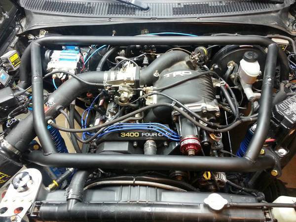

    Here is how I have stuff routed under my hood. Enjoy your blower!

    damn thats nice!
    everything looks similiar . Your kickdown cable isnt as tight?
    i need a fan schroud!

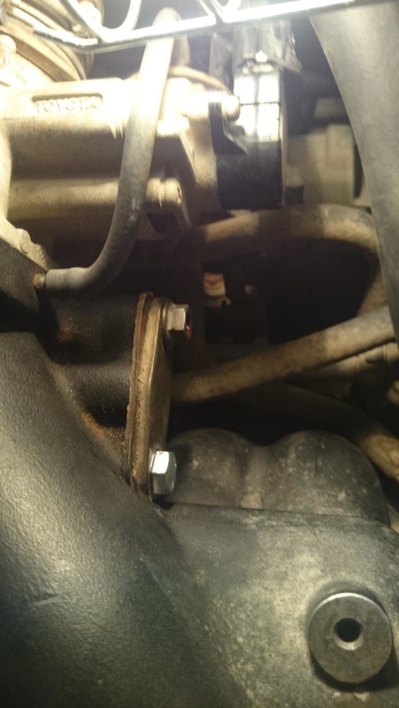

    ANYWAYS!!! i was having some driveability issues. It would not make any power. it would barely do 110km/hr on the highway it just felt like it was powering out!
    So i looked it over. Found a vacume hose had come right off. well it was split. so i fixed that. figured that was the problem. drove it some more and it still felt like it had no power compared to the first nite i drove it with the SC.
    So anyways i was looking it over and found that this block off plate had a bolt missing and was just dangling there.
    So i took it off found a new bolt put it back on with locktite.... took it for a drive and it was idling rough and still had no power? so this morning i run the codes...P0171 and P0174. Lean!!!
    Anyways upon looking it over. i put that block off plate back on upside down!!!! so i fixed that hopefully it makes everything work better. I have never cleaned the maf. Any at home products i could use on it? i dont have maf cleaner. i do have electrical contact cleaner thou?
