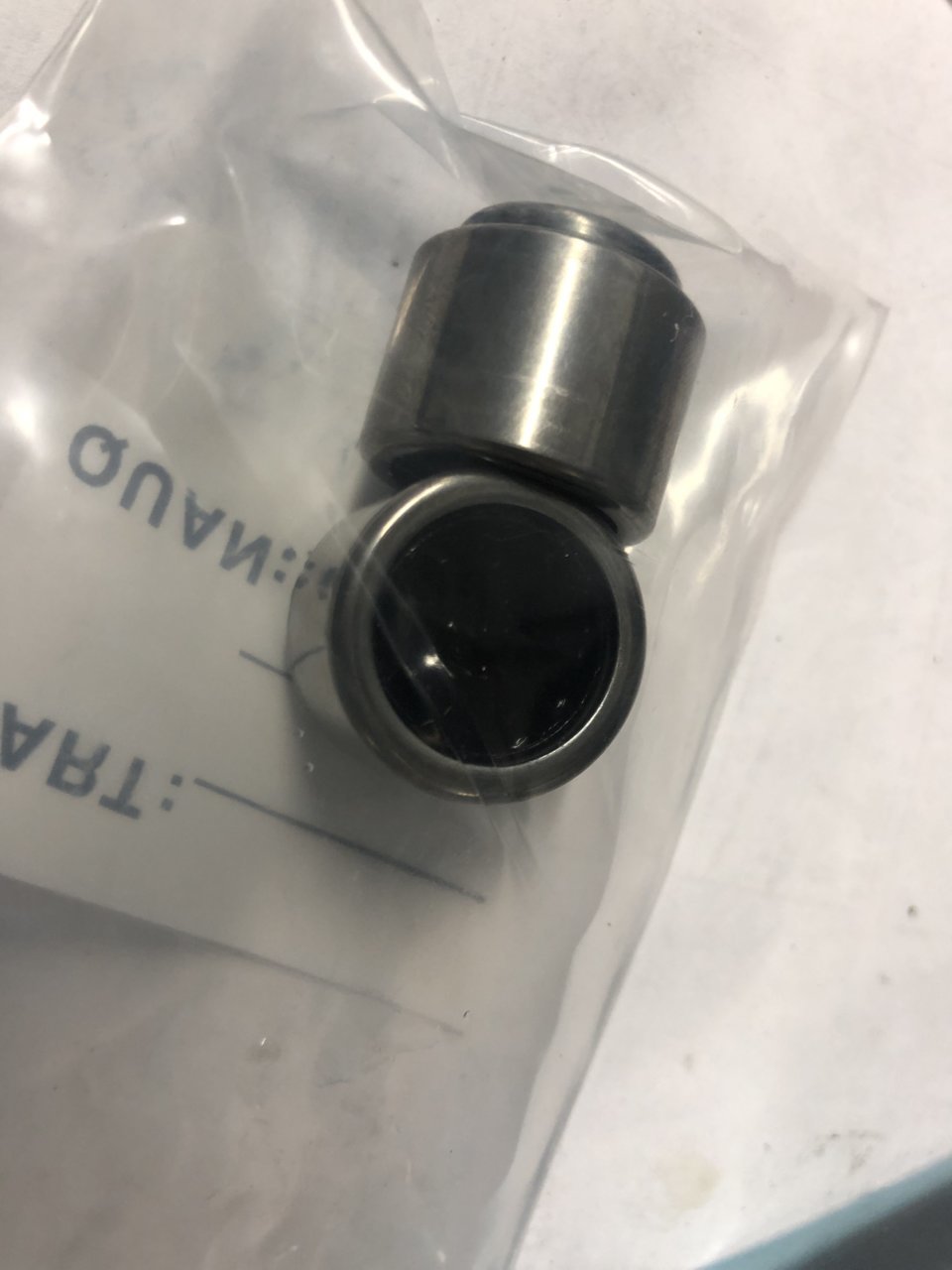

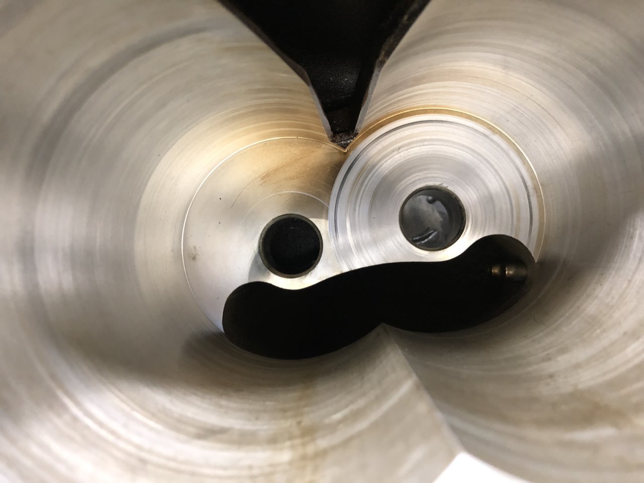

    Has anyone replaced their impeller needle bearings? I have mine apart and figured I would know because it seemed easy enough. At least easier than on the vehicle. Problem is that I put a blind hole bearing puller on them and feel like I am beating the crap out of them. I can’t seem to get them out. Any tips appreciated. I tried heat on the backside but not a lot.
