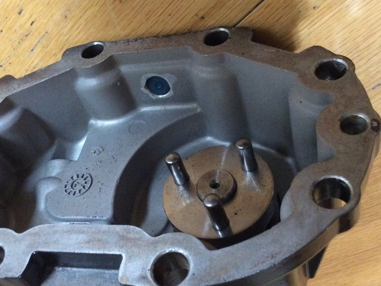

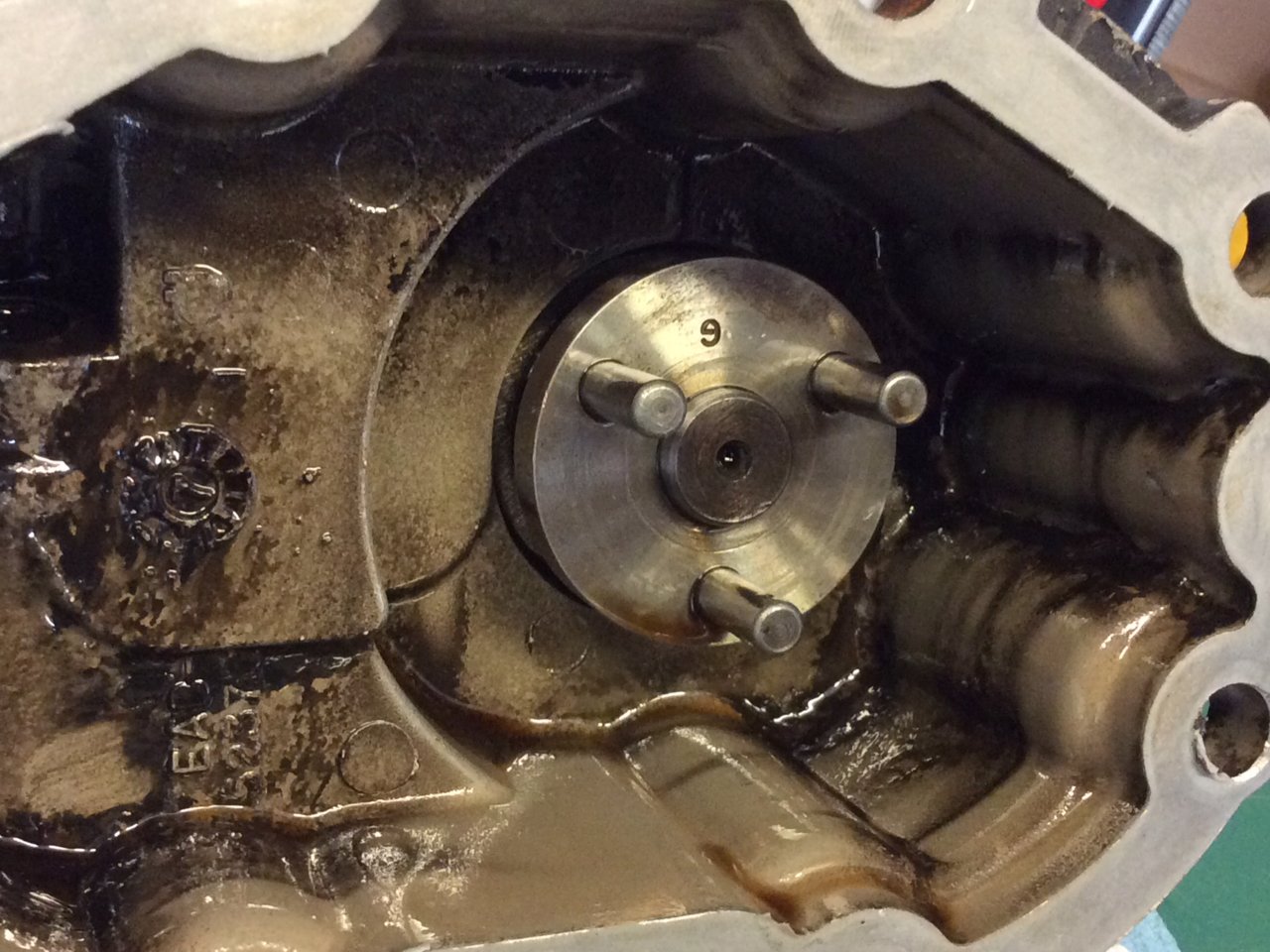

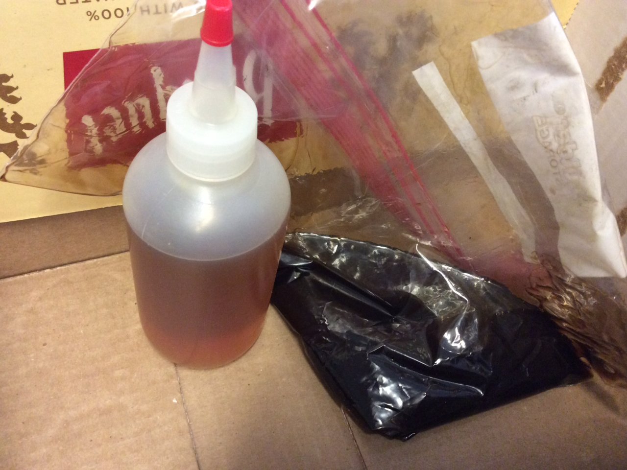

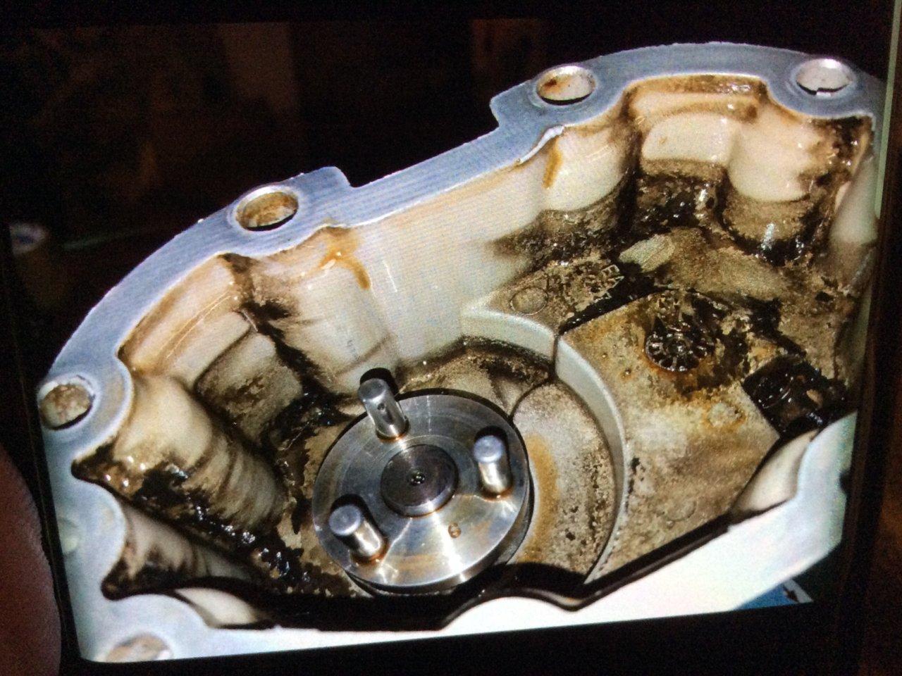

    This is what my supercharger oil looks like at 40,000 miles and why it’s better to change it sooner then later.
    Oil was BLACK and smelled horrible!!!
    Inside was coated with a black caked on coating.
    I needed a soft brass wire brush to remove most of the black deposits.
    Waiting till 100,000 would be ridiculous
    If you take the snout off you can do a deep cleaning, you can but a plastic bag around the snout and drain everything before you remove the snout.

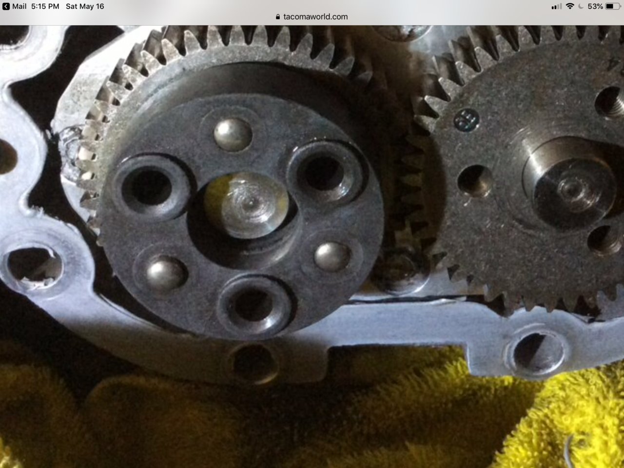

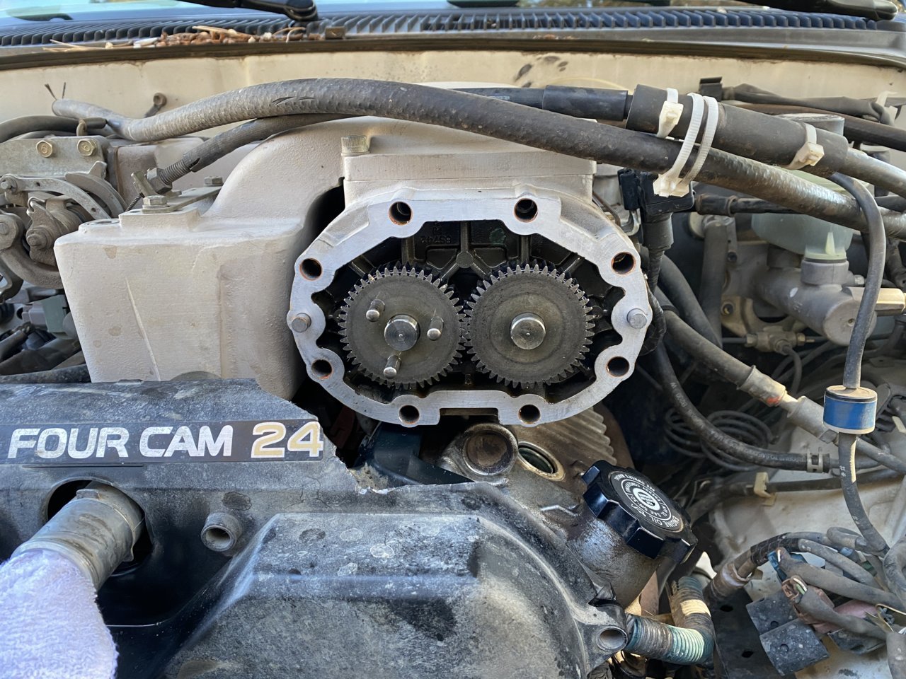

    For anyone still following this post. Got the oil changed out this morning. Took about 3 hours. The worst part about it was the timing belt cover being in the way. After I removed the front part of the SC I trimmed up the cover so it wouldn't be a issue later on. The oil smelled horrible, i'm guessing it was original.

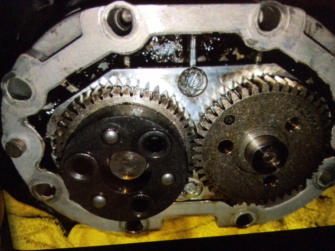

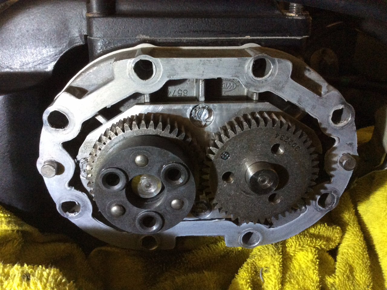

    Good job,
    Did you have a threaded hole drilled in the snout to fill it from the top?
    Also make sure the rubber coupling goes on in the right holes as shown in this photo there’s a right way and a wrong way,

    Mine doesn't have the hole on top. I tried sticking a tube up the fill hole to suck the old oil out but it didn't work. And yes, I noticed the orientation of the coupler when I took it off the first time and made sure I reassembled it correctly when putting things back together. If I could have sucked most of the oil out of that hole I probably wouldn't have and to pull everything apart to get the old oil out. Kind of bad design on their part.

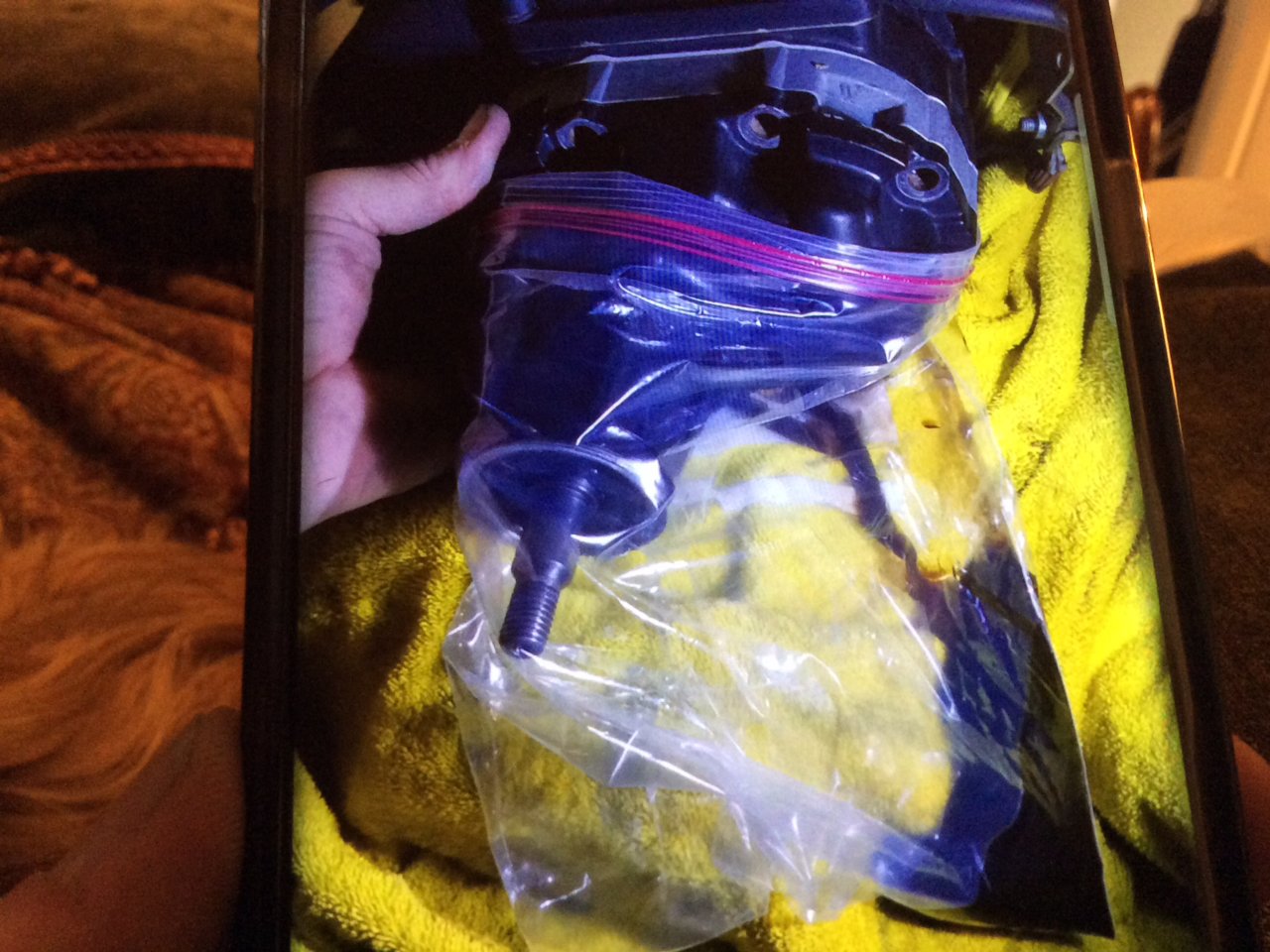

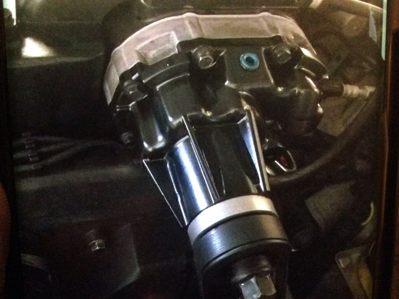

    V6 5sp,RegCab,TVS1320 Supercharger, 56mm pulley, methanol injected Haltech ECU, AC Tvs1320 supercharger,(MUST DO) every 125,000- 150,000 needs rebuild Projector headlights HID 5 speed manual Amsoil for all drive train Smaller 56mm custom pulley, (MUST DO) 2004 DESNO fuel injectors, zero ping ping, 2004 side door mirrors Dick Cepek Rims, Michelin tires LTX, ATM Pathfinders Dynopro ATM ( that last 100,000 miles) Now running Dynopro ATM mud and snow tires KN cold air intake Cat back dual exhaust with ss exhaust tip, Raised exhaust tail pipe to 2" below body line Optima*dry cell battery,red top Alpine sirius radio, 200 watt amp, focal is165 split door pod speakers Focal door speakers Subwoffer behind seat Viper alarm, Electric Locks Dark tinted windows, bucket seats corbeau lg1 Tacoma Rubber floor mats TRD fender extenders, Bilstien shocks, King shocks JBA UCA trailer iv hitch, electric brake control, Drilled slotted brakes, High carbon steel (MUST DO) EBS green stuff 7000 series pads(MUST DO) TRD engine oil cap TRD stick shift, Marlin crawl shift kit. Rear sliding window 2002 4Runner functional hood scoop cut into Tacoma hood, 4Runner dual overhead map light Gentex Auto dim + Compass + Temp, garage,rearview mirror Snow Methonal kit stage 2 Custom 3 core aluminum radiator Linex bed liner Haltech stand alone ECU, Intake supercharger gauge. Stainless steel brake lines, Custom leather wrapped steering wheel, Haltech stand-alone ECU,
    Yup, well next time just take the snout to a machine shop when you have it off and they can tap a butt screw for probably 45.00 and oil changes will take 5 minutes
