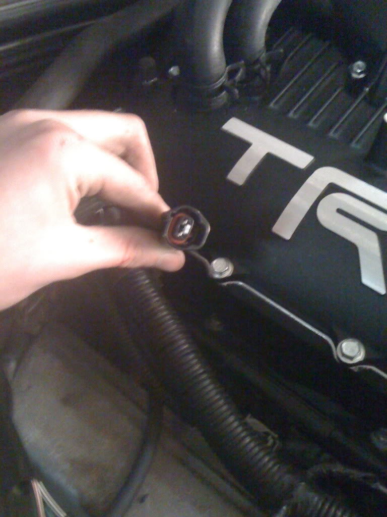

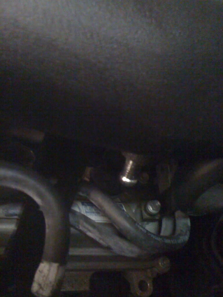

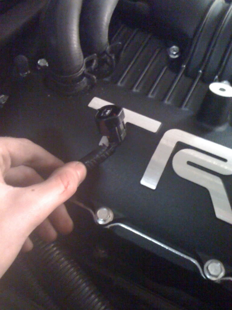

    Hey everybody, for the past two days i have been working on putting this supercharger in and finally i am done, but several things are left unanswered for me.
    1. What hose connects to this, this is on the driver side closeset to the steering wheel.
    2. What does this plug into, it is on the passenger side on the edge of the engine block

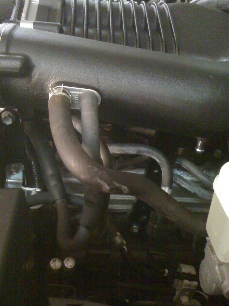

    3. When i finished i put in a gallon new antifreeze and about 3/4 gallon of water. Is this too much? Also in the instructions it said to turn the key to circulate the coolant, but when i did the inner cooler pump came on and made a really loud whining. Is this normal? If you want i can get a recording of the video in about an hour.

    That cable that you have that's not connected to anything... doesn't connect to anything. That is the connection for ACIS on the stock air surge tank. Its not used on the S/C.

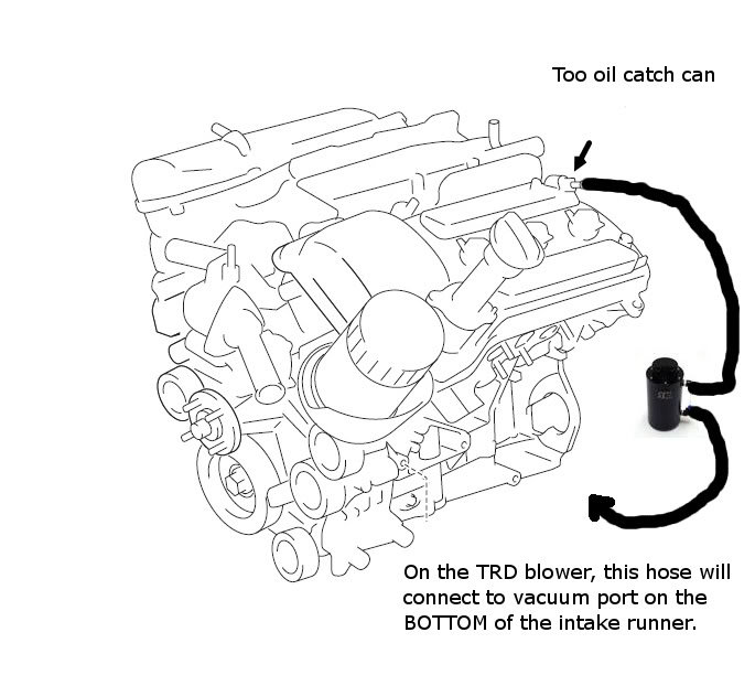

    That nipple that is missing a hose is for the PCV system. There is a check valve on the driver side valve cover below the blower, that is where the hose routes from. Check Valve -> Nipple on the underside of the blower.
    Yes its normal for the intercooler pump to make that noise. As you circulate coolant through the system, you'll fill it up till the fill port on the reservoir is submerged (you'll get a whirlpool effect when the pump is running).
    Here is a diagram that I made while illustrating proper catch can location for the blower.
