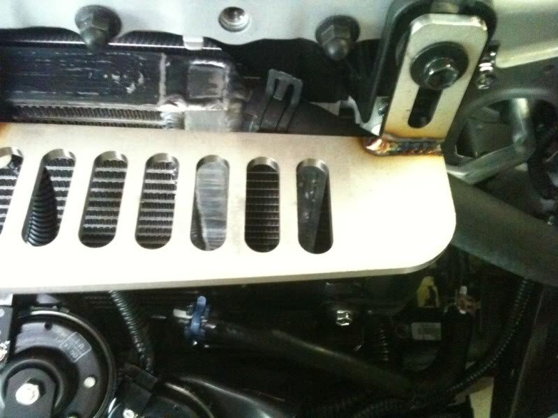

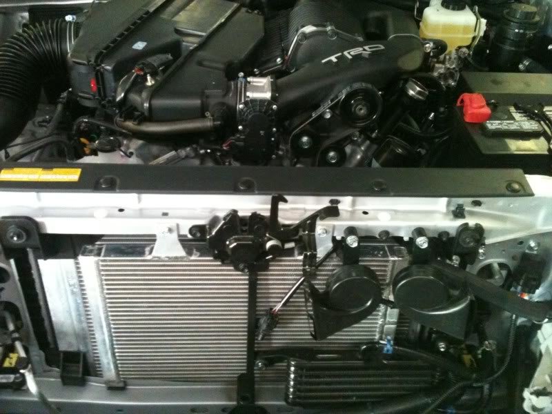

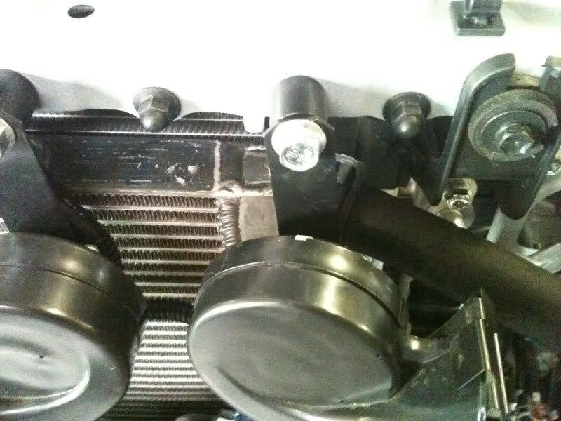

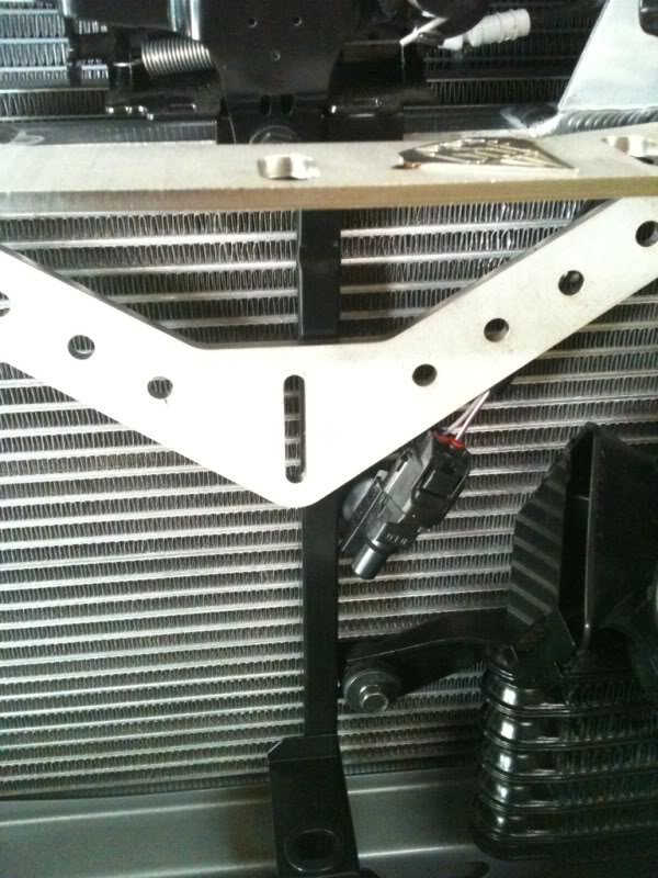

    here is some info on how the light bar fits with the trd supercharger the kit adds another radiator for the a2w internal intercooler and changes the center brace you may have to make a little bracket for the lower bolt
    the cooler sits about 1" further forward then the radiator but make sure your lights clear i dont think that will affect the hella 1000s it will also clear the output hose on the right in the lower position
    see the center brace it is alot smaller but just make a small L bracket for the side
    they space the horns but they are relocated anyway
    here is a pic from the front with the grill removed
