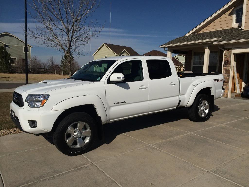

    This is mine.
    I bought it on Monday. I looked at the one I referenced about two weeks ago. The sellers name is Adam and I'm Jeff, hence my username. The one I looked at has 28K on the odometer, not 23K. It was a nice truck and was just trying to help you out. If it there had been any red flags, I would've said so. I think it's worth you time to go look.
    Also, to the best of my knowledge, none of the SCs are 'factory' installed as your OP states. They can be dealer installed which gives you the full warranty. If you install it yourself or have someone other than the dealer you get a 12 months parts only warranty.
    I'm considering doing my new one as it's a really nice improvement. Not sure it it's worth the $7k to have done by the dealer. Which is really the only way to do it on a new/newer truck. The advantage to buying it used is the original owner takes the depreciation hit as the SC doesn't really help the resale value in relation to the initial cost. None of the car appraisal sites even have this as an option. IOW, you can get a bargain when buying a used Tacoma w/ the dealer installed SC. But I would also have the concerns you may have.
