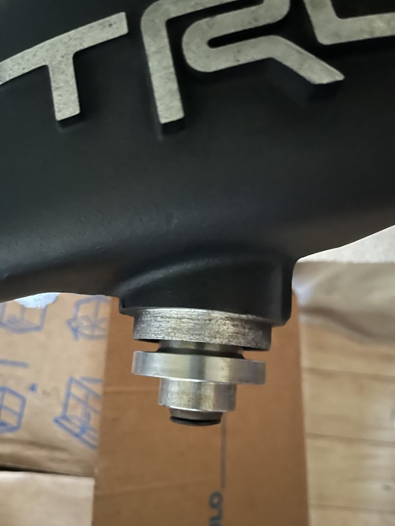

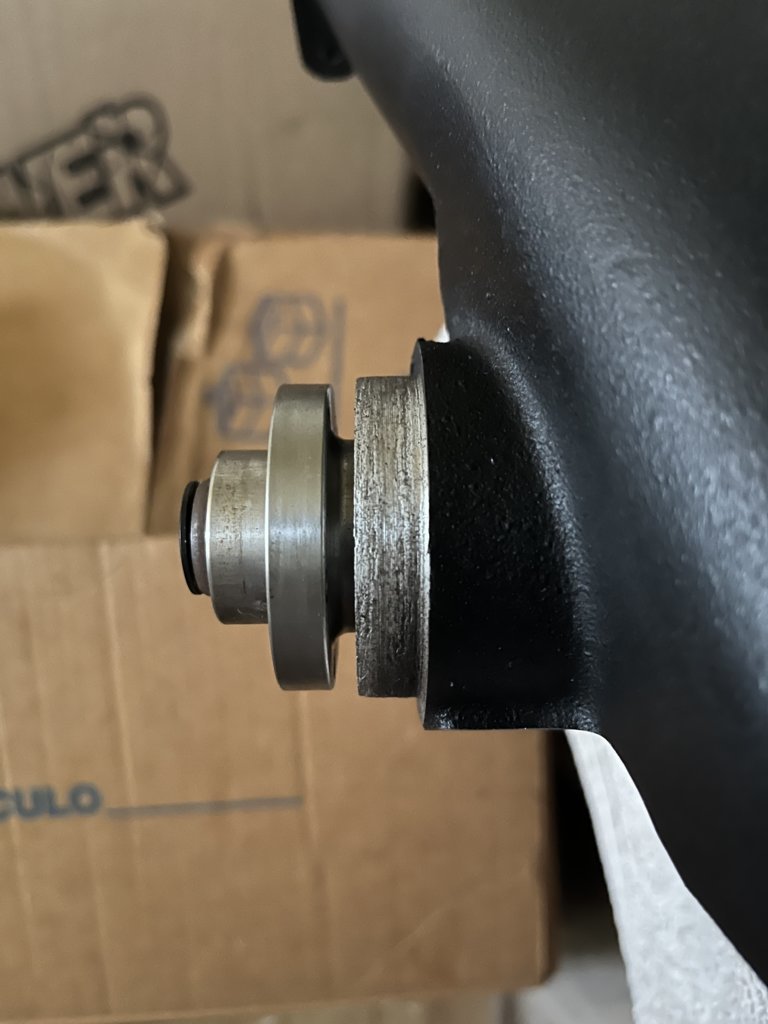

    Anyone remove the pulley hub off the snout shaft without pulleyboys special tool and adapter plate? Their website says that's the only way to remove it. Anyone use the usual 3 jaw 5 ton puller? Going to do supercharger maintenance and need to remove it. Thanks in advance
    Looks like their tool won't work with our superchargers. Anyone have a pulley remover tool they recommend?

    Just a heads up for people with the Quickchange pulley system. If you need to remove the hub for supercharger maintenance there are no real pulley removers that will work with our E90 superchargers as there is not enough room behind the hub to use an actually pulley remover. Looks like I will have to try to remove it with my 3 jaw puller possibly destroying the hub.
    On a different note: I did reach out to Gadget at URD about his quick change pulley hub which is different from the pulley boys hub and he said that his quick change pulley hub was not meant to be removed and it will definitely be ruined/destroyed upon removal and you will need to buy another one.
    I will update when I remove the pulley boys hub, hopefully it will be a successfully removal.

    A bearing separator puller works perfect for Pulleyboy and Smooth flow hubs.
