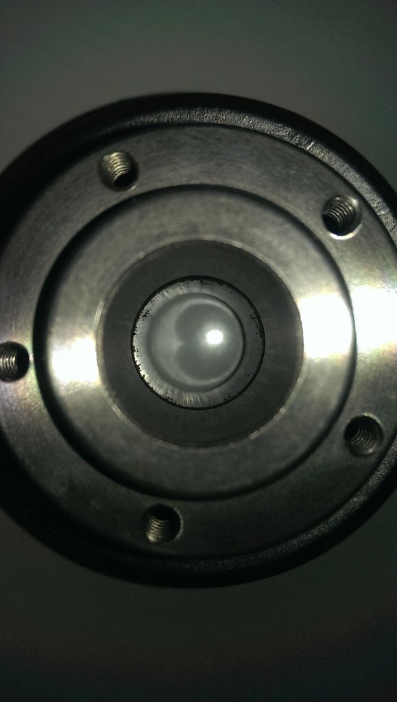

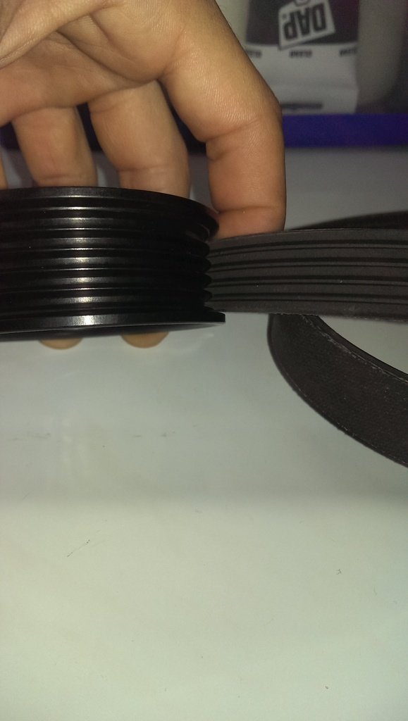

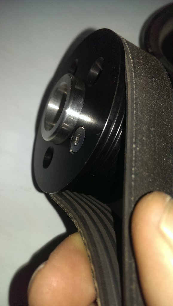

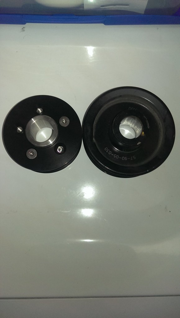

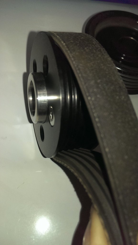

    I have arrived with some excellent news.
    I took some measurements of the old 3.0 stock steelie pulley I kept and compared them to the new quick change pulley hub. They are as follows:
    New pulley hub OD width (Most important measurement!):
    1 13/16"
    Stock 3.0 OD width:
    1 13/16"
    New pulley hub length:
    1 1/16"
    Stock 3.0 length:
    1 1/4
    Design: Stock 3.0 pulley/ new pulley
    5 rib
    Now there is one thing which I am not accounting for here which will play as a factor at time of the hub being installed, the back of the hub which seats at the very back of the shaft (if you are looking at it dead on) is raised compared to the stock design. This factor may be in play in order to take up for the overall 3/16 length shorter the hub is vs. the stock pulley length in order to allow the pulley to sit at the same serpentine belt offset that the stock pulley sits at, which is supposed to be .4". Theoretically, if what I believe is correct, at the time of belt install, this will allow the new pulley to line up perfectly with the rest of the idler pulleys and crank pulley.
    EDIT: Just checked it. The hub face lines perfectly center at the middle of the middle of the old stock pulley while it would be a dead even match at the bottom out once all the way in the shaft. This will allow perfect center at the time of the bolt on pulley's installation. We are good to go!
    I went ahead and took several pictures so you could see the stock vs new pulley and hub differences. The good news is that after taking these measurements, I determined this hub design will allow for an easier press on which will require substantially less pressure on the shaft and install tool than what the URD pulley's have (You almost feel like the threads which screw into the shaft are going to break as you press it on, and sometimes, they actually DO). In layman's terms, the chances of you breaking the threads of your install tool inside of the shaft during install due to extreme pressure during press on is now minimal. Being that the hole of the hub is machined perfectly, where as supposedly the URD one is machined as well, but then uses a match to size drill bit drilled through it to put it at exactly the size it needs to be.
    What I am saying in short is that this install will be CAKE and require minimal effort to install, similar to the stock steelie press on size compared to the press on URD pulley which requires baking or boiling the thing in order to allow the hole to expand followed by a very speedie timed press on before it shrinks and will not allow anymore movement. An ace in the hole all around for my research! Anxiously awaiting to install this awesome setup in the coming days and start having some fun!
    2.5 vs. 3.0 size comparison
    OD width's of hub lined up to stock pulley width (don't mind the debris on the old pulley):
    Shots of belt wrapped around pulley:
    Belt side by side to new pulley profile:
    BTW, they come direct from Pulleyboys with a black pulley/ silver hub as a default. ;)

    Ok, I have question. I presumed these were keyed- what is preventing this thing from rotating on the shaft or is that reason for the press fit. No locking bolt? In other words if it is easier to put on- could it lead to spinning on the input shaft?
  9. Jun 22, 2017 at 8:46 PM
    #29
    12TRDTacoma
    12TRDTacoma [OP] Powered by Ford, GM, VW, and Mercedes
    Aug 20, 2012
    #85133
    16,670
    Rob
    Concordia
    12 TRD Sport DCLB 4x4 Supercharged
    Boosted
    I was waiting for someone to voice concerns over this. No it will not spin easier on the shaft nor is more likely to. It is not keyed. The hub is a press on just like the press on pullies. The only difference here is that you have a much quicker change out time over press on designs, and a simple allen tool is all you will need once the work is done to swap out pulley's from there on out. The stock pulley believe it or not comes off fairly easily and is easier to press back on compared to the URD pulley because it is machined to be the right fit, unlike the URD pullies which are machined, and then supposedly have some sort of XL custom drill bit run through them to make them "the perfect size for press on." Trouble is, for whatever reason, they all go on too tight cold, which requires you to heat them up by boiling them in water, or baking them. You may refer to the instructions on their website if you would like.
    Regardless, that information alone tells me that they are not the same OD width as the stock pulley. Have you ever heard of a stock pulley spinning freely or slipping on the shaft? No you have not. Because they are press on, and unlike URD pullies, they are machined the correct size to be able to press back on if they are ever removed, without the chance of seizing mid install or causing the bolt of the install tool which threads into the shaft to snap because they do not have ridiculous amounts of pressure being exerted onto them.
    You are more likely to hear a story of a belt slipping on the pullies because they have either stretched, or something else is going on as an underlying cause.
    I hope that makes sense.

    As long as the new hub has enough friction to overcome the blower resistance- all is going to be well. Appreciate you allowing us to tag along on this journey of exploration.
    Biscuits and 12TRDTacoma[OP] like this.

    I have no doubt that there will most definitely be enough friction for the hub to overcome the resistance being applied to it. Remember however, the blower parasitically does not draw a whole lot of horsepower from the engine itself. That in itself tells you that the latest gen 5 roots blower being made by Eaton which is the one we are sporting is not only very efficient for a roots design, but also very well designed and thought out in order to be so.
    Stick around, results are to come soon! If this works out well, which up to this point I see no reason as to why it will not, I would be very happy to see a good majority of the blowers anonymous group of Tacomaworld to make the switch as well so they can start to enjoy other tuning and modification areas of their setup. :)
    If it does work and I end up getting a lot of interest, I will (much like the carrier bearing mod) push for a group buy on this company!

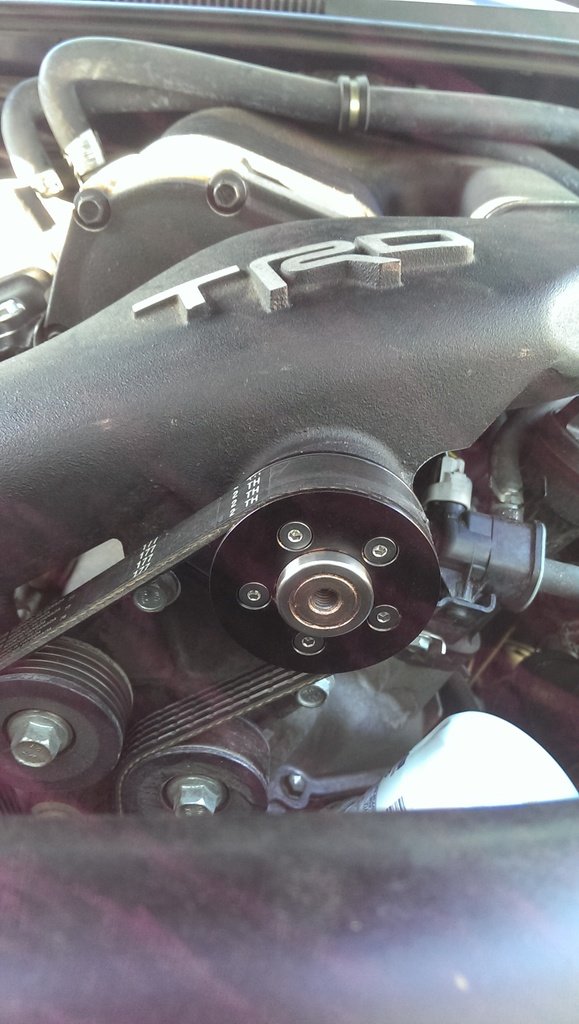

    Guess who's back?!
    Final update:
    I am pleased to announce for those following that the mod is complete and went through without issue. I am now running a 5 rib Qwikchange pulley system, 2.5" pulley and currently boosting on 9.5 psi on a 92* F day. I'll probably hit 11 or 12 on a cold day.
    What I initially thought was that they idler pulley right below the blower pulley to the right was off center, but after looking at other setups I have found that what I am looking at on mine vs everyone else's is the exact same. No additional mods are needed to make this system work unless you go down to a 2.7 and below. You may need to get a size down smaller belt. Dayco PN: 5PK1765 otherwise, the chance of boost loss due to belt slippage exists.
    EDIT: Oh and one more thing, My initial thoughts about the hub being pressed into the bearing. It went on tough, as it should, but went on no tougher than the force it would take to press on the stock 3.0 steelie pulley. With saying that however, do yourself a favor and coat both the shaft and the hub with your favorite color anti seize grease. Good insurance policy to make sure things don't freeze up and go on a hair easier.
    Enough talking. Pictures!!!
    That is all I got for now. I was too busy installing it and getting my hands covered in anti seize. As you can see the pulley and hub still have it on it.
    Excellent mod! Worth all the time spent searching and the burning of my skin cutting the snout, and all the fun I will have with this now. Time to play. ;)
