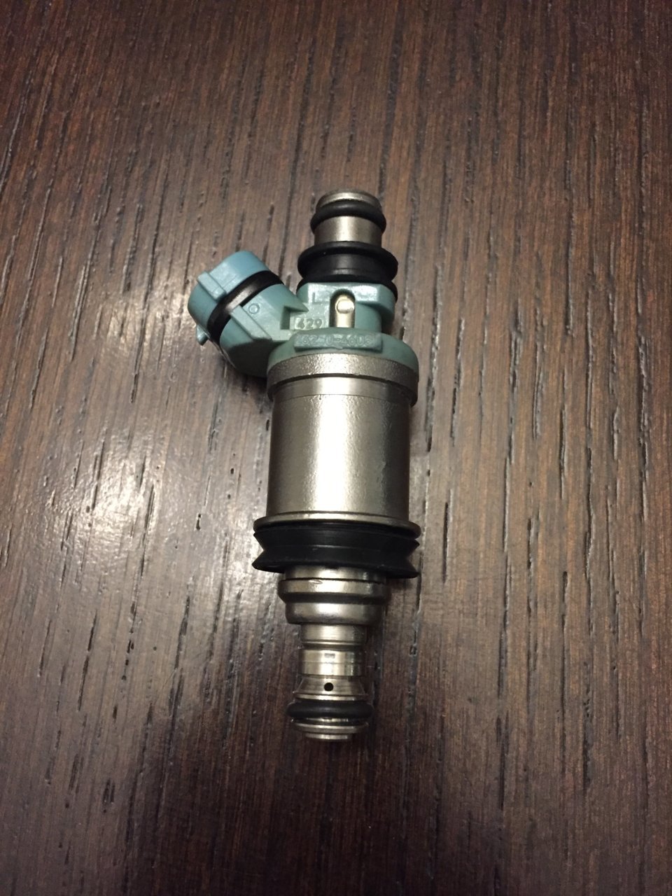

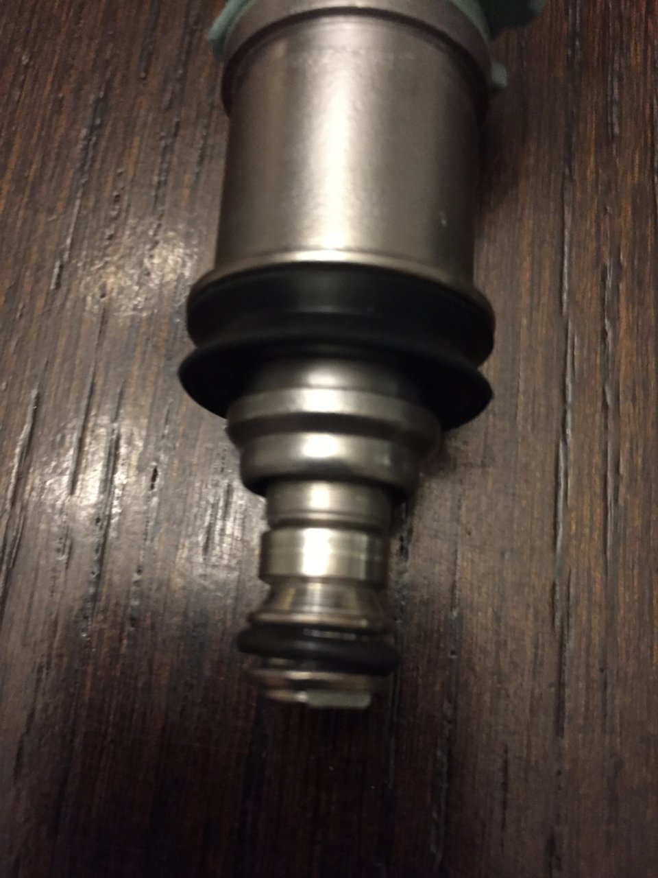

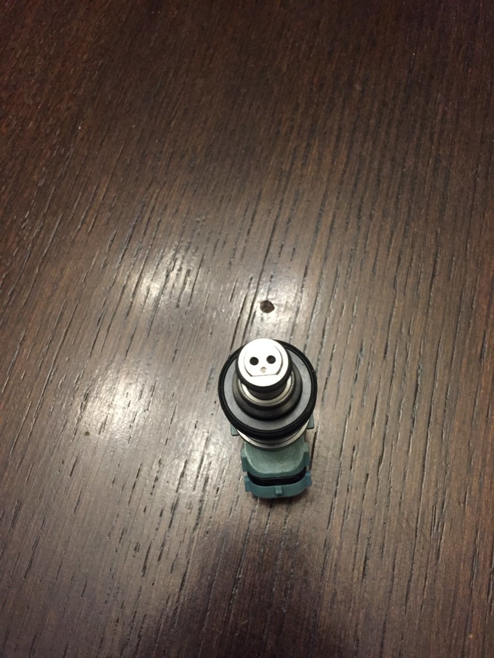

    CC473104-8360-47B8-97AD-FB19D33B90BE.jpg 3DDB3A5B-68C9-41B8-B5DD-37597F49A005.jpg Just picked up some Supra remans
    Says Denso on one side
    Hopefully they are real

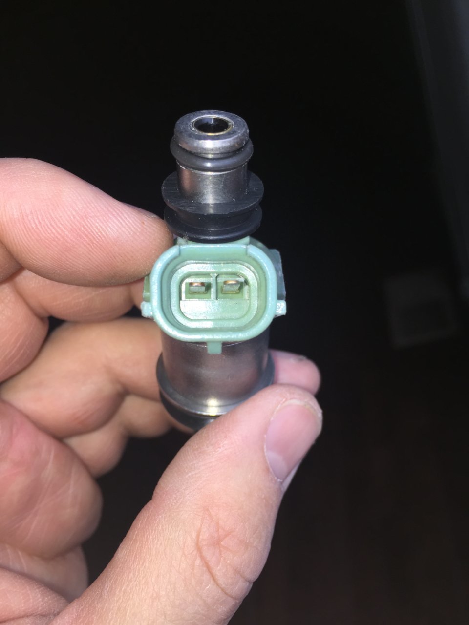

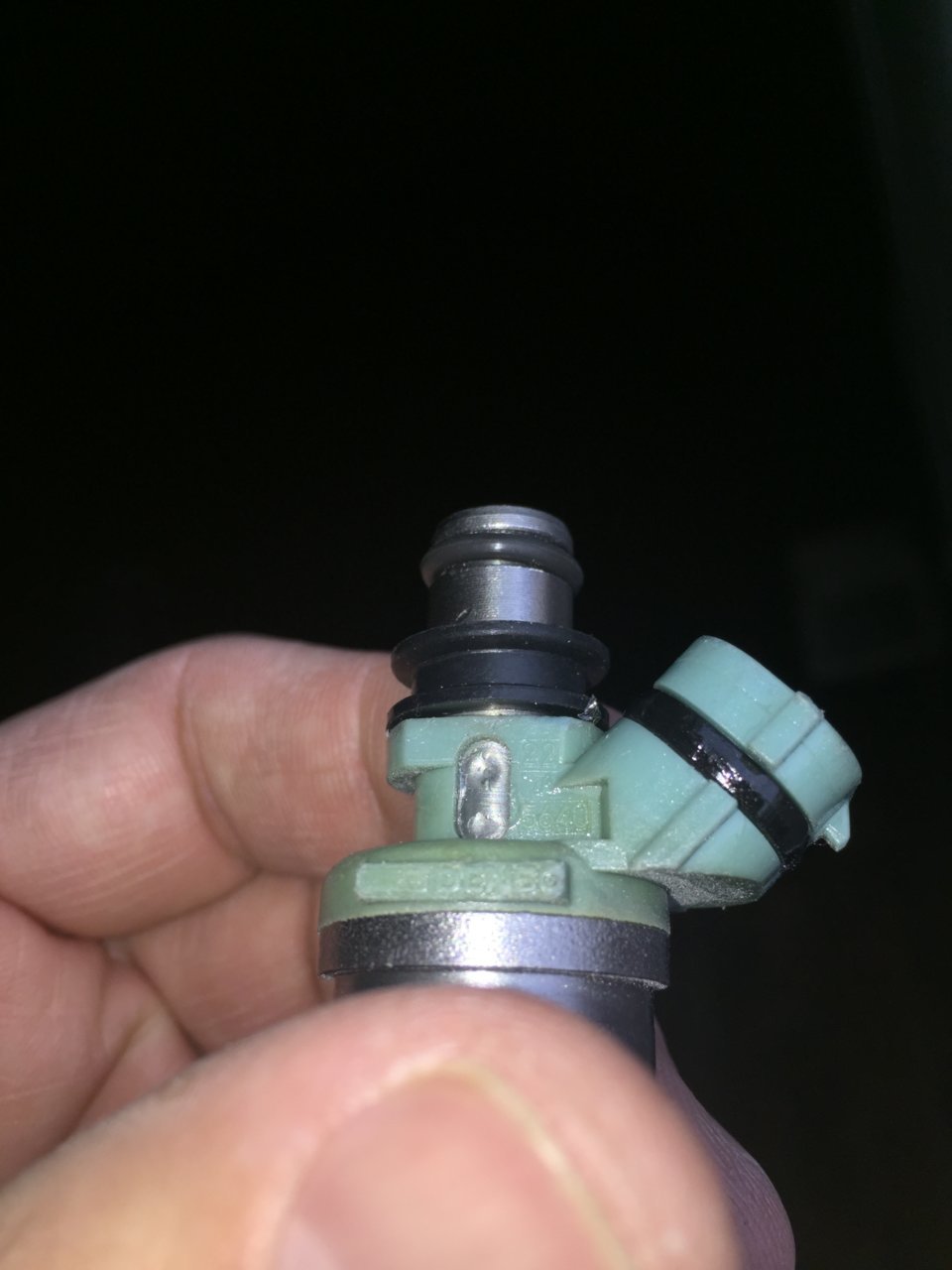

    What does the lower part look like? I thought only the Is300 injector was a plug and play.
    Idk what year your truck is, but mine is 96. I switched to the 440cc trd Is300 and they idle smoother than my stock injectors. I think since they are newer and probably better technology like lighter solenoids. 20191018_134547.jpg

    Where'd you order them from? Lot of fake injectors floating around online, especially on ebay. In fact I think every ebay fuel injector story I've heard had turned out to be a bad one.
    Scary part is how good the fakes look these days too...not trying to worry you, unless you got them from ebay lol

    The lower 2 O-rings look farther apart than mine posted above. Hopefully the intake manifold injector bore is machined deep enough. If others use these, then no problem.
