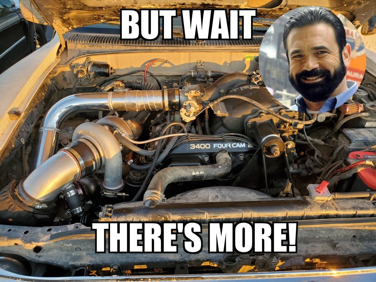

    Yes, I currently have the truck twin charged.

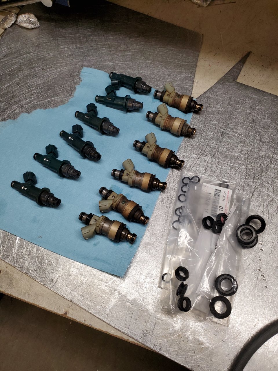

    In case you want these
    @BlackPearl provided me confirmation that they fit.
