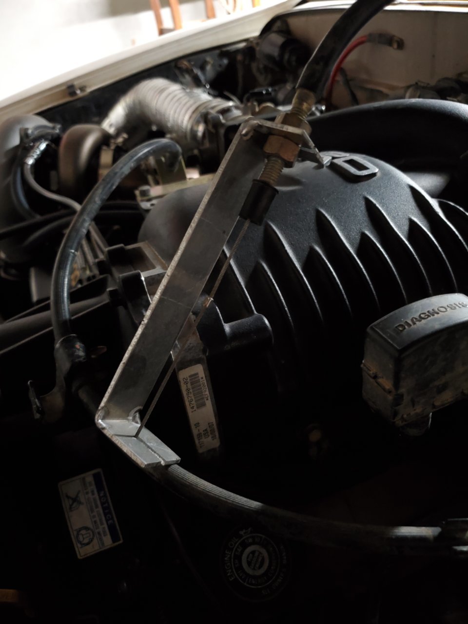

    Yeah you know the kick down cable? I made a bracket that keeps it pulled all the time. That's why its usually on the throttle pulley, so the shift is soft when just driving, but firmer when you are full throttle.

    Got pictures of the bracket?

    Not really, I can take some later.
    It's just angle stock with 2 little plates on either end tho

    Based off your picture
    Looks like you dropped the cruise control too.

    A little different than I remember, not angle stock after all.
    You should try it and let us know the differences.

    No problem. I cant remember where, just seen something about line pressure along the way and made this. Seems like the transmission is holding it.

    Line pressure is what holds the clutches together. Since we are boosted and making more power lower in the rpm range with less throttle input, the trans has no idea what's coming in to it other than throttle kick down position. So if we were stock, you dont need as much pressure to hold the clutches, only at wide open throttle. So the factory put the kick down cable on the throttle to adjust line pressure, softer at lower throttle input, firmer at Wot. If it's always firm, the shifts jolt a little more, I feel it the most clicking OD off and on.
    One down side is potentially shocking the driveline harder. The U joints will take a little more beating.
