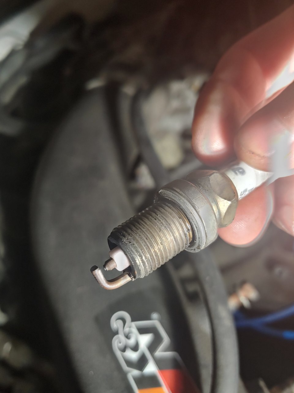

    Still trying to diagnose my low, rough idle and rich conditions. Like i said the truck runs super well, feels smooth and has power, except for the idle. No code and recently passed California smog inspection
    Also, I need to track fuel consumption but I haven't been through my first tank of gas in this thing yet
    Added some metrics to the list as well as including data/setup from previous post so u guys dont have to find it on previous pages (i guess i should just put the setup in my signature)
    *EDIT*
    I drove it again a little longer, lots of hills and such, coolant temps eventually got to 85C (185F) and the trims leaned out a bit, still rich but better
    2.2 pulley
    URD 7th injector
    Walbro 190
    (a suspiciously quiet one, but i have the receipts from prev prev owner)
    K&N intake pipe
    stock exhaust
    24 heat range spark plugs (pulled 1 for a pic below, looks happy but slightly wet threads. Doing VCG and other gaskets soon)
    Idle - at idle its really rich
    short term fuel trim = 0 to -4.8 update -2 to +7 when engine warms up better
    long term fuel trim = -16.4 Gonna try cleaning the MAF/Throttle body/IAC valve update -10 to -12 when engine warms up better
    Coolant temp = 80C (176F) update 85C(185F)
    Intake Air Temp = 29C (84F)
    MAF = 4 to 6g/s (mostly under 5, was going to clean and re-read but i need to drill out the screw or something, i'll get back to this today)
    O2 sensor 1 = .59 to .67 quick wave pattern
    O2 sensor 2 = .005 to .060 slower wave pattern
    Throttle position = 9%. Shouldn't this be 1% or less? Don't have high idle tho (did more reading, i guess this is also close to normal for this truck)
    RPM = 675 (did more reading, i guess this is close to normal of 700)
    Partial Throttle - cruisin around town
    short term fuel trim -1 to -5 with occasional spikes to 3
    long term fuel trim -4 to -8
    Wide Open Throttle
    short term fuel trim 0
    long term fuel trim 5.5
    Here's a spark plug I pulled, AutoLite 5224 which is supposedly has a 24 heat range

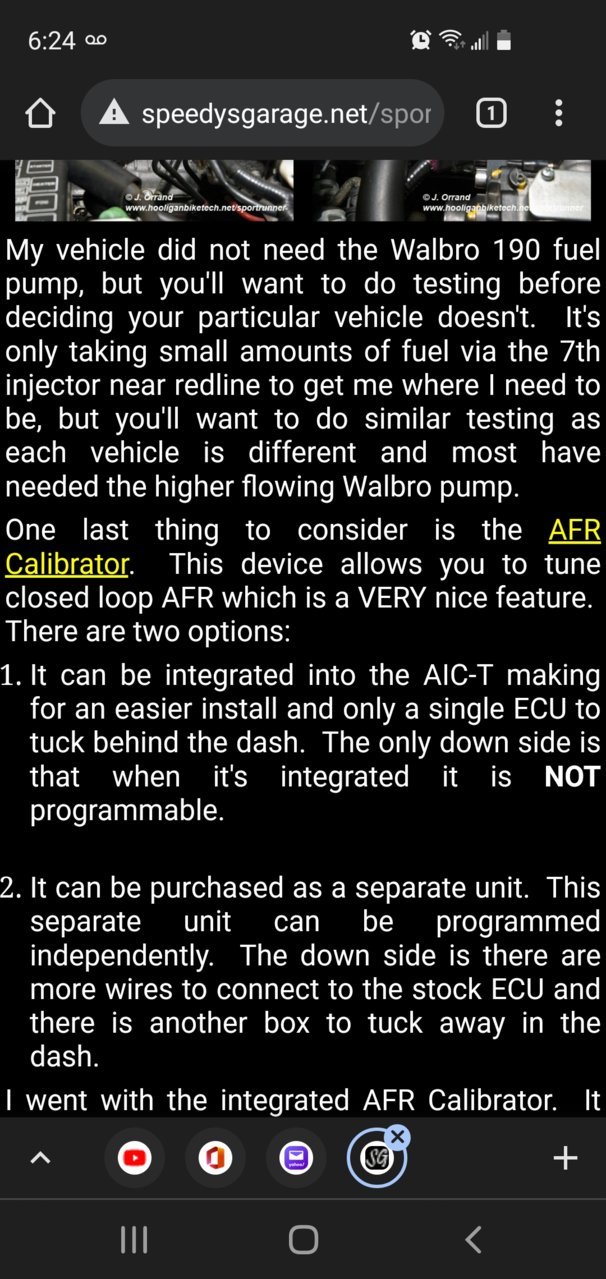

    The AFR/o2 circuit you guys are discussing is NOT user programmable on the 7th injector.
    from URD it’s set to start enriching closed loop at 3psi down to 13.5AFR until it hits open loop. (this is why I don’t like the 7th)
    You CAN change the point at which it turns on in the R4. I can’t tell you exactly what tab it’s under but it’s in the “options” area.

    I do have the AIC/Timing Calibrator installed, and I do see 13.5 AFR when I'm driving in closed loop so I am guessing that is where that number comes from, thank you for pointing that out!
    I've looked at the vehicle specific wiring diagram I was given from URD and used to install the AIC/T. Attached below. That wire is connected. I will take another look in R4 software to see if there are parameters there which can be changed. However I don't see how this will correct he -18% LTFT value I am seeing during idle.
