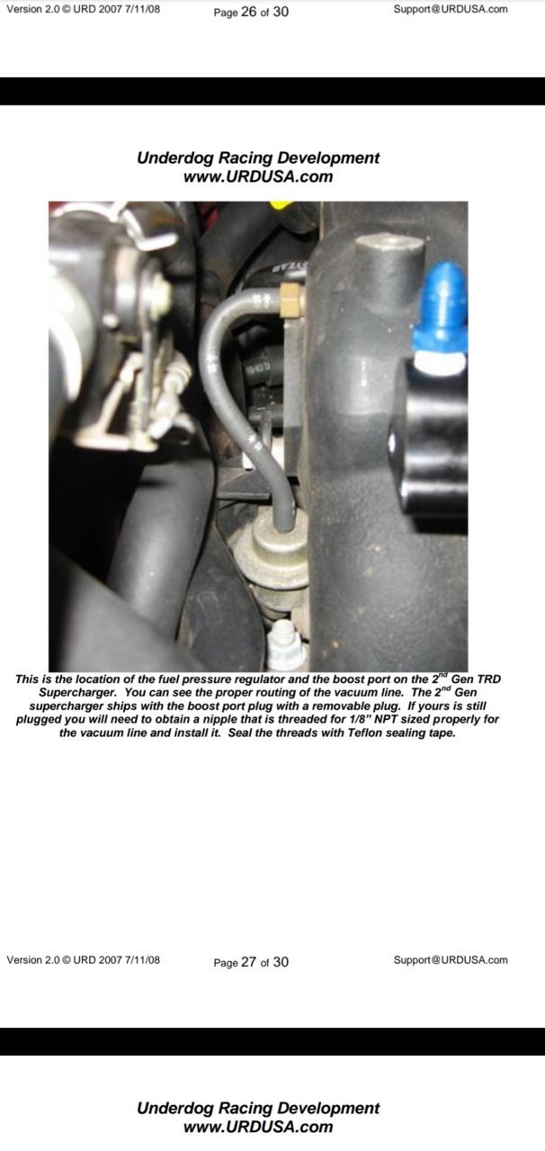

    @jevey1 how is your fuel regulator hooked up?

    Mine is installed as per the attached picture. The small line from the Tee goes to the AIC/T and my boost gauge.

    Vacuum sounds a little high. Might have a leak in that line which sounds like it's both to the gauge and the FPR?

    Are you referring to the line in the pictures above? Do you know what a good range for the vacuum pressure is at idle? What would be considered too high or low?

    And to be more clear.. I'm suggesting the higher pressure in that line could be affecting the FPR and leading to an increase in fuel rail pressure at idle.
